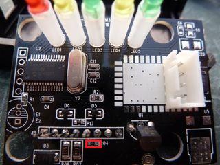

Hello Eddy and others,
I'm new here and I have a problem with the elm327 1.5. I have a Fiat Ducato 250 (2008). The only thing I can read with the ELM327 is Motor. ABS and Electric steering.
All others as below:
Airbag connection failed
gear-box connection failed
dashboard connection failed
boby: connection failed all cables
service: connection failed
I've tried every cable (yellow, green and red)
Hereby a picture of my circuit board. Mayby a have to do a modification. Thanks in advance.
Regards
Coen

Posted: 15 Jul 2013, 05:24
Hi Coen
Remove the red marked resistor and you'll have the other controls can also read

Posted: 15 Jul 2013, 09:13
by Scarab
HI, I have more photos, raising the connector and I noticed that there is r4 (edged in yellow) I have to remove?
THANKS
p.s. can recommend some useful software for each type of machine?
Posted: 15 Jul 2013, 22:06
Hello Scarab
STOP :shock: :shock: :shock:
Do not remove this yellow marked resistor
This is wrong, otherwise your interface is broken!!!!
