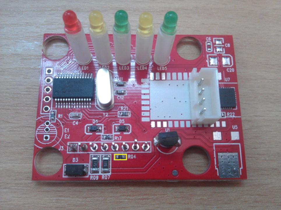

Hello Skorchichko
Remove the highlighted in yellow frame resistor (R04)
and your interface can also read the other controllers

by sgorchichko
Alfaeddy wrote:Hello Skorchichko
Thanks a lot, Eddy. I will try tomorrow and let you know the results!

Should I totally remove the resistor without putting any connection between these pins?

sgorchichko wrote: Should I totally remove the resistor without putting any connection between these pins?
YES. Just remove the resistor and do not put anything back in its place.

Awesome, it works. I've just cleared the service interval!
Thanks to all of you!!!
