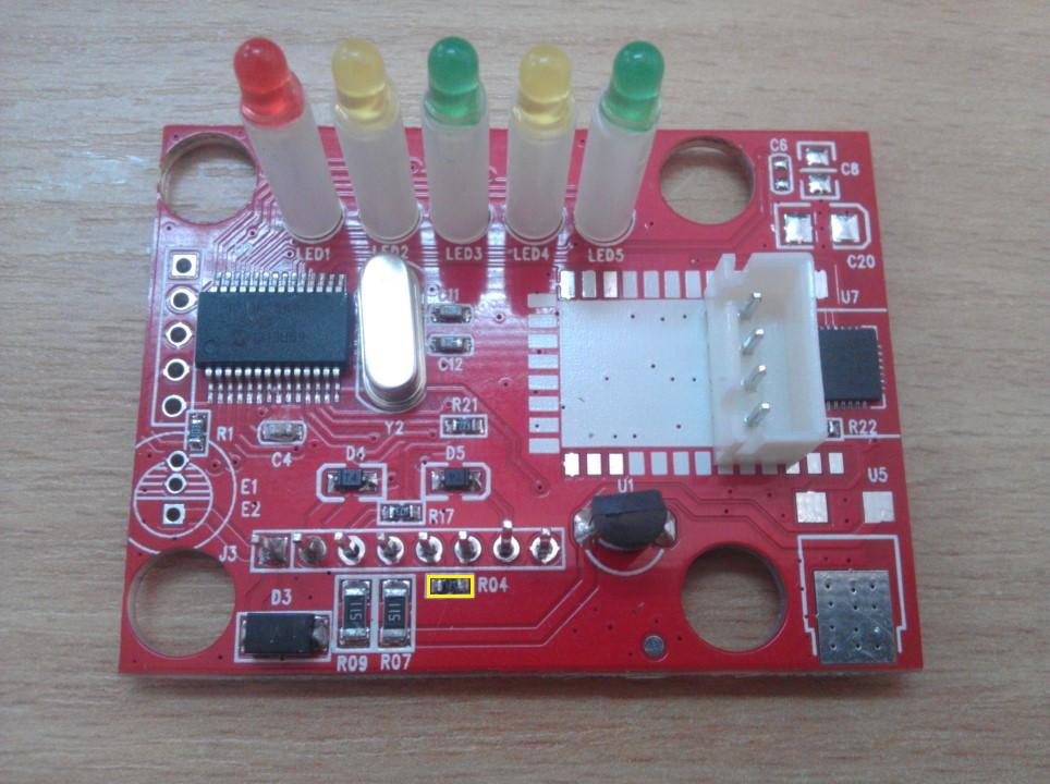

Hello Skorchichko
Remove the highlighted in yellow frame resistor (R04)
and your interface can also read the other controllers

Alfaeddy wrote:Hello Skorchichko
Thanks a lot, Eddy. I will try tomorrow and let you know the results!
Edit: I meant, of course with other controllers CAN Bus controllers
Should I totally remove the resistor without putting any connection between these pins?

sgorchichko wrote: Should I totally remove the resistor without putting any connection between these pins?
YES. Just remove the resistor and do not put anything back in its place.
sgorchichko
Joined: 27 Jun 2013, 07:17
Post by sgorchichko »
Awesome, it works. I've just cleared the service interval!
Thanks to all of you!!!

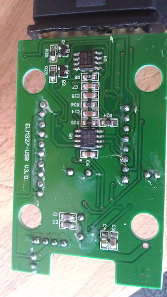

I have this elm327-usb v3.0 there is some modification to be done to connect to the CAN?
I attach images of the elm327
thanks for the help

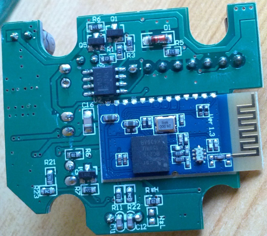

Ziyan
Joined: 10 Jul 2013, 13:44
Post by Ziyan »
I have this problem too, I would appreciate some help :)
