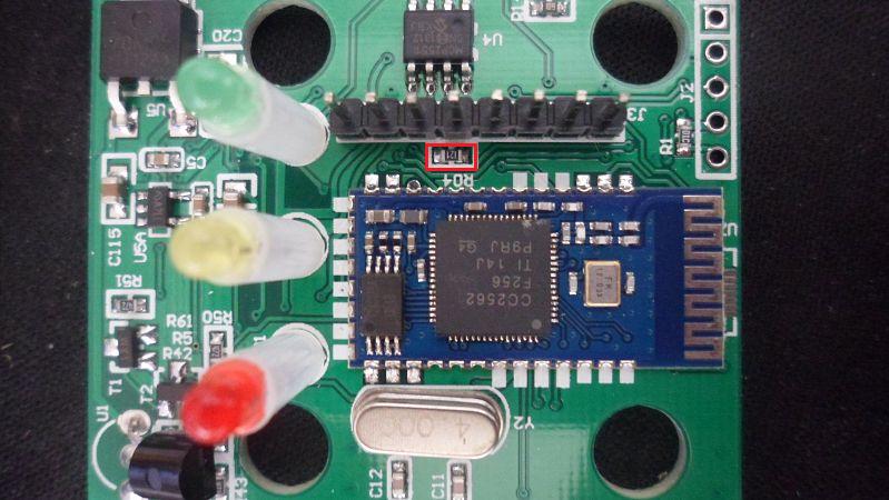

I have 2003 Fiat Stilo 3 D...I bought ELM -327 (bluetooth) for my car...I can't use OBD..Bluetooht ok but I can't data read...
This is the picture...
Thanx...
Posted: 15 Jun 2013, 16:20
Hello Stilo TR
Remove the red marked Resitor an your BT ELM Interface can read
CAN Bus with MES
GcMbX markiert.jpg (66.91 KiB) Viewed 9987 times

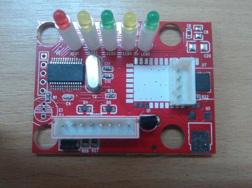

Hi guys,
Can you help me and tell me what to cut off on my ELM 237 v1.5a which I have recently received from China.
Here are photos of my cable.
The cable is connecting to engine ok but I can't reset service interval. There is no such item in the Adjustments tab.
Posted: 27 Jun 2013, 09:27
Hello Skorchichko
I can not see what is under the white plastic.
Please remove this or make pictures in which this can be seen.
2013-06-27 10.26.17 (Custom) (2) markiert.jpg (145.93 KiB) Viewed 9899 times

Alfaeddy wrote:Hello Skorchichko
Here you go!
