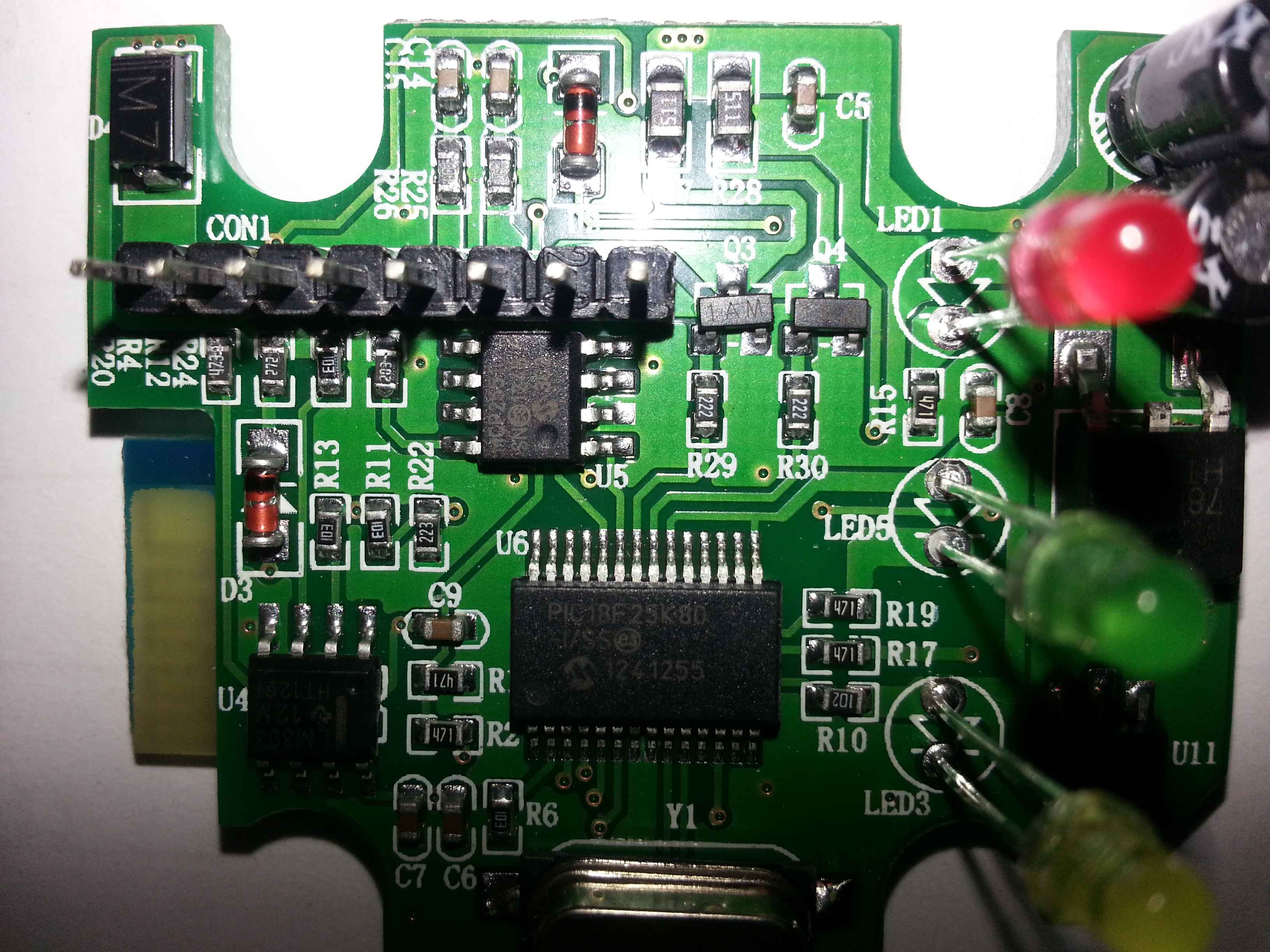

I have 2003 Fiat Stilo 3 D...I bought ELM -327 (bluetooth) for my car...I can't use OBD..Bluetooht ok but I can't data read...
This is the picture...
Thanx...
Hello Stilo TR
Remove the red marked Resitor an your BT ELM Interface can read
CAN Bus with MES

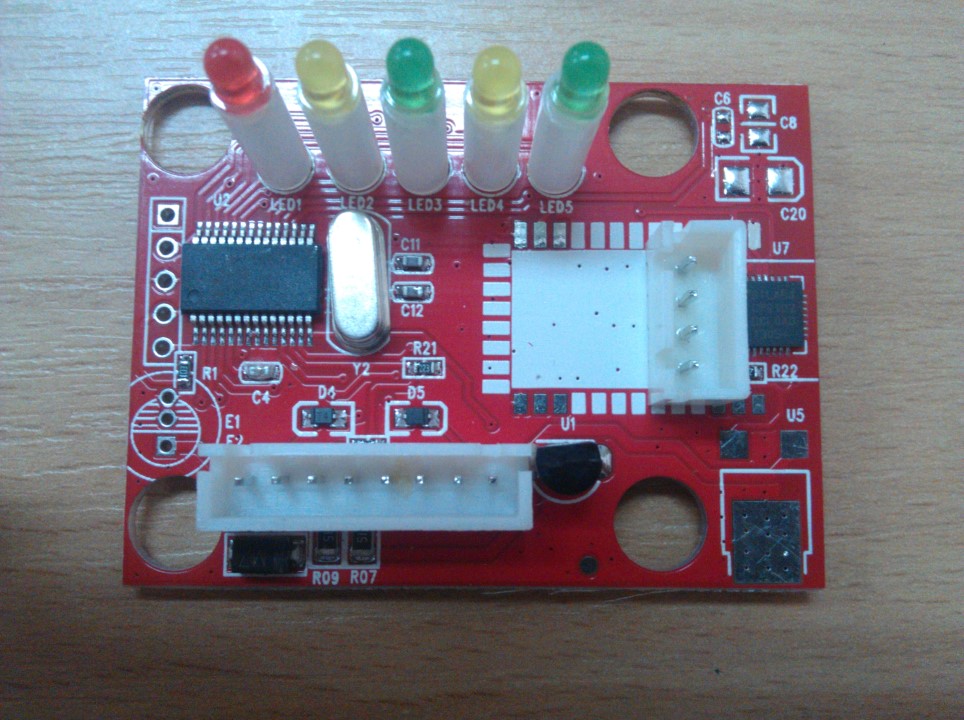

Hello Eddy . Greetings From Belarus...
I have 2007 Fiat Bravo . I bought ELM -327 (bluetooth) for my car...I can't use OBD..Bluetooht ok but I can't data read...
This is the picture... Sorry . I do not know English .
Hello Kosalepet
Thanks for the greetings :P
Your ELM interface has no disturbing resistor
it must work
check your
- Drivers
- Com port
- settings
IT must work

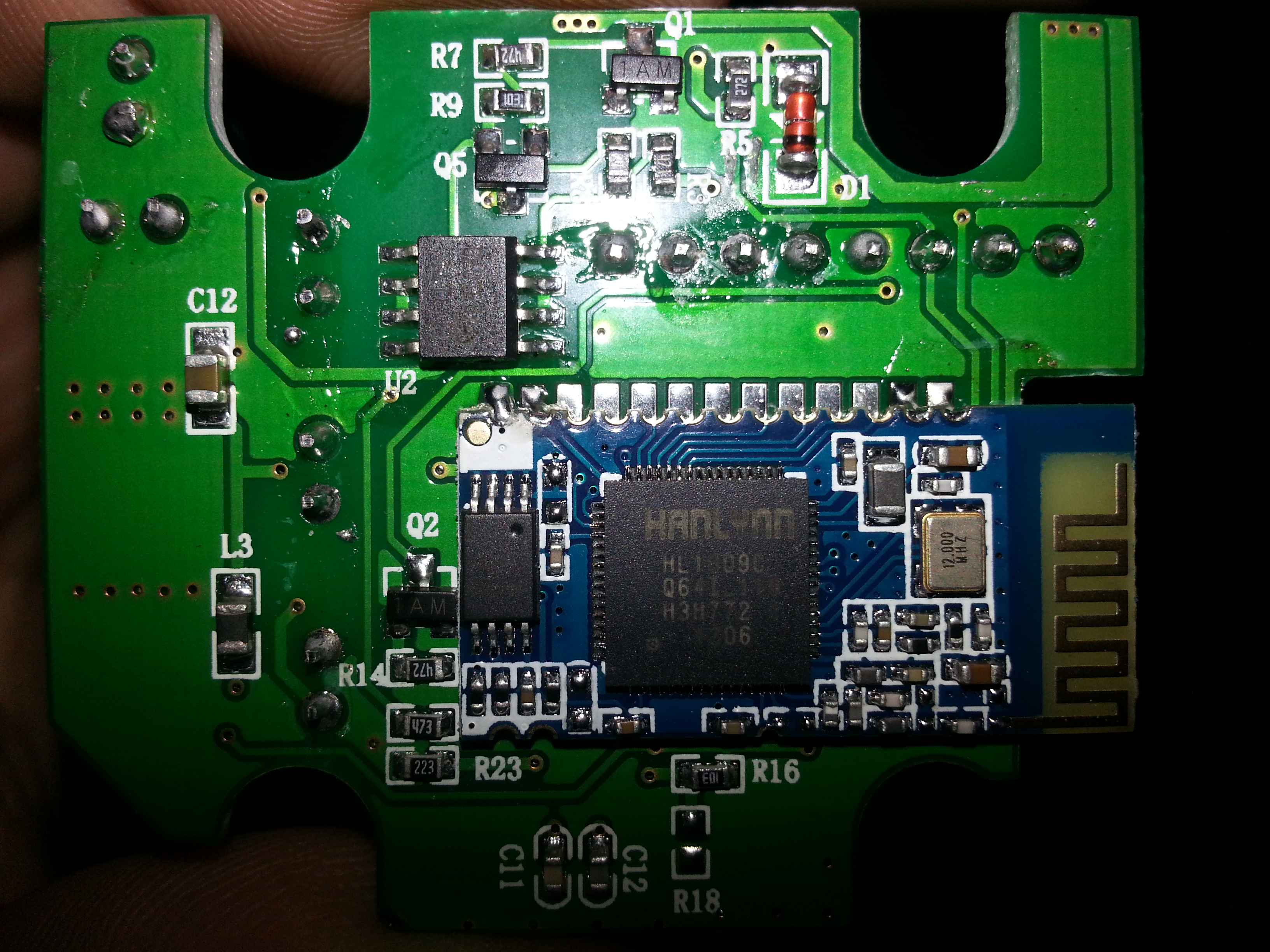

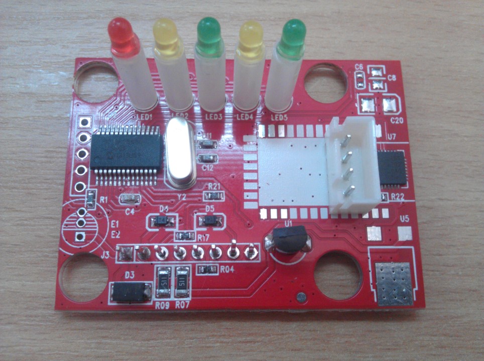

Can you help me and tell me what to cut off on my ELM 237 v1.5a which I have recently received from China.
Here are photos of my cable.
The cable is connecting to engine ok but I can't reset service interval. There is no such item in the Adjustments tab.

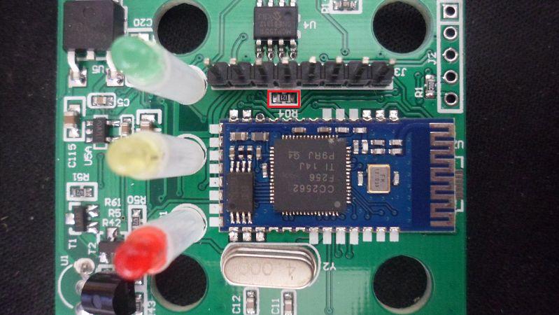

Hello Skorchichko
I can not see what is under the white plastic.
Please remove this or make pictures in which this can be seen.
2013-06-27 10.26.17 (Custom) (2) markiert.jpg (145.93 KiB) Viewed 9886 times

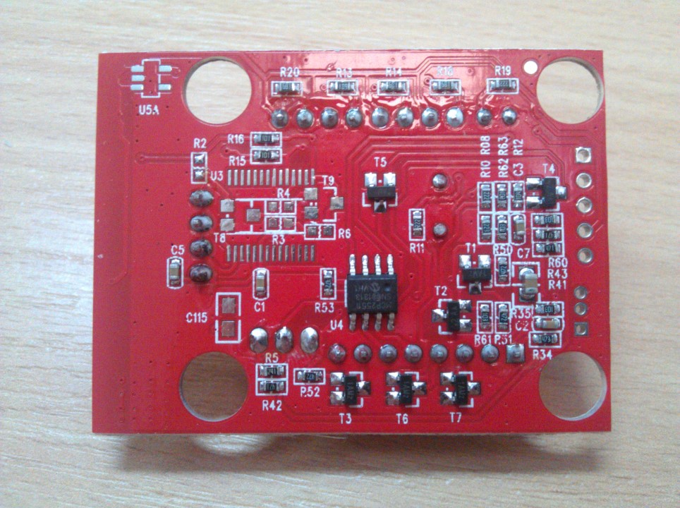

sgorchichko
Joined: 27 Jun 2013, 07:17
Post by sgorchichko »
Alfaeddy wrote:Hello Skorchichko
Here you go!
