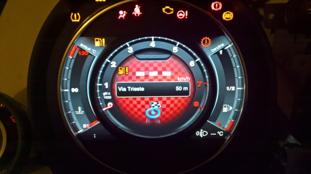

Hi Alex,
Can you post or PM a screenshot of your Custom Proxy data for the TFT graphics in your picture below please?
Grazie :D
alex-et3
Posts: 199
Joined: 19 Apr 2017, 22:42
Location: ROVIGO - Italy
Re: Missing menus from TFT display - Abarth 500
Post by alex-et3 »
snowbound_sonic wrote:Hi Alex,
Grazie :D
Of course!
I send you the 500 Abarth proxy code in which your tft was mounted!
Fiat 500 Abarth Restyling:
33 32 31 35 30 30 31 39 31 39 30 4F 55 54 50 55 54 44 4A 49 54 20 16 06 06 4F 80 00 04 10 00 00 00 09 00 00 04 10 00 00 00 91 C2 77 06 FE 00 1C C0 00 00 00 26 00 01 00 94 06 01 01 00 40 00 00 20 75 41 0A 0C 0D 01 80 2E 24 00 00 00 00 31 02 51 00 00 00 04 00 00 00 00 00 00 00 00 00 00 00 00 00 00 00 00 00 00 00 00 00 05 00 94 08 52 00 04 88 02 00 20 80 00 00 40 00 85 00 0F 00 00 00 80 05 00 C0 02 00 00 00 00 00 00 00 00 00 00 00 00 00 00 00 00 00 00 00 00 00 00 00 00
Let me know if you find the byte to configure the new tft graphics.
