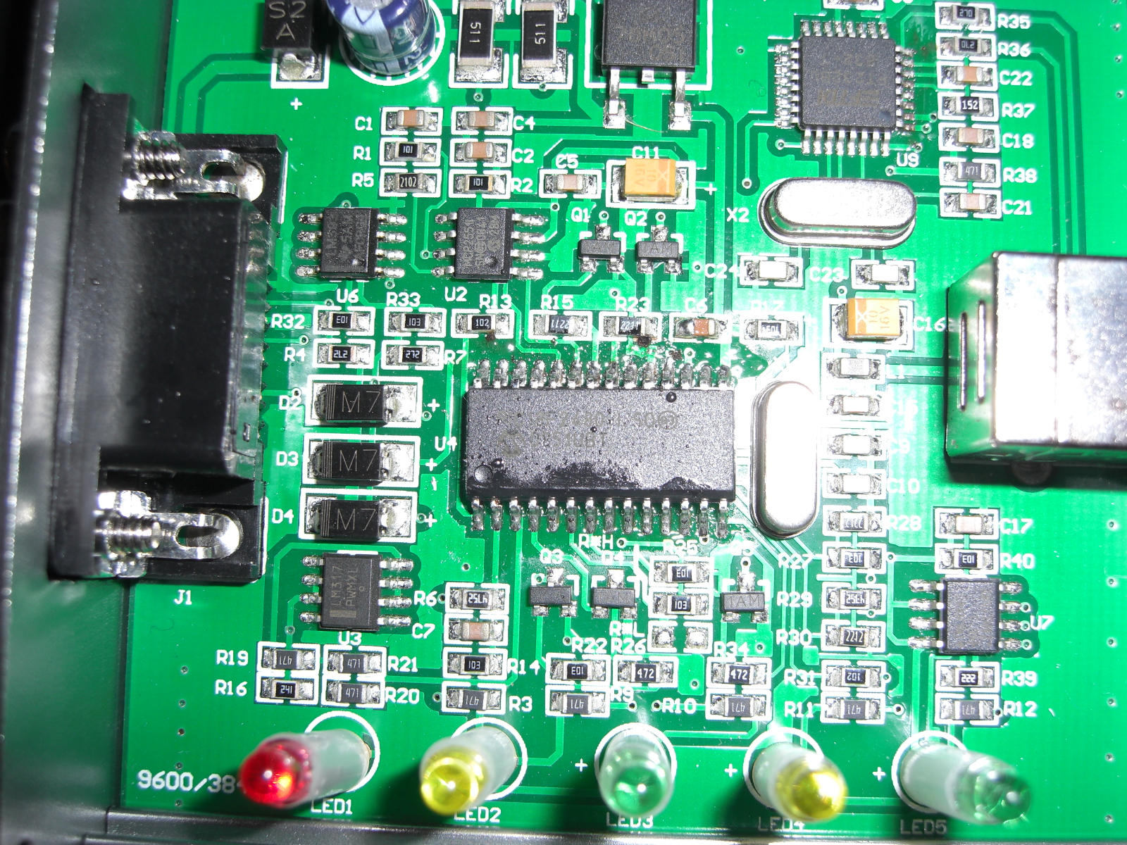

sprint750 wrote:Hello,
Another cheap 'Chinese clone', from eBay (UK seller, not china or HK), received 3 days ago.
It was sold as ELM 327 1.4 'with a genuine ELM chip'. :?
(For my personal information, I would really like to recognize a genuine ELM chip from a fake one)
Actually everything is working well FES wise, which makes me think it is actually an genuine ELM1.4
- NO communication problems, all ECU are recognized.(Airbag and steering not tested, pins 1-7-9 not soldered yet)
- NO problem to get access to service reset.
- NO installation problem. Just the drivers for FTDI USB to install.
On the last pic we can see the 100 Ohm resistors (R25/R26) for CAN H/L lines with associated capacitor (C14/C15)
Same combo shown by members in the last posts.
Hope it can help you to find the correct interface
I have the same interface, but it doesn't work. I was removed R25, R26 and C14, C15 and it still doesn't work :/ What should I do with this interface to work properly?

i have the same problem as you guys that i cant connect to any can device like Fiat 500 or grande punto with my elm 327 1.5 a like the one in the pic below. is there any solution about that ? my pbc have the R 100 ohm and cap 506 but i cant comunicate with body or service reset on dash board 500. any advice will be really apreciated... thank you all

Mazza-Engineering
Posts: 10
Joined: 03 May 2011, 18:33
Post by Mazza-Engineering »
yincar wrote:Hi Yani and all,
My bad interface looks like this. Not sure which version it is. So, do i need to remove R14 and solder 100 ohm resistor and 560pf capacitor like what 1st post did to cure CAN issue?
yincar
download/file.php?id=293
download/file.php?id=294
Hello to all,
have same PCB like yincar.
Can I just desolder R14 without putting new resistor and capacitor(like Argo did, but with R04 in his PCB)?
