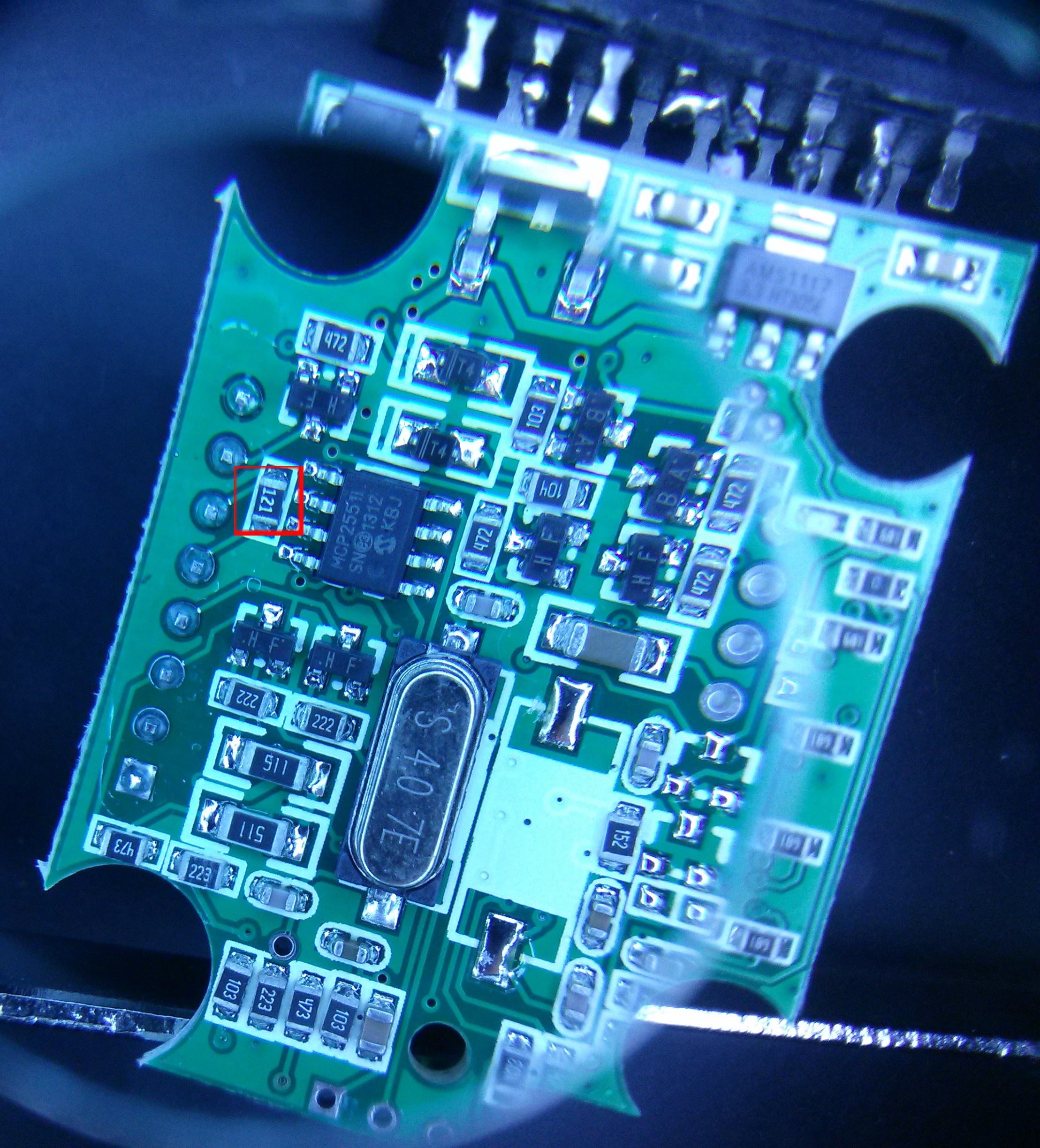

Posted: 01 Jun 2013, 00:59
by perlsite
Just to help the others:
I'm having Bluetooth elm 327, just like this one: Image
I had to remove the 120 ohm resistor (denoted in red):
To open the unit I had to remove the label and below the caption there are four screws to be unscrewed. Pretty clean and easy tweak.
Posted: 01 Jun 2013, 07:38
Hello Perlsite
Thanks for your help ;)
But this has already been described in this thread at least 100 times

I agree that the general fix with removing resistor is discuses 100 times or more, but I'm obliged to disagree, IMHO, that you can find easily *exactly* my ELM 327 clone (although it has the same outer look) and implement the fix blindly!
Actually I wasn't able to find my BT clone, here in this thread, just by looking at the pictures on each page from the first one to the last one. Maybe I missed the solution, but actually I had to search the ELM/PIC application note mentioned in the first post and actually review the datasheet and verify where the CAN+/- are and what are the actual requirements.
It will be fair if someone (probably the moderator) summarize the solution for all the different ELM 327 clones available on the market in a single post and then you can criticize if someone duplicate the effort and forget to read the first post. Personally for me it was frustrating not to find solution for my BT dongle.
Posted: 06 Jun 2013, 20:07
Hello Perlsite
You're right :)
I know your Board structure
For this reason I thought this would have been already described.
If no image is set for this interface still here, of course you have
Right with your post :)
