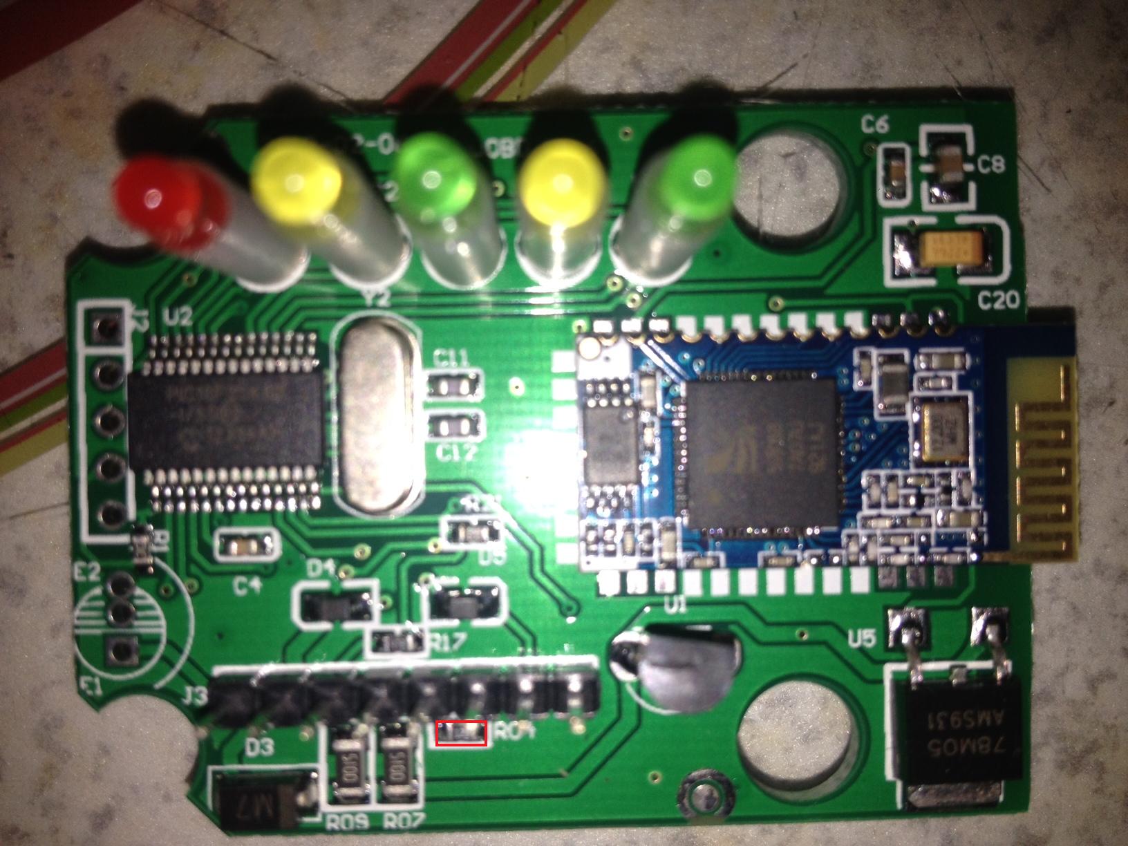

Posted: 23 May 2013, 11:20
by sasler
I just got an Chinese ELM 327. When I connect it to my Alfa 159 using the Green adapter, I can read the Engine fine. Even resetting the faults works. But when I try to connect to the Service using the Yellow adapter, I get a connection error. Using the green adapter, I can connect just fine to Service too, but when I try to execute the NEXT SERVICE KM RESET, the screen in the car briefly flashes off and it fails.
After reading this forum, I was wondering if I have a faulty ELM 327. I got this one:
http://www.ebay.co.uk/itm/MULTIECUSCAN- ... OC:US:3160
It says that:
Modified EML:
* Please note that this ELM 327 HAS been modified to resolve the connection problems reported on the home page of MultiECUScan / FiatECUScan
But now I'm not so sure. So here are some images of the board. Could someone please tell me if it's alright?
Thanks in advance :)
Posted: 23 May 2013, 17:06
Hello sasler
The yellow adapter is not for your vehicle
No adapter and it will work use :D

Posted: 23 May 2013, 21:42
Hello sasler
In any case, your interface does not have the problem described in this thread
So this resistor must be removed for other ELM Interface
is not available in your ELM
And the adapter you should not use the service read.
Otherwise, it may just be a setting error

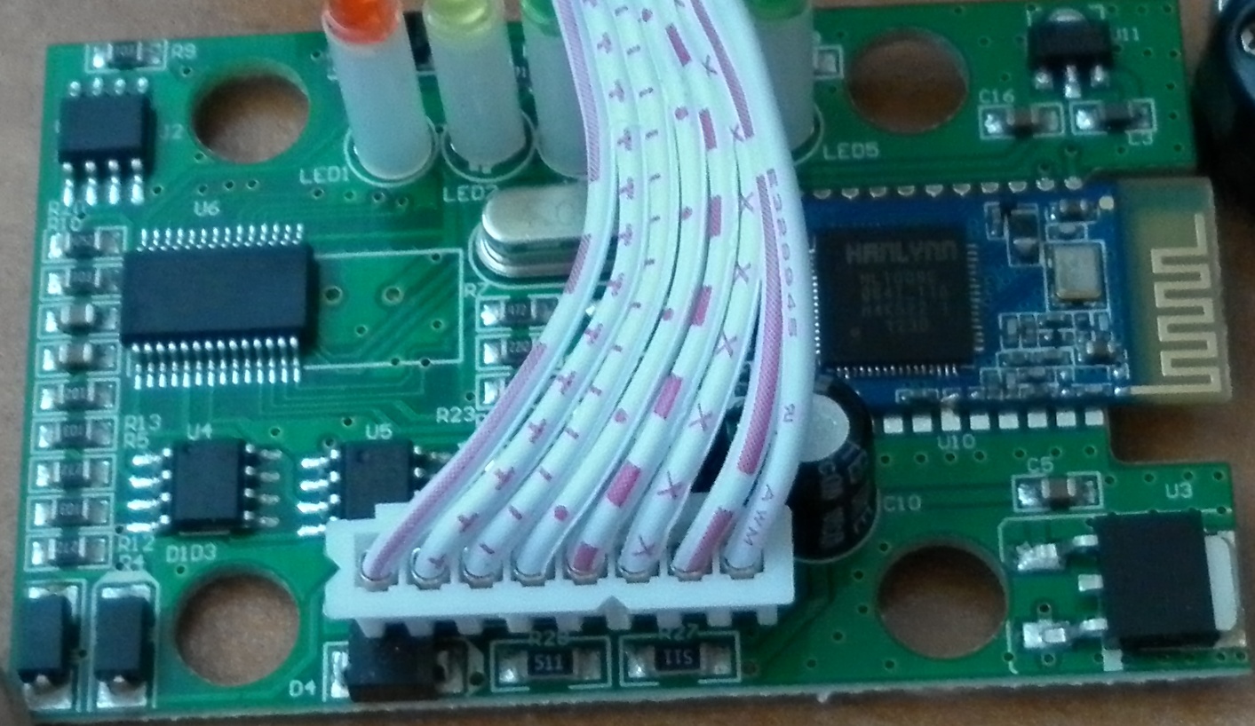

Posted: 27 May 2013, 23:15
by Hamirom
Can somebody help with this interface
Posted: 28 May 2013, 08:11
Hello Hamirom
Remove the red marked resistor
Since you do not write what vehicle and model you want to read
I guess times on a CAN bus error
Your picture is very blurry but just enough
photo3 markiert.jpg (236.08 KiB) Viewed 8409 times
