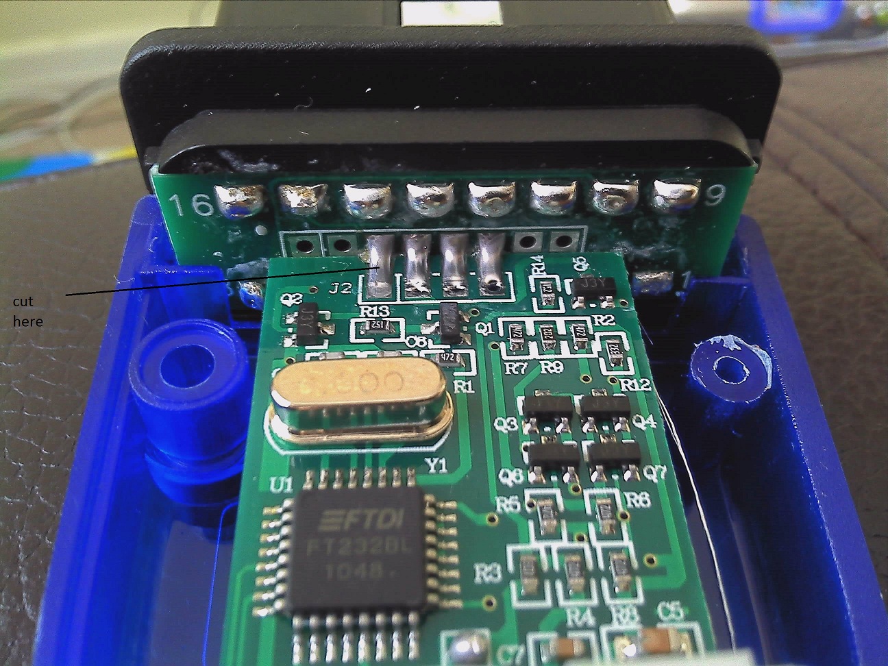

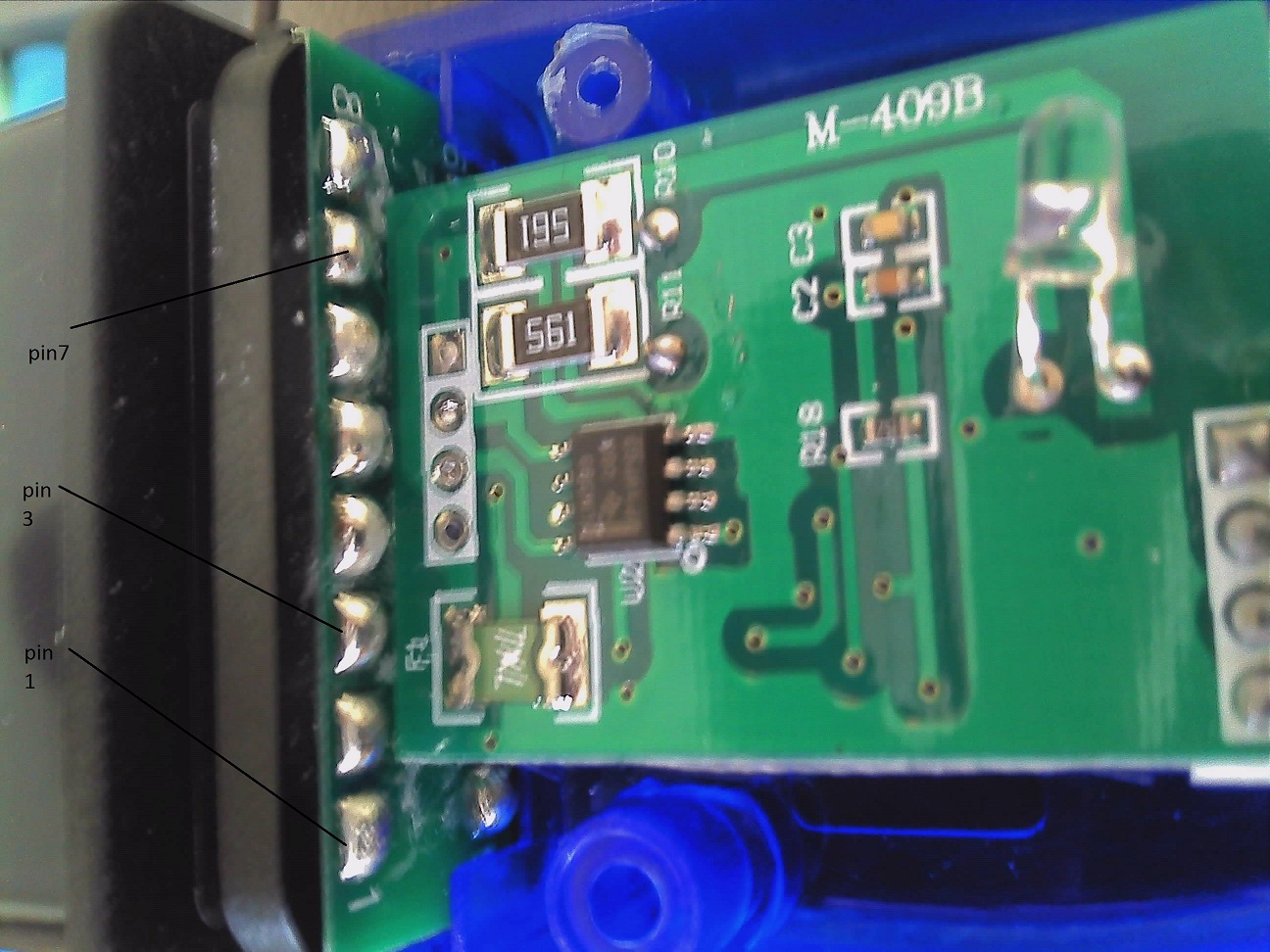

hi folks.. just bought a kkl cable of ebay.. which i need to modify to be able to connect to the airbag ecu on my 156 jtd m. dont have any soldering equipment/wires e.t.c. Any member local to kent that can give me a hand at this if possible?
i've opened it up and here are the pics
http://imageshack.us/photo/my-images/83 ... 23116.jpg/
http://imageshack.us/photo/my-images/84 ... 5edit.jpg/

can someone pls tell me what bits i need to solder.. tried to upload images but its comes up too large. here goes again

First of all you DO NOT NEED to cut wire at "J2" connector - PHOTO #2. Forget it!
You just need to put 2 switches:
(1st switch) between pin 7 and pins 1+9+12 (ABS, ELECTRIC POWER STEERING-SERVO, XENON LIGHTS)
(2nd switch) between pin 3 and pin 7 for AIRBAG!
And that is all!
