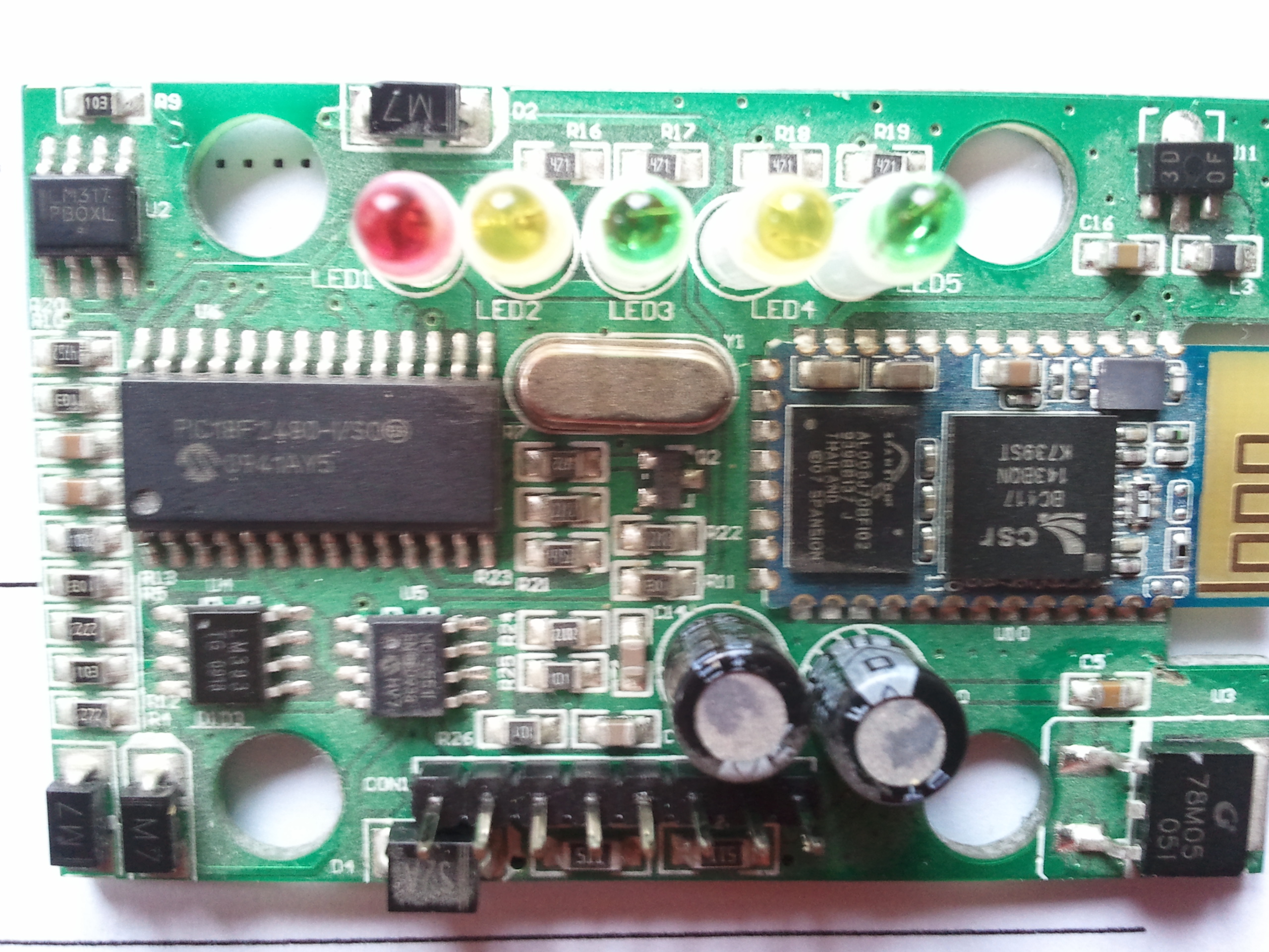

I have this elm interface. I cannot connect to can with my fiat doublo.i already make the pin changes (elm 19). It looks ok. Does it make sense to make yanis changes( r25 and r26) so maybe i can connect. Or is it possible to do the "dirty way " destroying r24.
Thanks for help in advance.

bbernie wrote:
Maybe your BT elm327 have old 1.2version and you canot connect to can line.Only if you change PIC with 1.3 or 1.4 version.
ELM327 v 1.4
