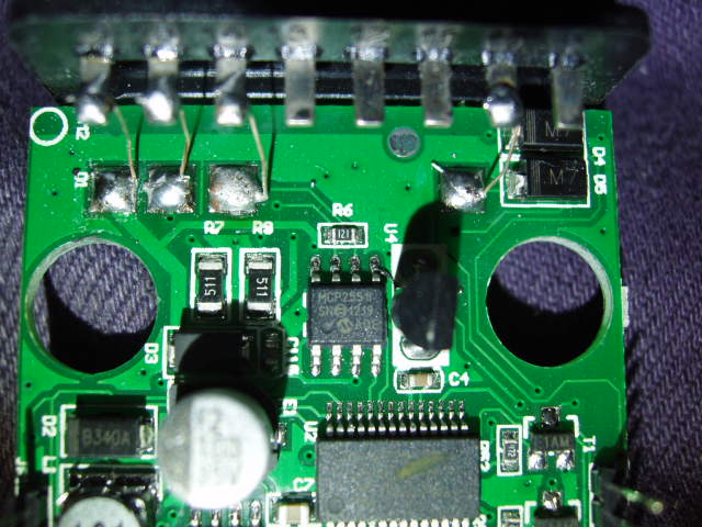

Yes I'm 95% sure, but doing is another picture of the part with 8 pins in addition to the resistor in the red frame
Here is the picture:
Hello Boris
This ist a nice picture :D
yes , remove R6 (121) and your Interface can read CAN Bus with Multiecuscan
Red frame in the last picture

Alfaeddy wrote:Hello Boris
I was playing with macro settings :-)
Alfaeddy wrote: yes , remove R6 (121) and your Interface can read CAN Bus with Multiecuscan
Works OK
Thanks!!!
