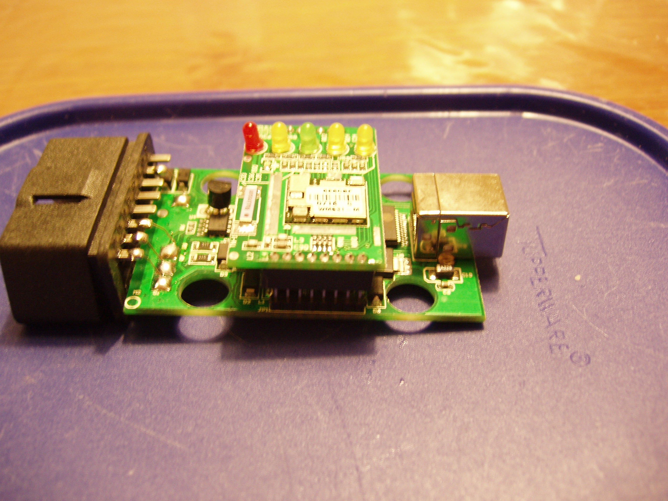

I have bought another interface (WiFi and USB combined, I already have Bluetooth and USB) and as predicted, CAN does not work.
Please can you help, what resistor to remove?

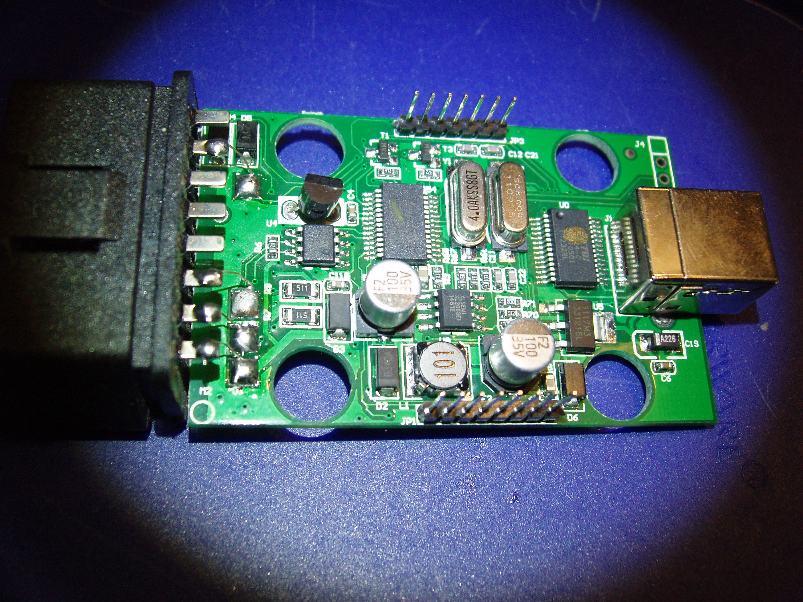

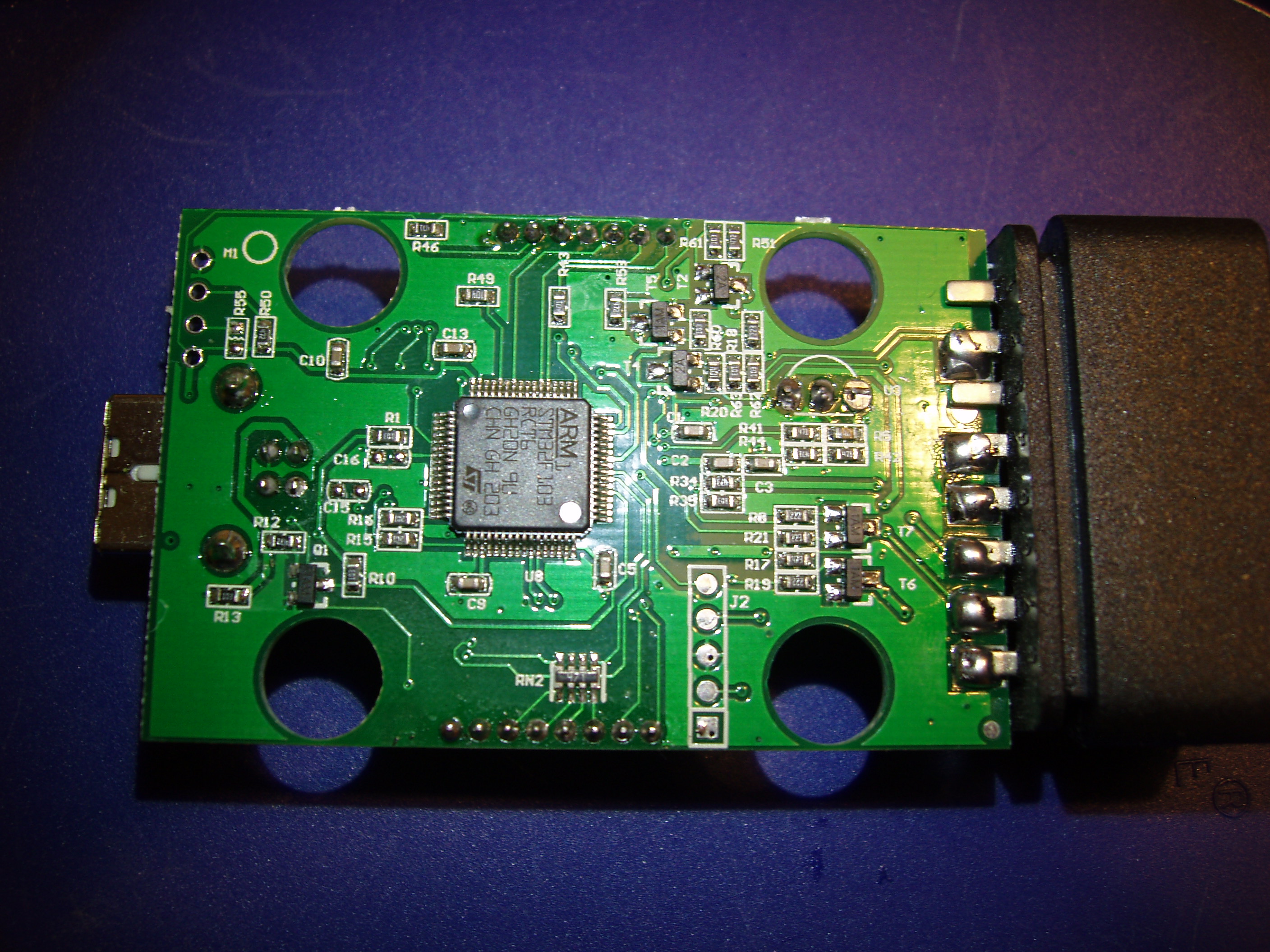

More pics:
Hello Boris
Great pictures but it's hard to read the label on the components
But if I am not mistaken you have to remove R6 (red Frame )

Are you sure, or I will take the picture again. Which picture/component you need to read?
Yes I'm 95% sure, but doing is another picture of the part with 8 pins in addition to the resistor in the red frame
