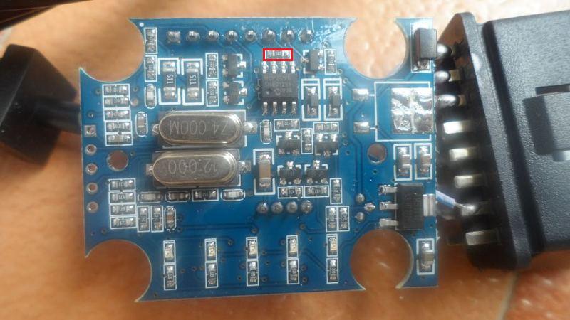

I bought un'elm327, and when I go to read, with Fiat ECU scan, the data of ABS and airbags, I find the error that can not be read on the K-line to pins 5 and 7 ....... it seems to me;
how can I change it, I'll post pictures:
Posted: 04 Apr 2013, 21:06
Hi Giuseppe
Do you remove the Resistor in the red Frame marked in your Picture
and your ELM Interface read now CAN Bus
52518130123513639238677 markiert.jpg (57.25 KiB) Viewed 7384 times
Gruß Eddy

Posted: 05 Apr 2013, 08:41
by Giuseppe
Alfaeddy wrote:Hi Giuseppe
Gruß Eddy
Thank you,
eliminating this resistance, therefore, can connect on CAN and on KKL?
We must not make any other changes to the pins?

Posted: 05 Apr 2013, 20:51
Hallo Giuseppe
You must remove an Resistor not the Resistance ;)
The KKL Interface can not work with CAN Bus
So at the KKL is also nothing to change
