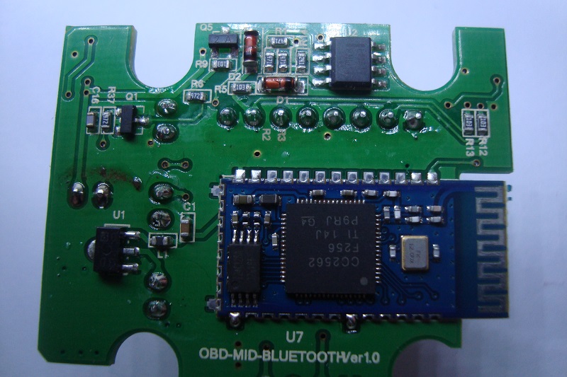

Yes, as you said the resistance r04 it connects the pins that you have said.
I have succeeded in removing the plastics even if I have made a small damage.
I add the photo of thing it is possible to see without the plastics
I thank a lot You for your help, tomorrow I remove the resistance and then I will make some tests, I will make you know the result of the tests.

Properly, remove the resistor R04 and your ELM interface can also read the CAN bus protocols
Your ECU and ABS (adapter) you could also read before that??

by ELIO65
Alfaeddy wrote:
can not read the number of the Chip in an red frame ?
I think your Problem ist not the ELM
Control your Setting / Interfaces Setting / Com port /
and you can read your ECU
For ABS / Airbag / usw. you need an yellow Adapter
The attachment IMG_20130325_095018a.png is no longer available

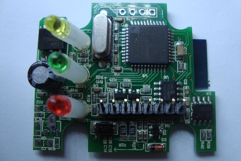

Hi Eddy, the Chip is MCP2551.
I control setting, interfaces setting, com port, but I can't connect with Multiecuscan.
The interface works fine with Torque and EasyObdII.
I made two new photos. I hope they are better.
Can you help me again?

Hi Elio65
How many of these different mid ELM 327 interface you've got? :lol:
viewtopic.php?f=5&t=1493&start=590
I see no errors on this board, but the pictures are not good
And I do not know this board
So I guess a setting mistake
