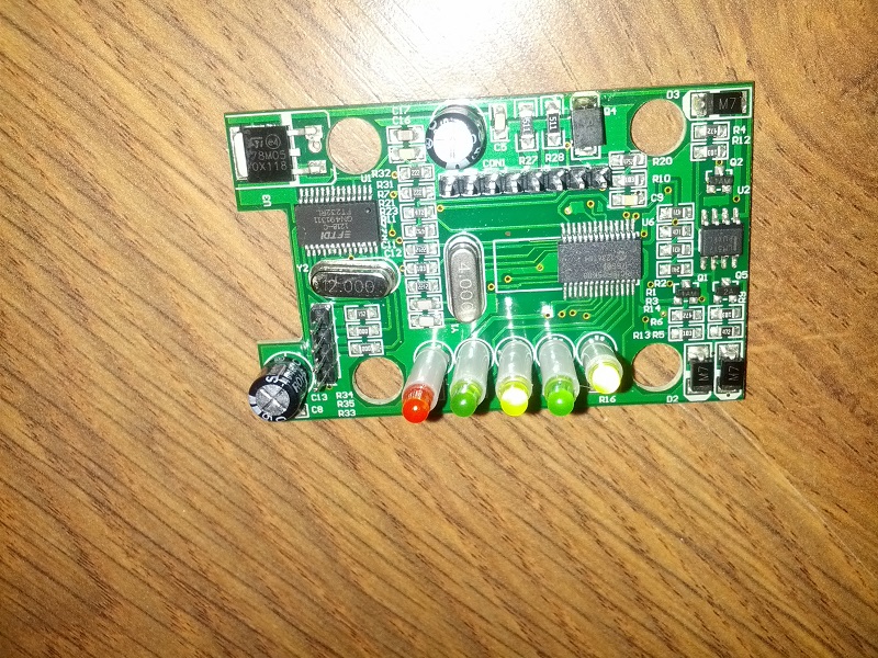

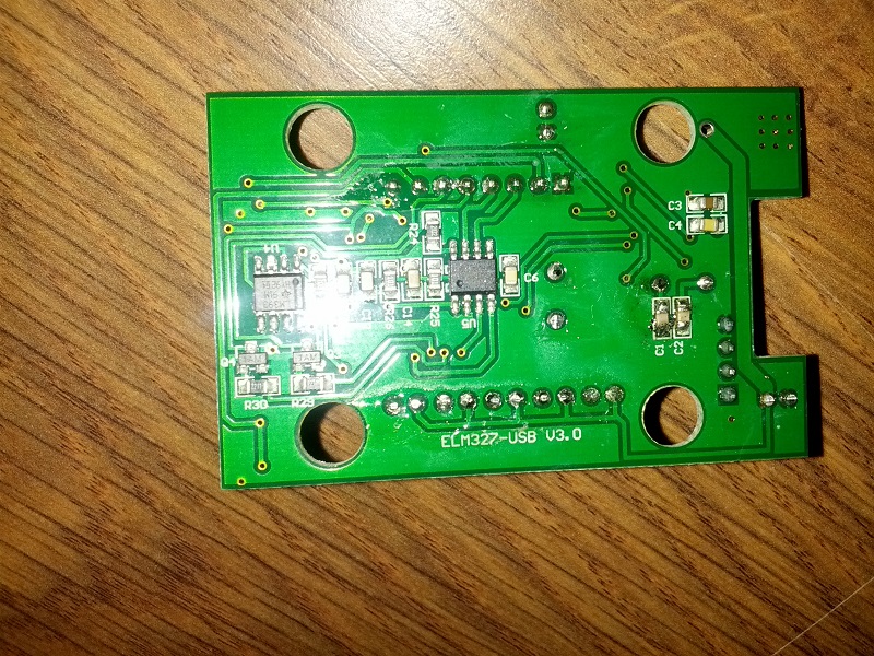

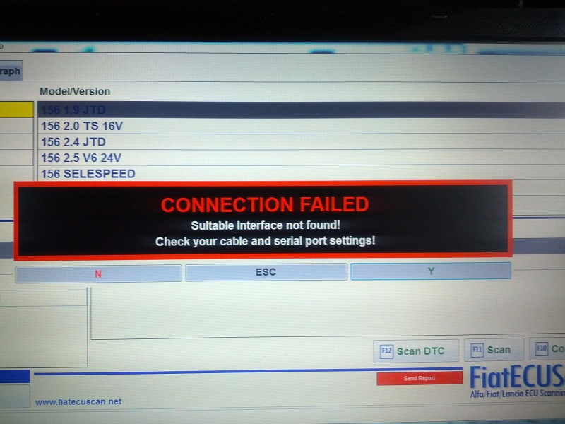

Hello,sorry my englisch is not so good.
I have a problem connecting to Alfa Romeo 156 1.9 JTD 1998 year
When i test port in multiecuscan i get all ok. But when i try to connect i get connection timed out or nonexistent port
Tell me what to do or to remove
Thanks in advance
This is my ELM327
Thanks in advance
This is my ELM327

Hello Vasil82
You can use your ELM interface Reassemble
The connection to the Alfa 156 has nothing to do with the errors described in this thread.
Your connection error has something to do with the settings.
Valid
- Beta drivers installed
- Latency Time set to 1? (Instead of 16)
- Correct interface set?
- Com port checked?
Valid
- Com port checked?

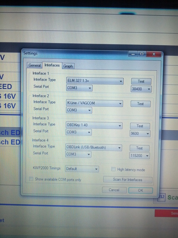

Hello Eddy
Latency is 1
I think that interface is correct ELM 327 1.3+
Here are a few photos and tell me where they be wrong
Latency is 1
- IMG_20130322_114532.jpg (185.1 KiB) Viewed 7457 times
- IMG_20130322_114508.jpg (140.17 KiB) Viewed 7457 times
Hello Vasil82
If you are the different interface all on the same com port (com3) may have problems logging in
Remove times the other interface or the com port for that and try again

This is the type of error that was described in this Multiecuscan thread again.
Open your interface and look for the question and remove the resistor then the interface is also Multiecuscan and Torque
Thank you Eddy, you're very kind.
My interface is like this outside, but the PCB is different.
I can just do some pictures.
I hope you'll help me again.
Ciao
Ciao

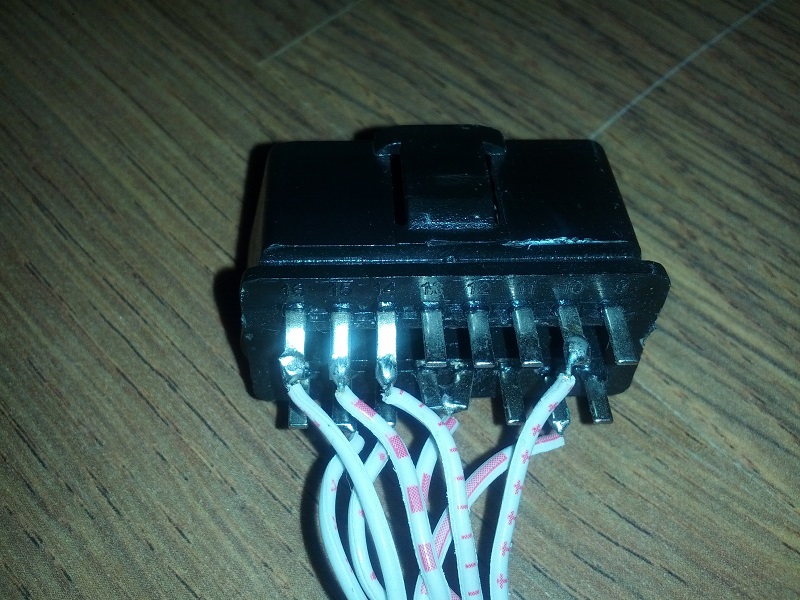

bluetooth wrote:I have ELM327 with MultiECUScan Software and 2004 Fiat Stilo 1.6.
I can not connect to Body Computer or Proxy module.
I can connect to only engine module.
How is repair this ELM327 ?
Please check it pictures.
