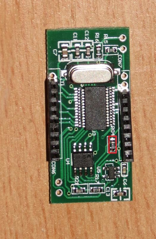

Hi, friends. I have two items - elm 327 mini and KKL Interface switched. When I scan for device (F11) I get error "U 1601"
car: Fiat Linea 1.4 16V T-Jet
Need help. Thanks a lot.
elm 327 mini:
KKL Interface switched:
Sorry if this has already been discussed. )
Posted: 18 Mar 2013, 19:48
Hello zaka
Your error U1601 means that the settings
Interface / COM port / not correct
Have you installed a driver for the FTDI interface?
Remove the red resistor R04 on ELM 327 mini
Then you can connect to the Can Bus establish controls
The KKL interface No error is present, this can be you
You need the KKL only for your ABS (Switch 1/9)
