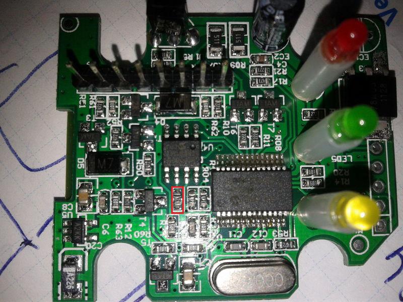

I have ELM327 with MultiECUScan Software and 2004 Fiat Stilo 1.6.
I can not connect to Body Computer or Proxy module.
I can connect to only engine module.
How is repair this ELM327 ?
Please check it pictures.
Thanks a lot.

Unfortunately, the pictures are very poor can not be seen as extending the tracks and no number on the components to detect
I once marked a resistor of the CAN bus connection could be a problem.
Which number is in the red resistor (121)??
20130219_161056 markiert.jpg (102.78 KiB) Viewed 8280 times
This, it could be
Unfortunately, I can not recognize the course of the tracks.
So I can not be sure

Yes this is number 121.
Remove?

And the resistance of the bridge pin 6 +7 from the MCP chip is soldered?
Then remove it
Unfortunately, the pictures are not very good, and I can not track lanes
Then remove it
No, i think only pin 6.
Please check it: http://postimage.org/image/4ztgc76k7/
Posted: 27 Feb 2013, 16:54
And where is the pin 7 of the MCP chip?
A higher resolution image would be helpful
I've already increased your image
Or try with removing this resistor
But the cautious can even re soldering

Alfaeddy wrote:Hello
Great! You are best engeneer! Thanks a lot. :)

Therefore, it has been the correct resistor?
I am glad that I could help you :)
Good luck with your interface :)
