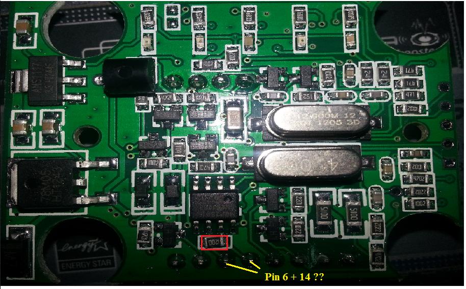

hello
i bought multiecuscan registered and elm 327 and i can't access to service interval and other, i can access to engine.
what resistance i have to remove??
And must i put the 2 resistance and capacitors?

Posted: 01 Feb 2013, 20:04
Hello Lexus59
Which is printed on the chip with 8 ports?
I can not read it
And please make a picture of the top of the interface
I can not see anything.
Posted: 02 Feb 2013, 09:33
by lexus59
Alfaeddy wrote:Hello Lexus59
I can not read it
i
on the chip is printed mop 25511
SN 1283
902
i think! is not very good printing.
thank for your help
Posted: 02 Feb 2013, 11:45
Hello Lexus59
This structure I do not know exactly?
But if the image on the yellow highlighted pins go on the pin 6 and pin 14
Then remove the red marked resistor should the CAN signal can actually be read
Please write back if this works this way.

Posted: 04 Feb 2013, 15:48
by lexus59
thx a lot eddy it's working, i can access at all menu !!!!
thx again,& have a nice day ^^
