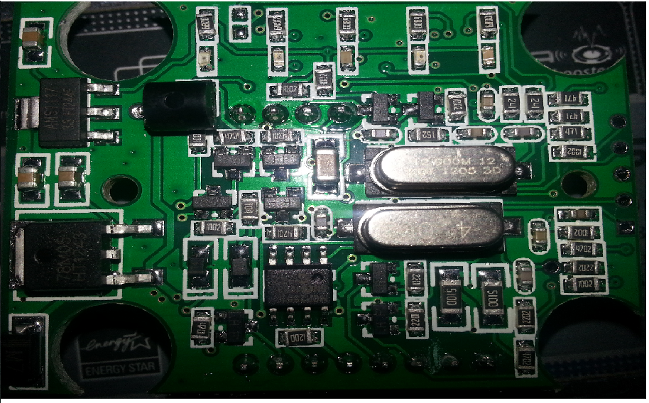

lexus59
Joined: 01 Feb 2013, 13:07
Post by lexus59 »
hello
i bought multiecuscan registered and elm 327 and i can't access to service interval and other, i can access to engine.
what resistance i have to remove??
And must i put the 2 resistance and capacitors?
(sorry for my bad english i'm french)
my car : fiat bravo2 1.6 mjtd dpf 120 sport
THX
my elm
my elm
elm327 reduit.png (935.2 KiB) Viewed 9345 times
Hello Lexus59
Which is printed on the chip with 8 ports?
I can not read it
And please make a picture of the top of the interface
I can not see anything.
lexus59
Post by lexus59 »
Alfaeddy wrote:Hello Lexus59
I can not read it
i
on the chip is printed mop 25511
SN 1283
902
i think! is not very good printing.
thank for your help
elm face reduit.png (425.96 KiB) Viewed 9338 times

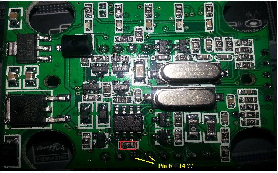

Hello Lexus59
This structure I do not know exactly?
But if the image on the yellow highlighted pins go on the pin 6 and pin 14
Then remove the red marked resistor should the CAN signal can actually be read
Please write back if this works this way.
elm327 reduit markiert.jpg (125.35 KiB) Viewed 9334 times
lexus59
Post by lexus59 »
thx a lot eddy it's working, i can access at all menu !!!!
thx again,& have a nice day ^^
