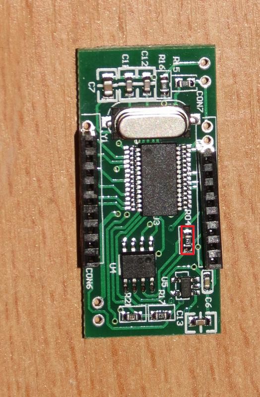

Hi guys I am new here. I am using for a while friends elm 327 1.4 usb and FES 3.6 and everything was perfect, few days ago I bought chip chinese Elm 327 1.5 bluetooth and looking forward to buy now multiecuscan 1.3 for my Alfa 159 1.9JTD 8v, but there is a problem when I connected my new interface to FES 3.6 I just can enter ENGINE unite, CAN NOT to go to Service interval, Body, Dashboard etc. Same message connection failed check your elm 327 cable or something like that. I saw few guys here have same problem but dont have interface like I have. Is there any avalaible mod for that interface.
Posted: 31 Jan 2013, 12:42
Hello Chexy
I have highlighted the relevant resistor red.
Can be removed this resistance and this also with ELM
Read Multiecuscan the CAN Bus Protocol
slka2 markiert.jpg (151.46 KiB) Viewed 9340 times

Posted: 31 Jan 2013, 13:06
After your image to judgments should this ELM Inteface directly with Mutliecuscan
Also, the CAN bus can read protocol.
On your board is the bridge resistor is not present.
What is the back?
Have you ever tested the Mito?
It should work normally.
