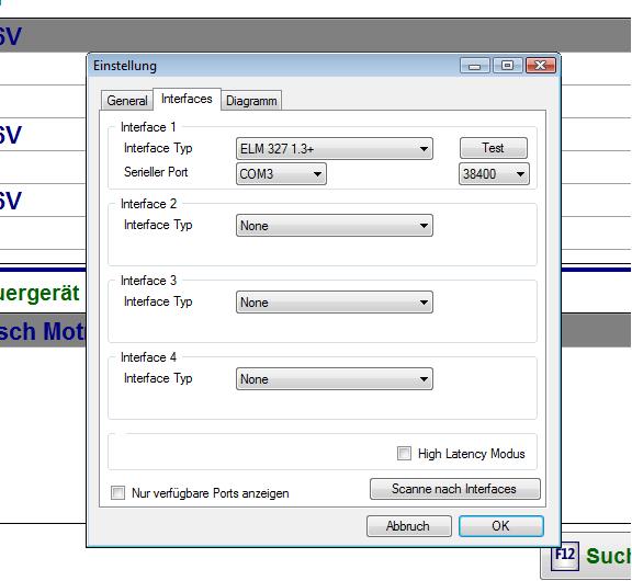

Posted: 10 Dec 2012, 19:24
Hello Xander
Test your latency timer of 16 to 1, it must be set to 1!
The rest is fine!
Then open Multiecuscan / Settings / Interfaces
where you put your interface a (ELM usb +1.3)
and the com port (com port 3)
ELM Einstellung.jpg (43.08 KiB) Viewed 8820 times

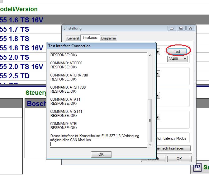

Then you put the interface into the diagnostic connector (3 pin adapter) and
shoot the red wire to the battery when the 3 pin adapter also has a black cable? it comes to ground -
Then you hit the test and come in this advertisement must
ELM Test.jpg (61.38 KiB) Viewed 8820 times

eddy hello, thank you very much to continue helping me
I changed the latency to "one" like you said and I followed the steps that you have shown me, but still i can not connect.
I am attaching the photos
Posted: 12 Dec 2012, 12:15
by xander
The other photos.
the second photo corresponds to scanner interface and it says latency very high
Can it be that the three pin cable this bad?
