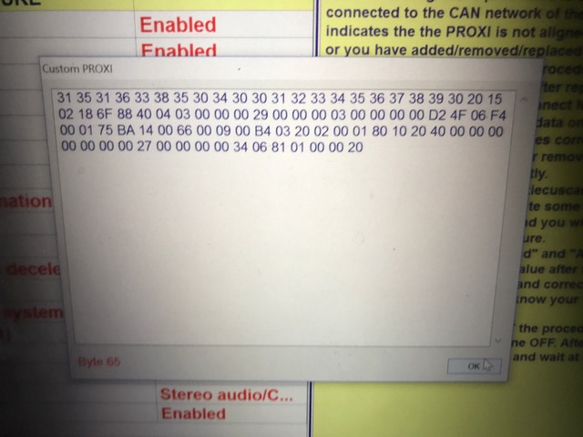

wow my 1.4l fiat 500 USDM looks so different. Does anyone know how to decode this ? Here is mine
Re: Missing menus from TFT display - Abarth 500
Posted: 27 Apr 2017, 05:24
by nufan0000
i think if we can decode this we can solve this issue!

nufan0000 wrote:wow my 1.4l fiat 500 USDM looks so different. Does anyone know how to decode this ? Here is mineIMG_9116(1).JPG
The only one that could decode the proxy code is Yani.
