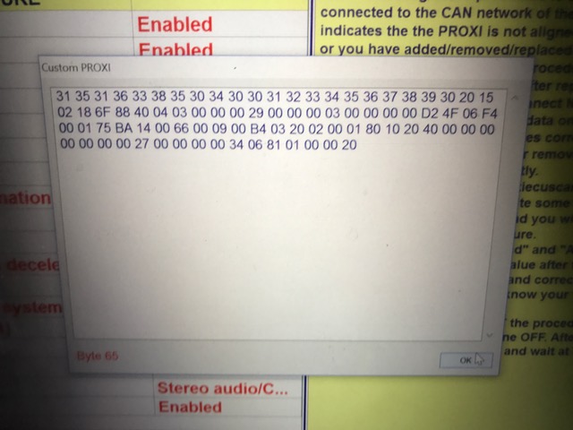

33 32 31 35 30 30 31 31 37 39 33 50 43 43 43 38 37 37 44 42 33 20 14 11 14 01 00 00 00 00 00 00 00 01 00 00 00 00 00 00 00 03 C2 77 06 F4 00 1C A0 AA 80 00 16 00 01 08 94 06 01 01 00 00 00 80 20 7A 41 0A 0C 0D 00 80 00 23 00 00 00 00 31 05 61 00 00 00 04 00 00 00 00 00 00 00 00 00 00 00 00 00 00 00 00 00 00 00 00 00 00 00 00 00 00 00 00 00 00 00 00 00 00 00 00 00 00 00 00 00 00 00 00 00 80 00 0C
As you can see the byte 65 is 20
nufan0000
Posts: 33
Joined: 19 Jan 2017, 06:32
Re: Missing menus from TFT display - Abarth 500
Post by nufan0000 »

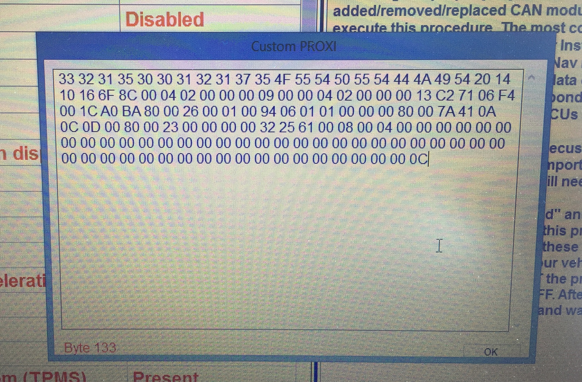

wow my 1.4l fiat 500 USDM looks so different. Does anyone know how to decode this ? Here is mine
nufan0000
Posts: 33
Post by nufan0000 »
i think if we can decode this we can solve this issue!
alex-et3
Posts: 199
Joined: 19 Apr 2017, 22:42
Location: ROVIGO - Italy
Post by alex-et3 »
nufan0000 wrote:wow my 1.4l fiat 500 USDM looks so different. Does anyone know how to decode this ? Here is mineIMG_9116(1).JPG
The only one that could decode the proxy code is Yani.
