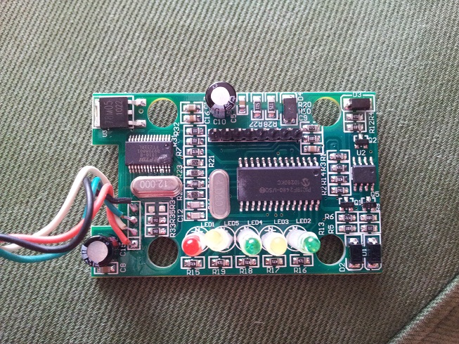

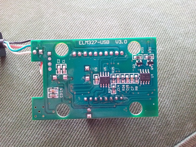

But I've had at least 15 different ELM interface from all over the world
All of them have worked so far, either immediately or after removing a resistor either R04 or R14 depending on the interface

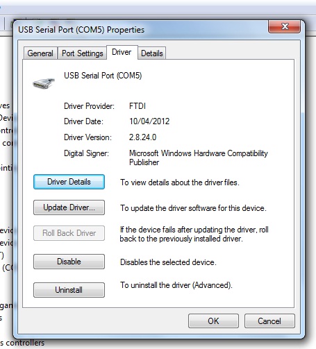

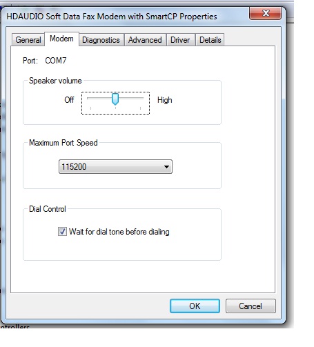

Hello to everyone . I read all the messages but I can't find a fix to my problem ... Multiecuscan (and multiecuscan) can't see my ELM , I can not find it .I have the ELM on COM 5 but when I search it with multiecuscan the only thing I find is my modem ?!?!? on COM 7 . I have a fiat croma diesel from 2005 and the ELM works , I tested with another software ( i don't know if i can say the name here ...PPSCAN) Thank you

Have you ever loaded the new FTDI driver
Posted: 15 Nov 2012, 22:12
by fabio25
Hi . Yes , I have 2.08.24 on windows 7 . I tested the ELM with 3 different software and is working . With multiecuscan and multiecuscan I can't find it .

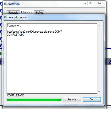

When I search the ELM on COM 5 I get connection timeout . If a make auto search he finds my modem on COM 7 ?!? Thanks for your help Eddy

The fax modem on port 7 is an error your ELM is not recognized correctly.
And thus it makes Windows a fax modem
The drivers you have installed
- The interface to register once on a different COM port
- Ask the latency time to 1 (instead of 16)
- In the ELM Multiecuscan sign on your amended COM port? to
- Plug your interface into the OBD socket
- Switch on the dashboard lights
- Press F10 Connect
Posted: 19 Nov 2012, 17:23
by fabio25
Hi Eddy ,
Thank you for your advices , now is working just fine .
Best regards from Italy
