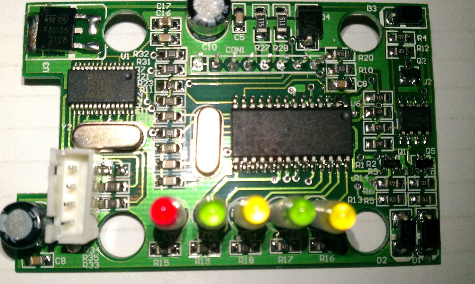

Quick answer, oyyeee, here is the pic: (or i just uploaded 2 on my site, here is a limit for the pictures size, so the front and the back of the panel on: http://siscoo.biz/tmp/dscf1159.jpg and http://siscoo.biz/tmp/dscf1160.jpg thoose ones are much more clear.

Hello Siscoo
Your ELM interface does not have this annoying resistor R04
So there should be no problem to read CAN bus protocols.
I have the same board design for my interface and the
works without problems
I suspect that you are a failure in the setting or the driver did.

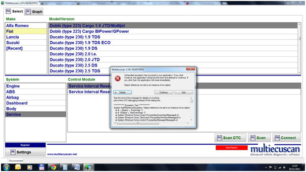

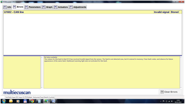

I tried the driver, the version number is the same what is built in the Windows7 64bit, but same results. I just catch a small info, when I tried to connect to body, then quickly F3 (see 2nd pic below) So just connecting to engine, the rest is for 2 seconds only, then the program going back to the mainscreen
Something problem in the CAN bus signal, i checked the connector on the car, looks OK, this is the second cable what i tried. I wanna reach the service menu.
If im quick with sortcuts, for example, F10 to connect to SERVICE, then F7 and after I click on anything to select then F10, the MultiECUScan freeze out. (see the screenshot)
What can be wrong? Maybe the CAN bus on my car? Or the cable? I using the FTDI chip driver. Help, please!!!

I have extactly the same wired, green, ELM327. I know that orange and other colour has problem with connection. Sometimes by R04 resistor. Sometimes, nobody knows why... Very good, that it is working.
