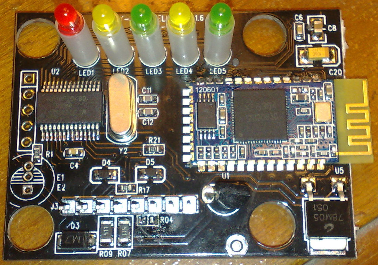

Good evening to everyone, I'm a new member of the forum I wanted to ask for help because I bought from ebay a bluetooth ELM327 interface.
THis interface is connected with the ScanMaster software (only it can detects the voltage of the battery) but can not connect to the ECU.
I also tried to remove the resistor R4 but still does not work.
These are photos of the card
The version of ELM327 is 1.6, and my car is a Peugeot 206 of year2000.
Thanks to anyone who can help me
Bye
Roberto
P.s. Sorry for my bad English...

Posted: 27 Oct 2012, 08:15
Hello Roberto
I suspect that no one can help you here, because it is not about Multiecuscan
nor to vehicles that are supported by Multiecuscan.
Whether your ScanMaster software ever to connect with your Peugeot
can produce, I do not know. Since I know the french cars are very special there.
The thing with the resistor R04 in the CAN bus protocol only concerns Multiecuscan, I know of no other software problems with this type of interface has ELM.
A friend of mine also has the ScanMaster software and Bluetooth ELM for its Opel Zafira, 2006, can not connect to it.
And the developer of ScanMaster to say, that could be this and nothing could change it
Sorry
