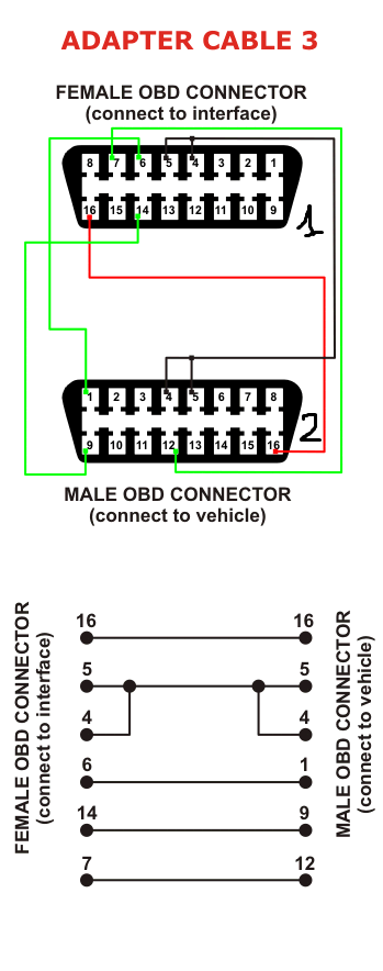

Guys maybe i found the solution...let me now if i'm right! So, this is the circuit of adapter A3
My connector has the wires connected in the same positions of the 1 image (4-5-6-7-14-16)...if i disolder those and solder them in the positions like the 2 image? Have i an ELM19 interface?! Thankssssssssssssss

I I have this message for accer has abs he(it) needs an adapter?
THANK YOU
