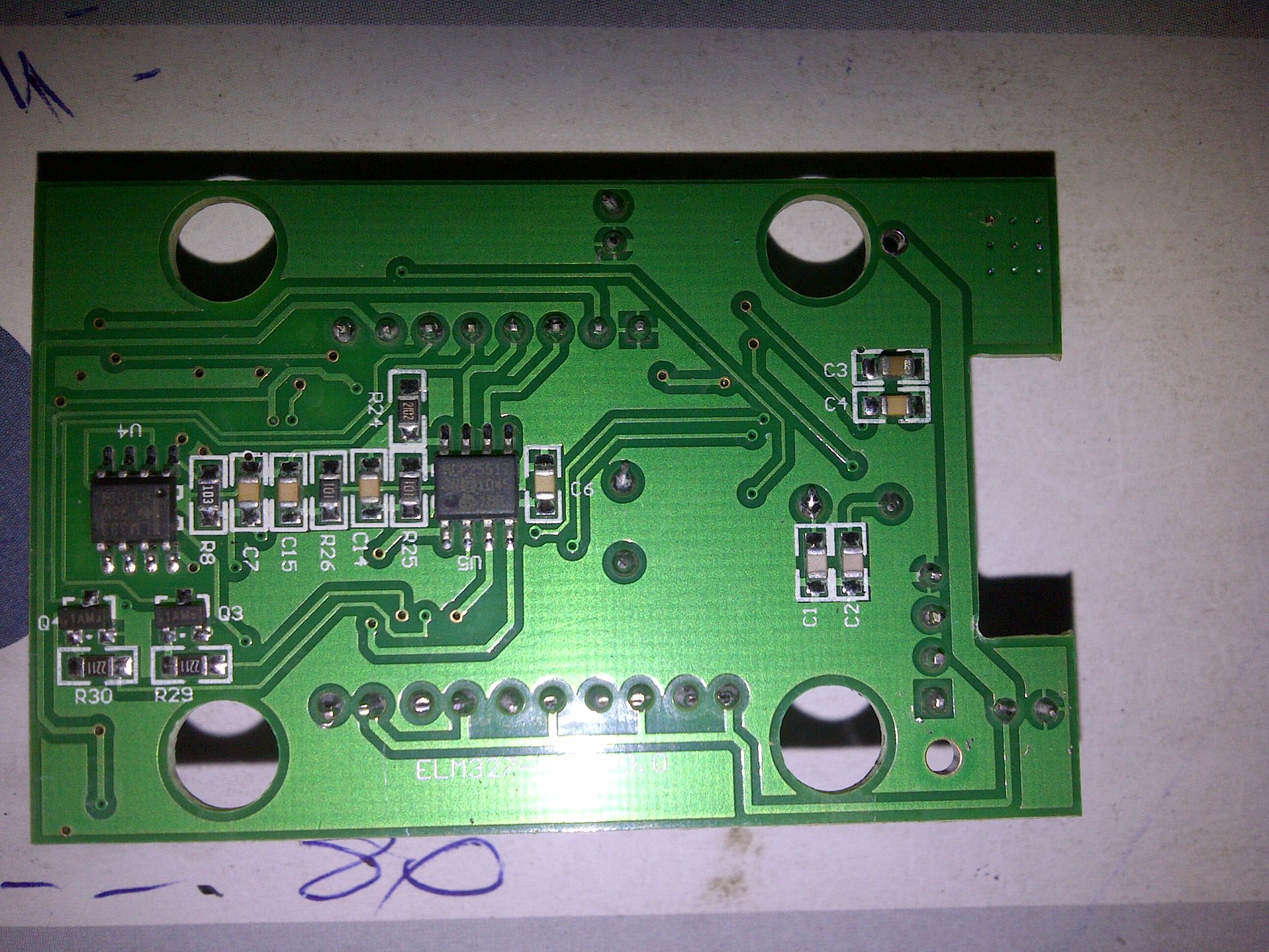

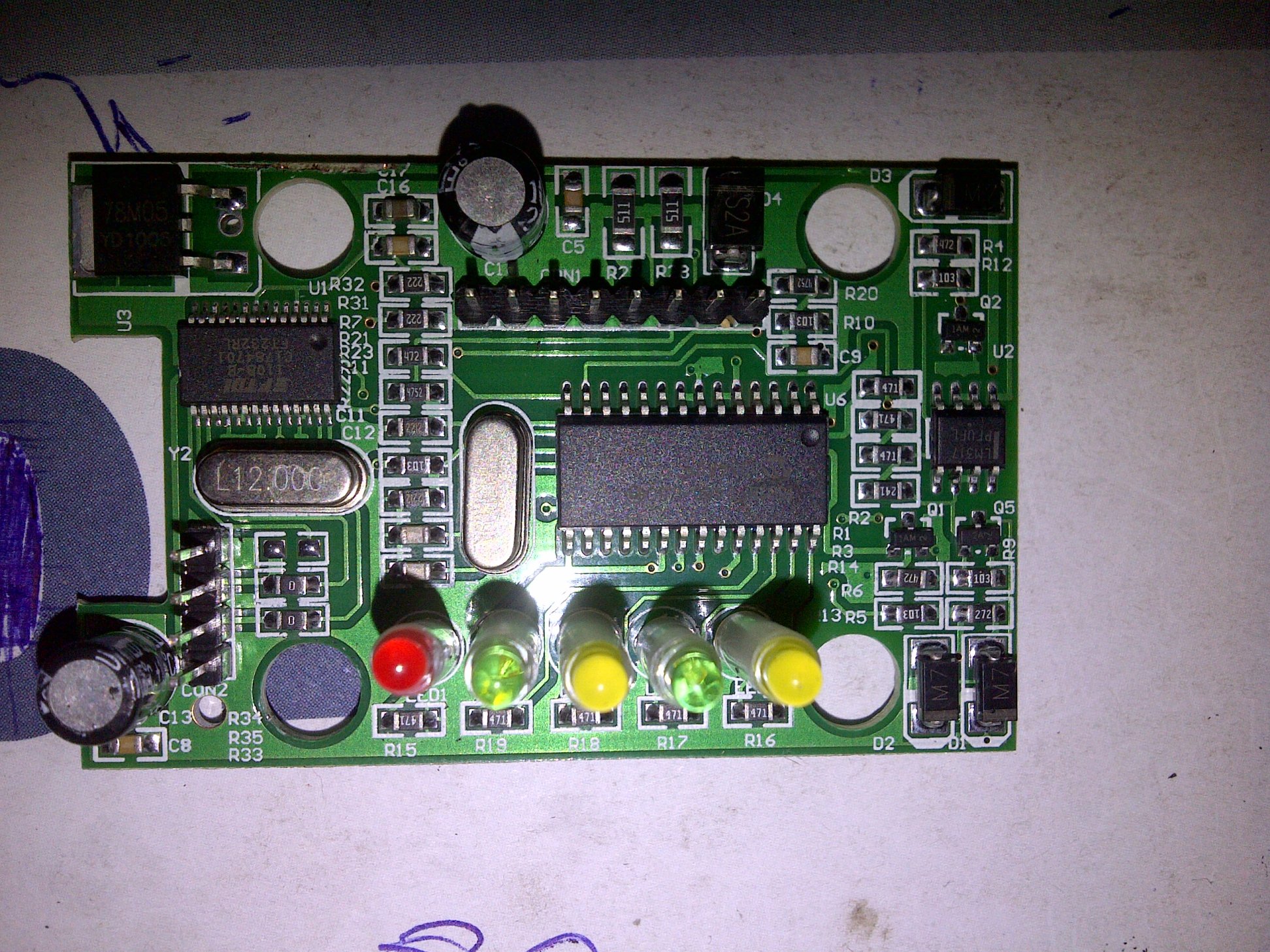

I can see many different mobos but I cannot find similar to mine. Can anyone please help me and show which resistor should I remove please?

Basically when I do the interface search I can find my ELM but I have "latency too high" message at the bottom. All the tests are OK but I can see this error and I also have difficuties to connect to FIAT cars so that's why I thought I need to do some kind of trick with my interface.
