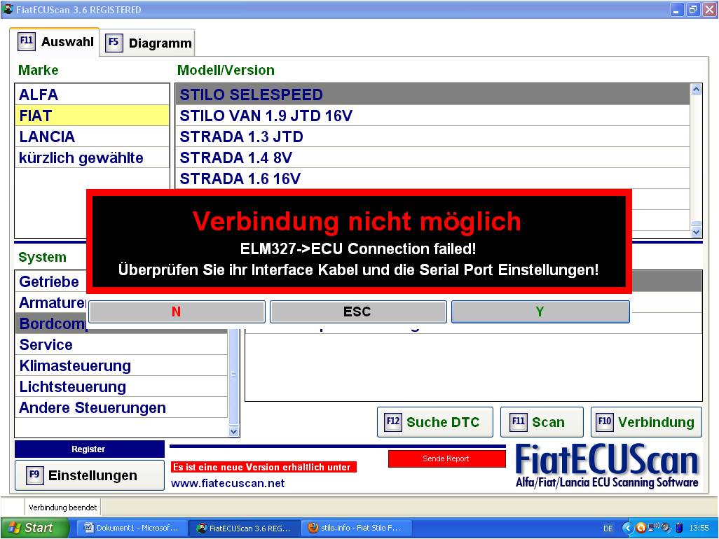

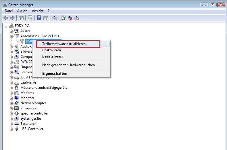

Here the driver is installed!

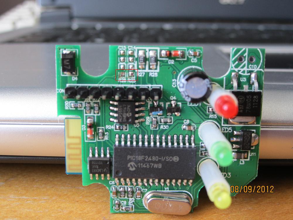

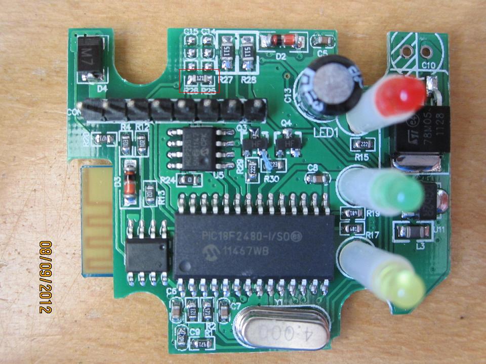

by feder1991
was also a problem with the elm327 v1.5
I was already removed r04 contact.
still is an error message.
can info and proxy alignment erro
sry my english is not very well.
can help me please.
or can i conversion the kkl interface?
thanks

Posted: 09 Sep 2012, 14:10
If the resistor R04 has been removed, your ELM interface must also function in the CAN bus
And thus should have a proxy and CAN / info / setup and connection goes
Presumably, your settings are not correct
Check the COM port , drivers, latency, etc.

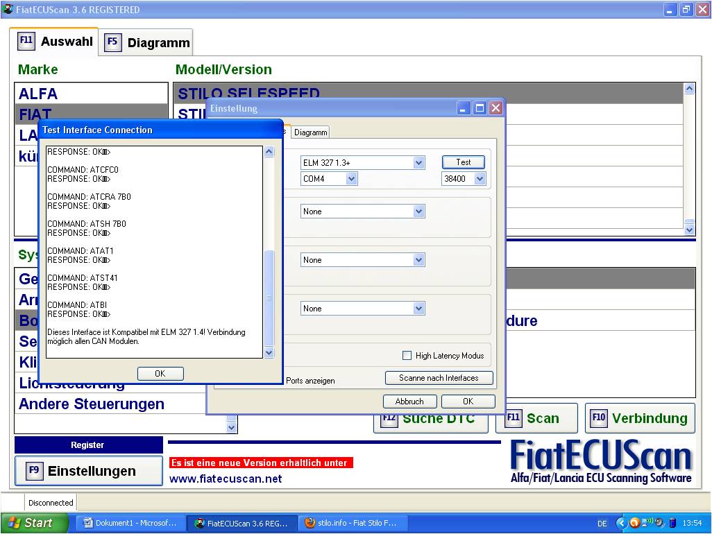

I have the same device as djzoran showed in a former post:
Unfortunately I failed so far to connect to the ECU of our 2009 Fiat 500 1,2l 8V so far.
I applied the 38.400 bps mod, somebody suggested here and I modified the wiring in the plug (7 -> 12, 14 -> 9, 6 -> 1) to avoid an adapter cable.
The test runs fine. An ELM327 v 1.3a is detected and a message says that the device is compatible with ELM 327 v1.3 and that it should connect properly with all CAN modules.
Has anybody succeeded yet to connect with such an alu-boxed device (allegedly Ver. 1.5a) to a Fiat? Any suggestions what else could be tried?

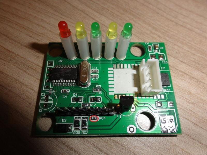

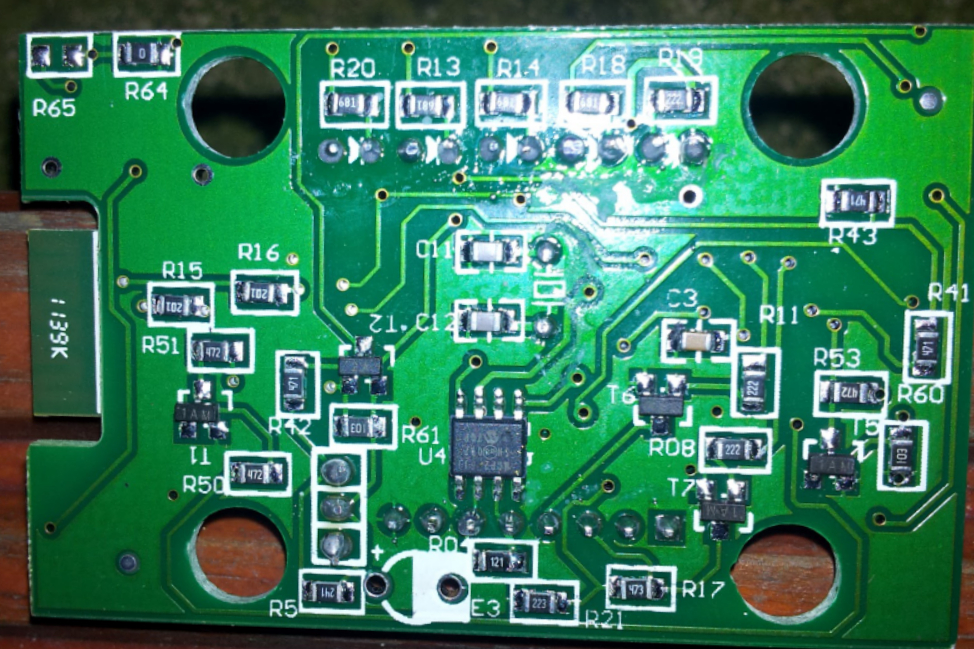

by fisha
my elm does not have this resistor. Is it possible to do something?
- a2.png (988.85 KiB) Viewed 12152 times
- a1.png (981.58 KiB) Viewed 12152 times

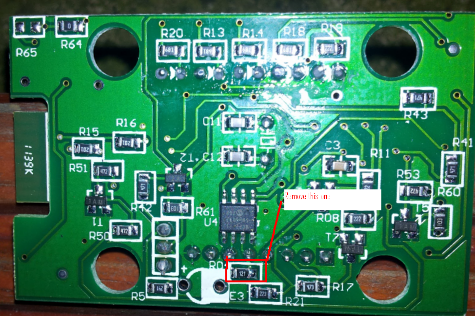

Posted: 18 Sep 2012, 04:13
by mattydr67
@fisha
Are you sure sir?
You have that R04 rezistor
Unsolder it. I marked for you in your pic
- a2.png (1.52 MiB) Viewed 12151 times
Posted: 18 Sep 2012, 21:24
by fisha
you are brilliant thank you very very much

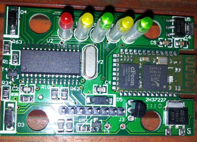

This are the pictures of my ELM327 Bluetooth-device.
There is a resistor which must be removed for full functionality.
Front of PCB
- Front of PCB
- IMG_0204_mod_small.JPG (124.19 KiB) Viewed 12059 times
Resistor removed
- Resistor removed
- IMG_0212_mod_small.JPG (108.33 KiB) Viewed 12059 times
