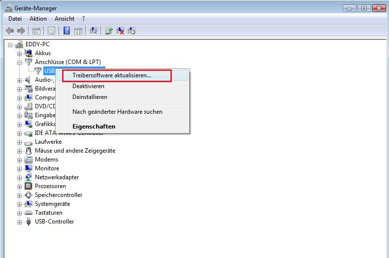

Here the driver is installed!
Neue Treiber.jpg (44.12 KiB) Viewed 12263 times

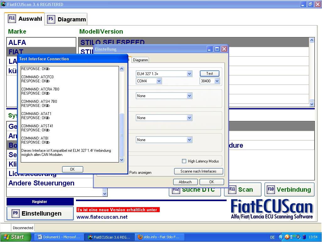

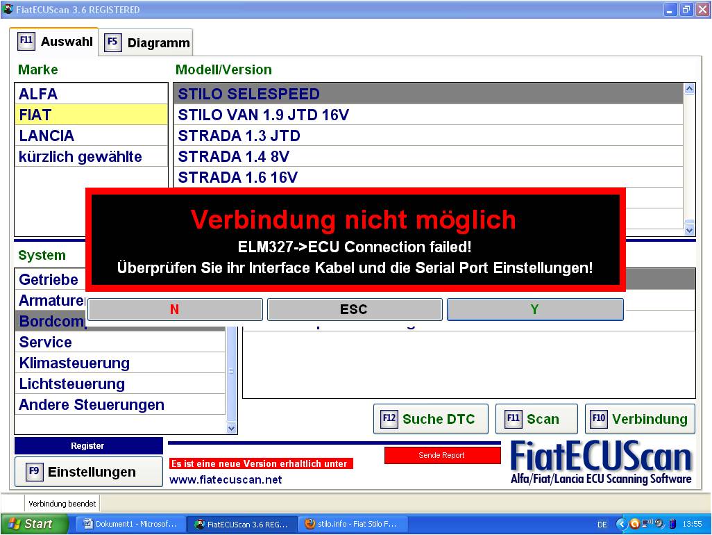

I have the same device as djzoran showed in a former post:
Unfortunately I failed so far to connect to the ECU of our 2009 Fiat 500 1,2l 8V so far.
I applied the 38.400 bps mod, somebody suggested here and I modified the wiring in the plug (7 -> 12, 14 -> 9, 6 -> 1) to avoid an adapter cable.
The test runs fine. An ELM327 v 1.3a is detected and a message says that the device is compatible with ELM 327 v1.3 and that it should connect properly with all CAN modules.
Has anybody succeeded yet to connect with such an alu-boxed device (allegedly Ver. 1.5a) to a Fiat? Any suggestions what else could be tried?

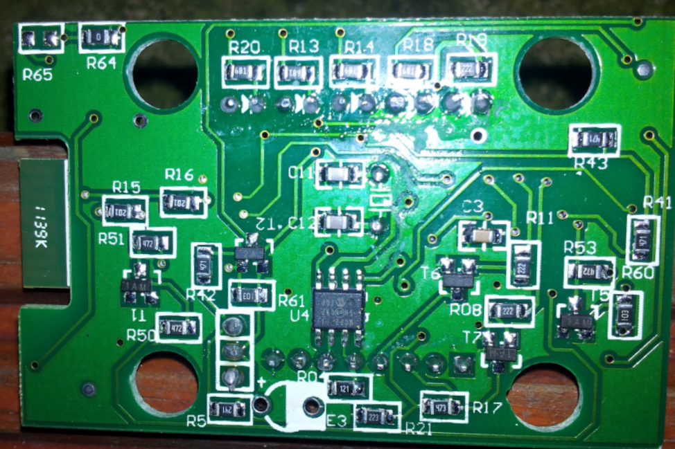

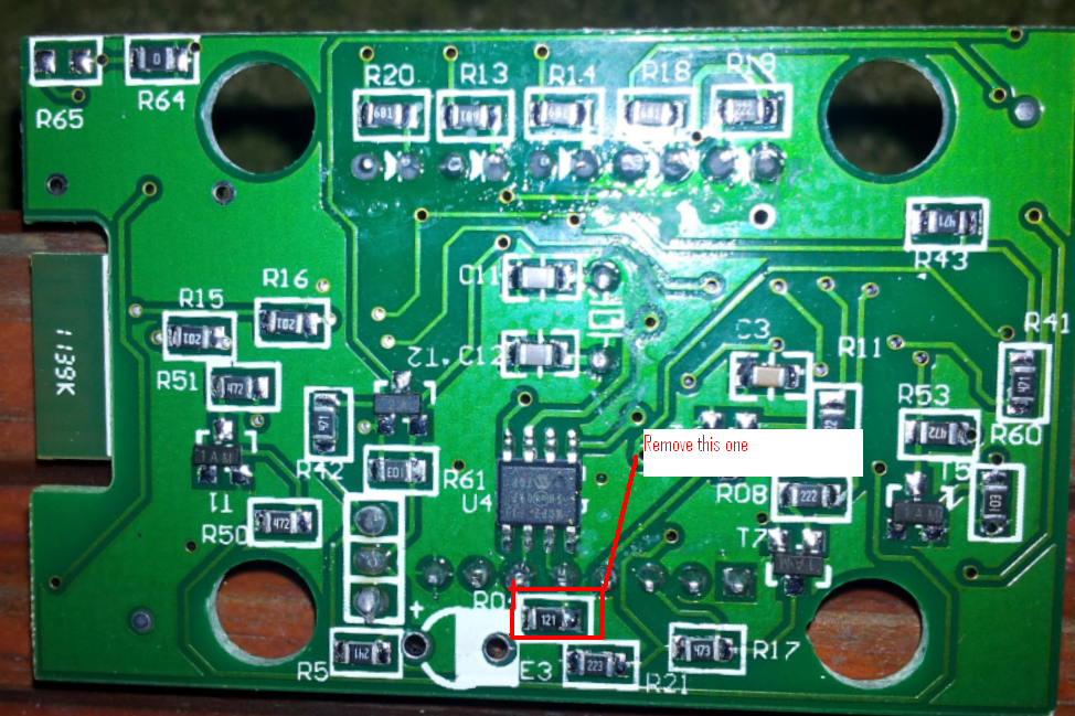

@fisha
Are you sure sir?
You have that R04 rezistor
Unsolder it. I marked for you in your pic
fisha
Joined: 18 Sep 2012, 00:39
Post by fisha »
you are brilliant thank you very very much

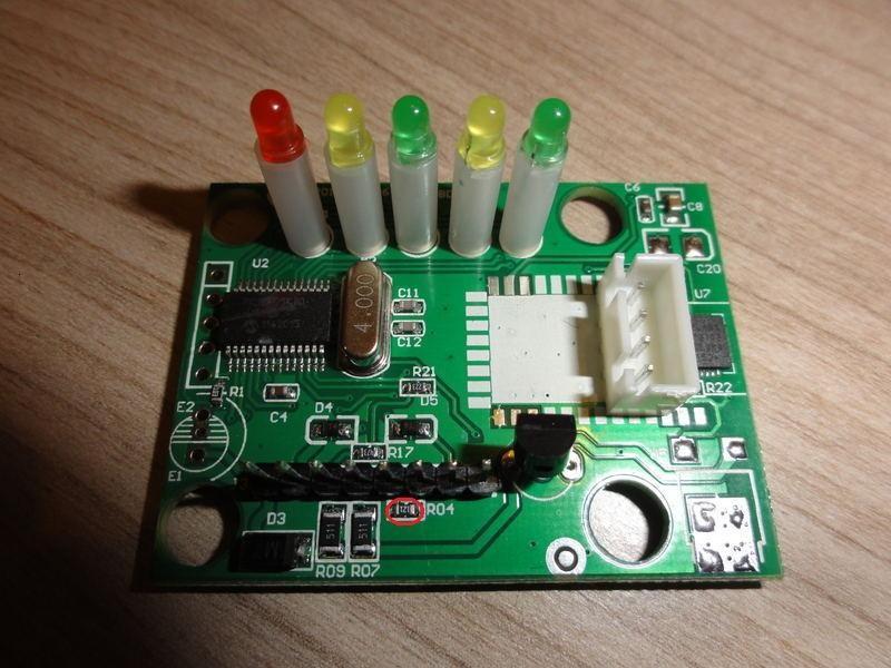

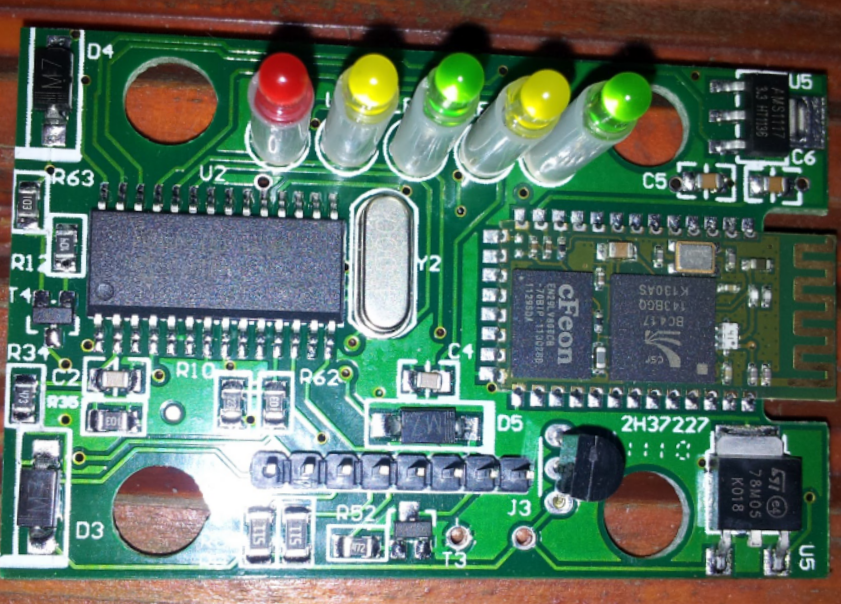

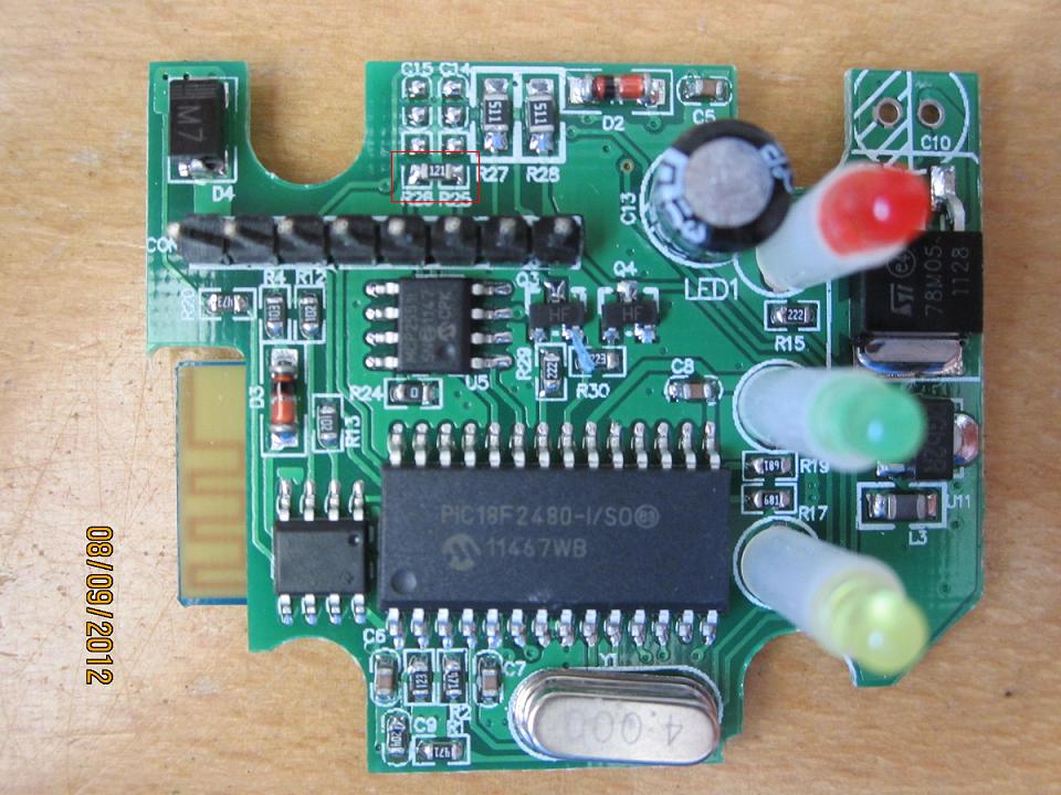

This are the pictures of my ELM327 Bluetooth-device.
There is a resistor which must be removed for full functionality.
Front of PCB
Front of PCB
Front of PCB
Resistor removed
Resistor removed
Resistor removed
