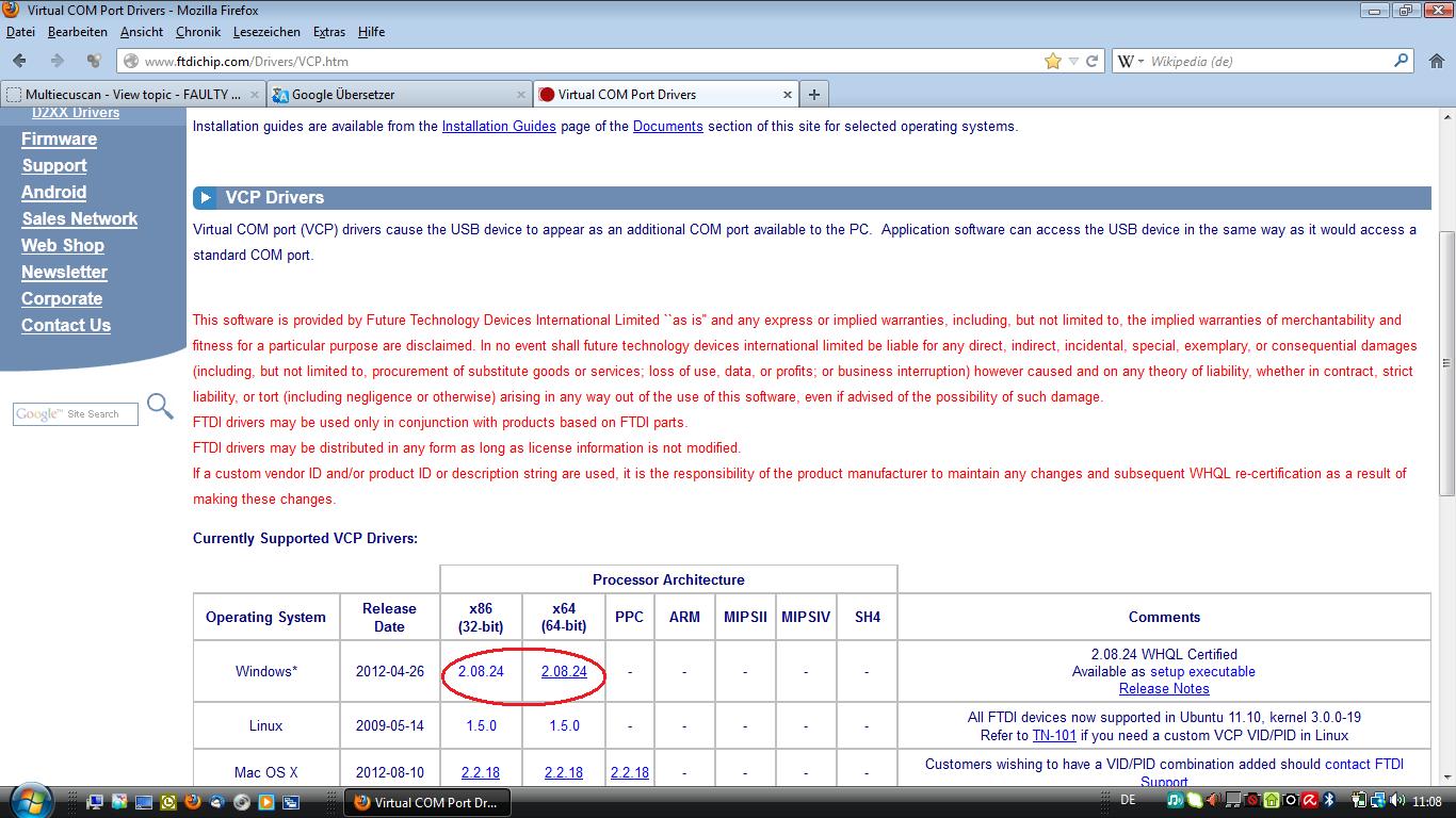

First of all, what Windows system you have on your computer?
32 bit or 64 bit?
And besides, both of the same driver 02:08:24
Try this driver
Posted: 02 Sep 2012, 14:46
by Luckjs93
You mean this?
www.ftdichip.com / Drivers / CDM / CDM% 202.08.24% 20WHQL% 20Certified.zip
But once saved and opened, there is no inside. Exe file that will install
HELPPPPPP

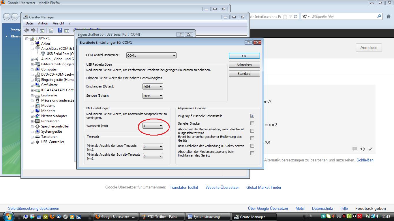

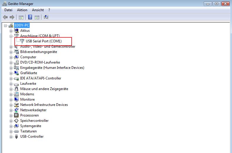

Posted: 03 Sep 2012, 09:28
Hello Stilo
Have you installed the FTDI drivers?
FTDI Treiber.jpg (182.81 KiB) Viewed 9675 times
If your interface detected without error?
Have you asked the Latency Time in 1?
Latency Time.jpg (143.01 KiB) Viewed 9675 times
Otherwise must be some other error

Hi thank you very much for your help and the pictures but I still can not connect to CANBUS. Only motor. Error codes can be deleted. capacitors and resistors R04 and removed. FDTI installed and configured.
