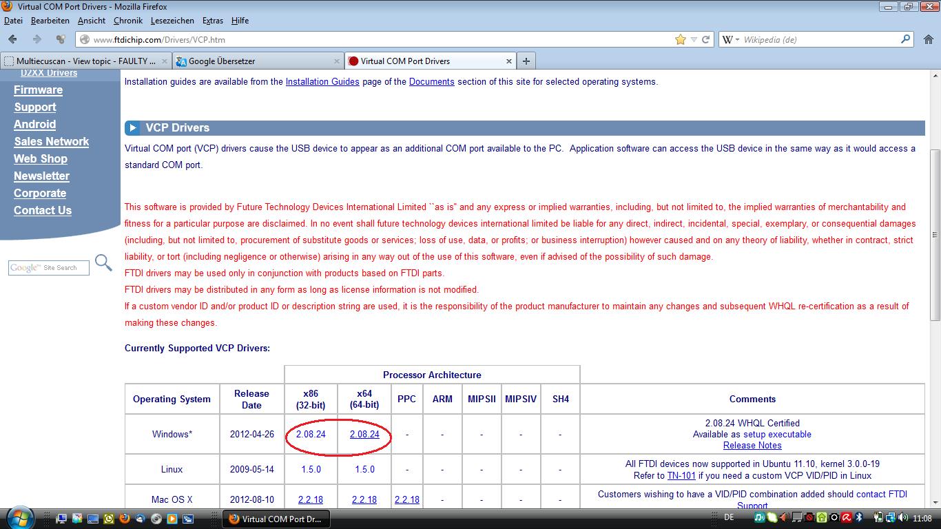

First of all, what Windows system you have on your computer?
32 bit or 64 bit?
And besides, both of the same driver 02:08:24
Try this driver

You mean this?
www.ftdichip.com / Drivers / CDM / CDM% 202.08.24% 20WHQL% 20Certified.zip
But once saved and opened, there is no inside. Exe file that will install

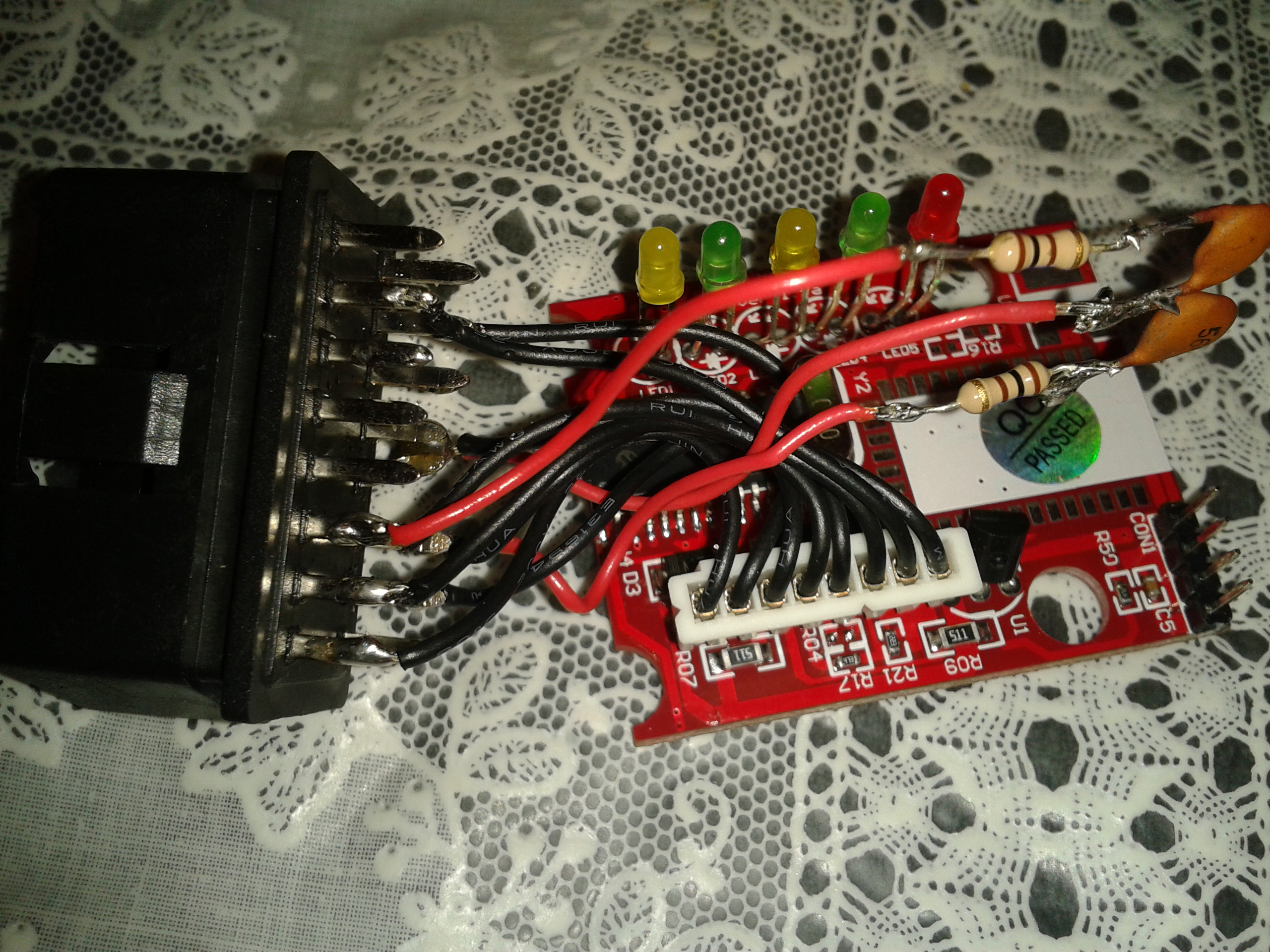

Hi I did everything you have said. Removed two resistance R04 and 2 capacitors soldered and still do not know what a proxy alignment procedure could be the problem? Help me please

I have said to you but that you have to remove the resistor R04!
Only the R04 no other
And I have not written anything of the additional resistors and capacitors!
That are not needed!
This FTDI driver is required if your interface is not recognized!
If your interface detected???
Please look in the Control Panel!

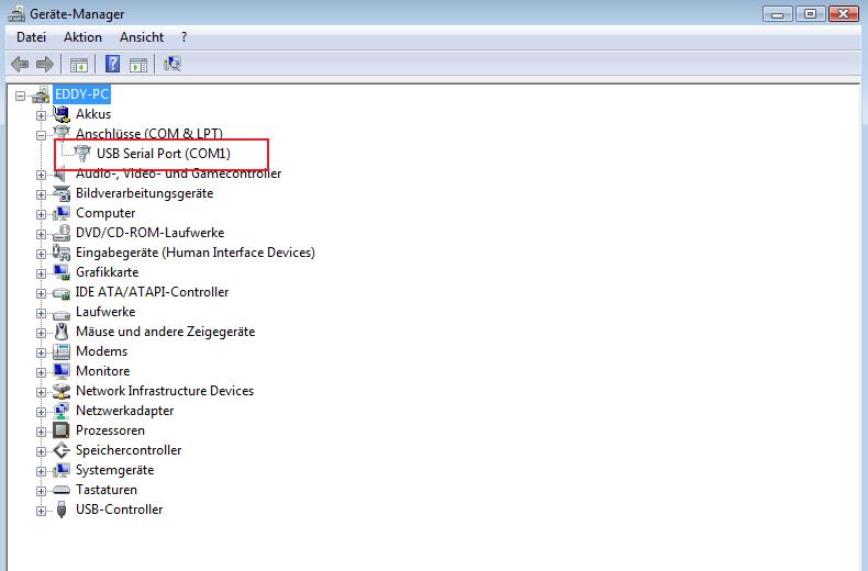

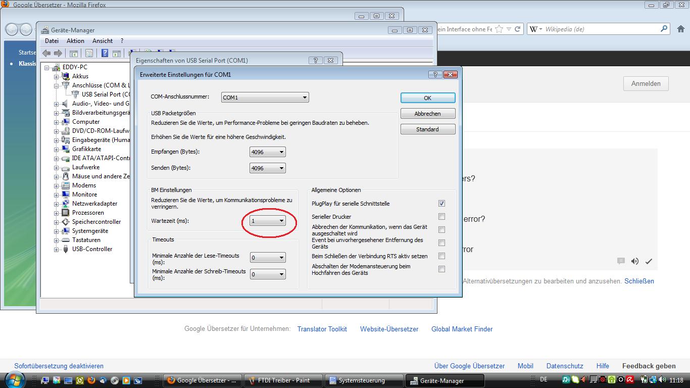

Hello Stilo
Have you installed the FTDI drivers?
FTDI Treiber.jpg (182.81 KiB) Viewed 9664 times
If your interface detected without error?
Have you asked the Latency Time in 1?
Latency Time.jpg (143.01 KiB) Viewed 9664 times
Otherwise must be some other error

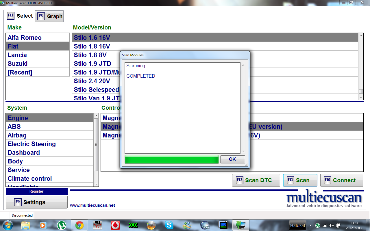

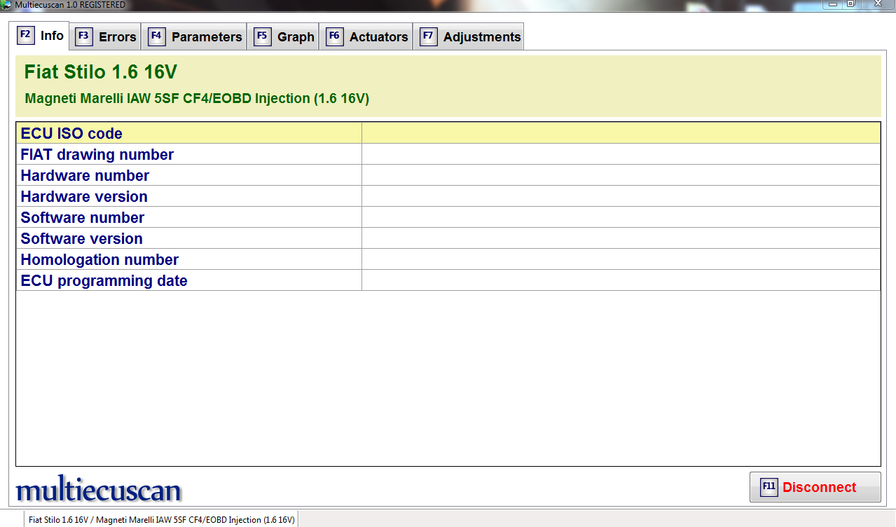

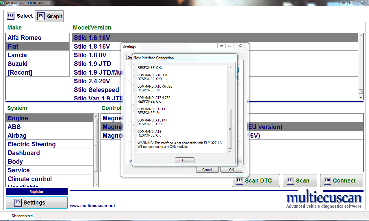

Hi thank you very much for your help and the pictures but I still can not connect to CANBUS. Only motor. Error codes can be deleted. capacitors and resistors R04 and removed. FDTI installed and configured.

Hello Stilo
Of course, your problem is the CAN bus that everything you've removed and soldered it only relates to the CAN protocol.
Your engine control is read with ISO14230
Presumably you've destroyed your interface with your renovation
Once more:
Only the resistance R04 is removed!
