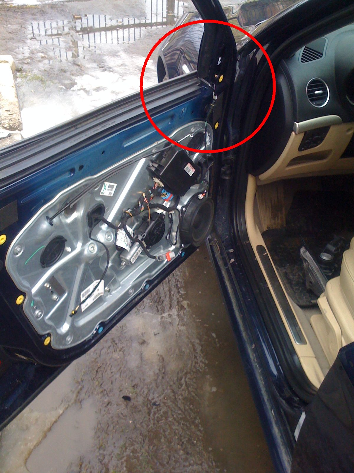

Do I have to take apart the door's cover, get out the control unit, open it up and check the traces on the PCB, but can anyone point where on the PCB is the anti-trap sensor's place?

There is no sensor in window gasket. You need to have the old one gasket from 2007. See attached photo - in red circle there is connector. But even with this it doesn't work. There is something in BC or in wiring that need to be fixed.betageminorum wrote: Do I have to take apart the door's cover, get out the control unit, open it up and check the traces on the PCB, but can anyone point where on the PCB is the anti-trap sensor's place?
