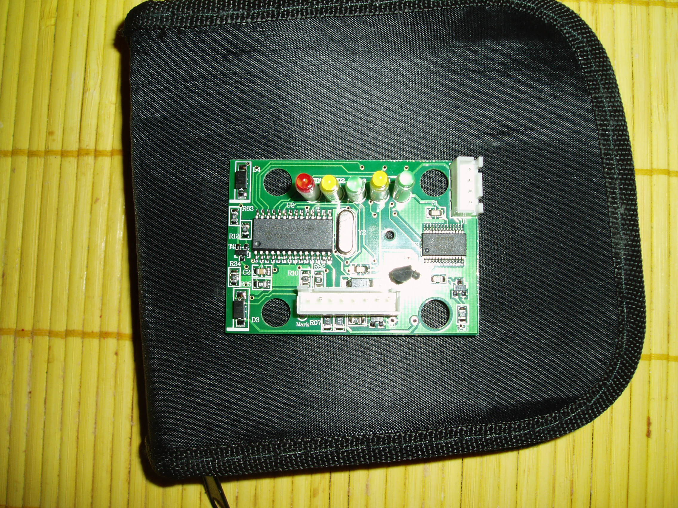

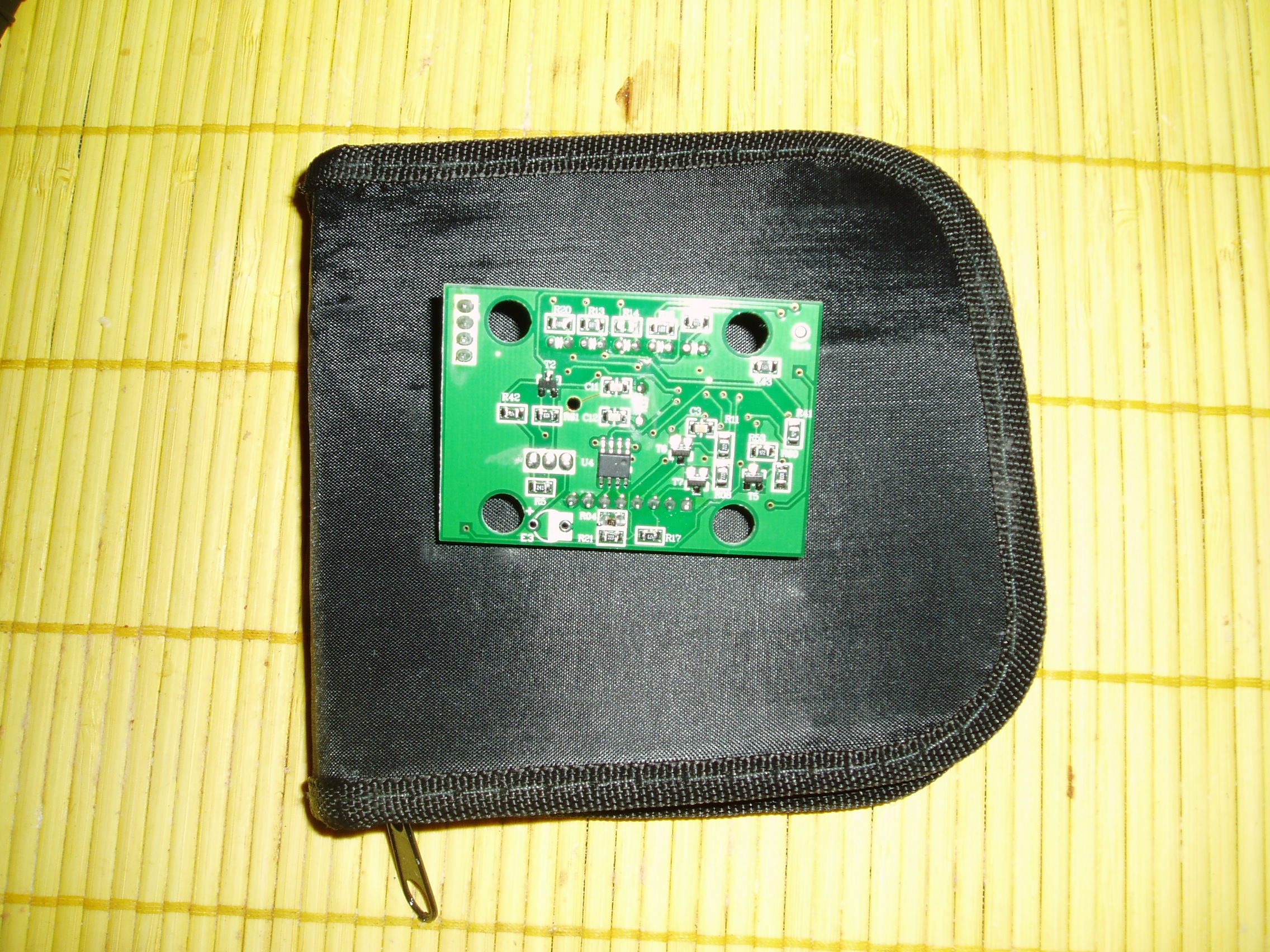

As I said earlier, I bought a new 327 elm v 1.5 but I can not understand that I do change. Attached photos of the circuit .... Thanks in advance!
- elm2.JPG (891.41 KiB) Viewed 9803 times
- elm1.JPG (858.41 KiB) Viewed 9803 times

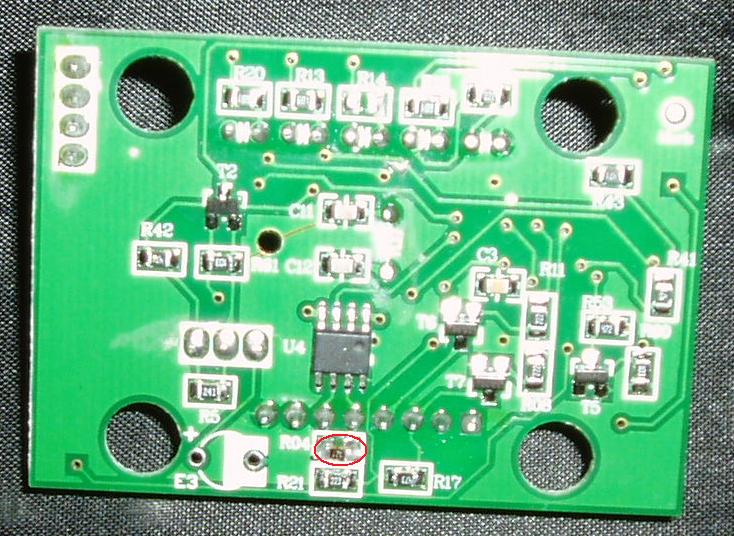

You have to remove the red circled resistor R04.
Then your ELM also works in the CAN protocol (ISO 15765)

I removed the R04 resistor and it now works like a charm

As I see in your pics your tool it is 1.5
The chinese made this version 1.5 which can be version 1.3, 1.4 or in the bad case 1.2
Version 1.2 it is not support by the FES
So in this case you have to go in other CAN car and try to connect using a softwear for ELM327
And if you can connect in a car based on CAn, VW Golf 5, Skoda Octavia II, Ople Insignia, Opel Vectra C/Signium or Astra H etc in this case you have bad luck the tool is version 1.2
