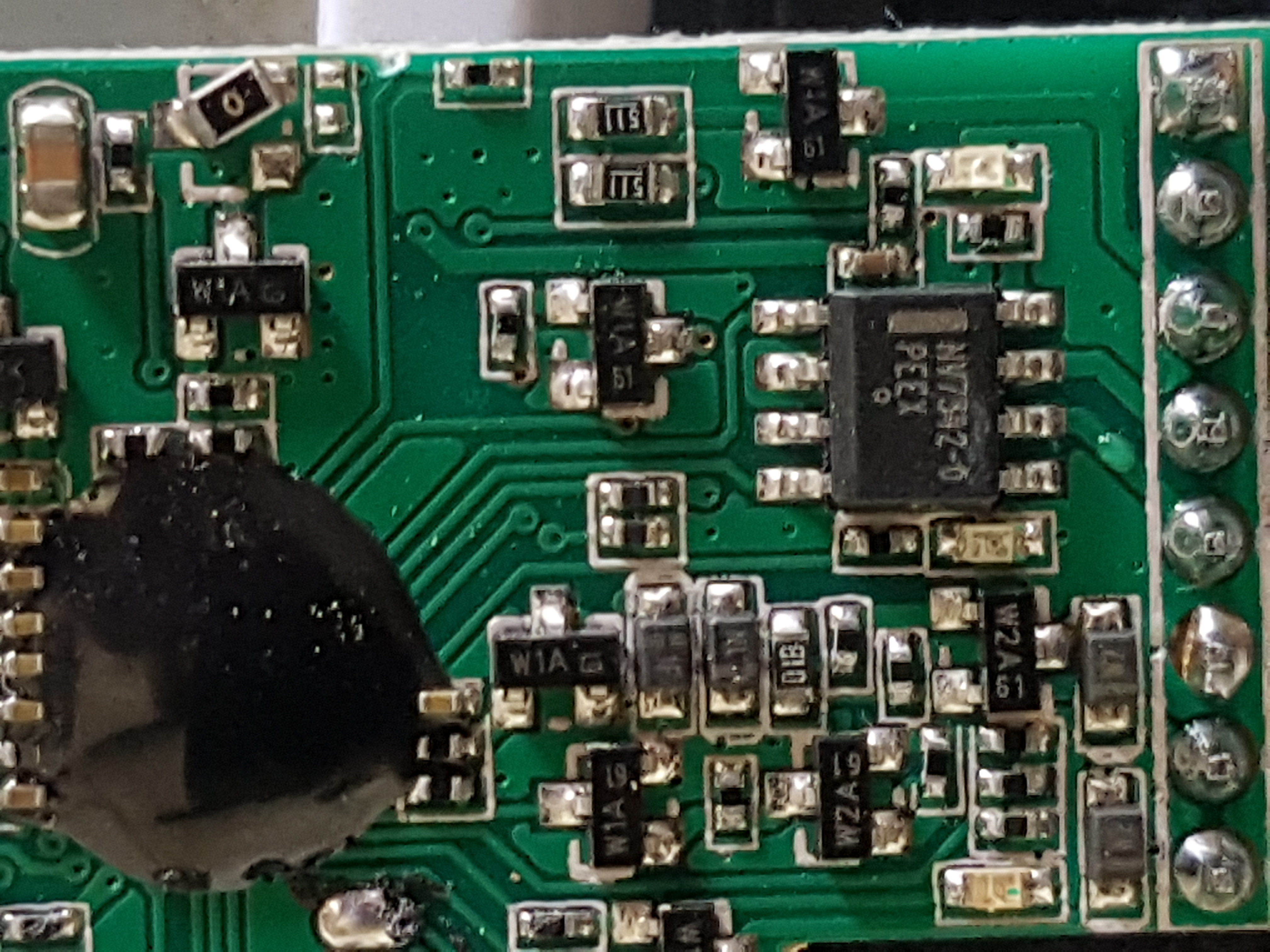

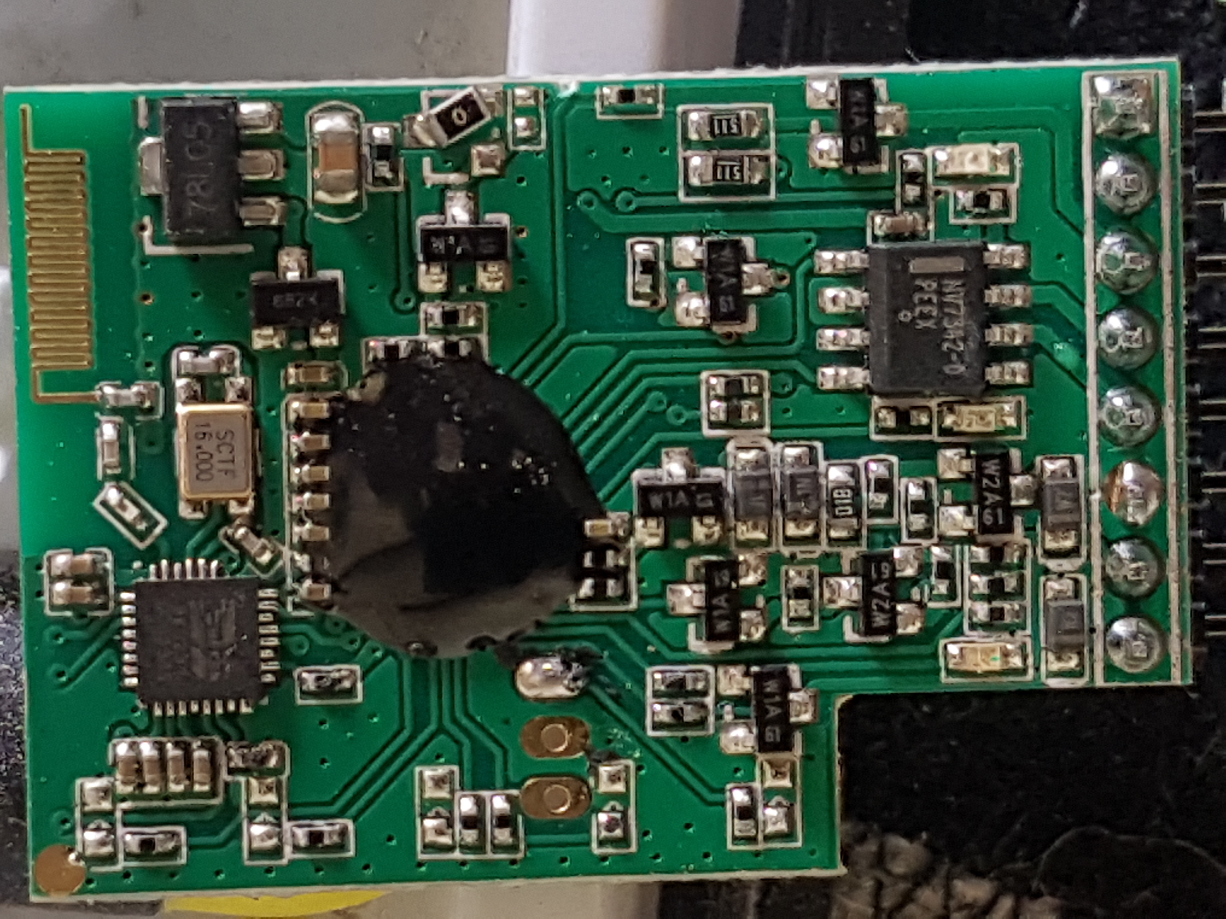

Hello i bought elm 327 1.5a and i first i thought is the driver problems i didn't know unless i saw this thread.
I cant pass the last test on Multiecuscan v3.1.
U can see the problem is it in the second picture
I tried with different ports speeds and its fails in the first test.
Also when i connect to the car its says also that operation has timedout and check ports and cable...
Doi have to remove the resistor ?

Can anybody help me identify the wrong resistor on my adapter board? I'm having trouble with it.
Car is an alfa 159 1.9jtdm 150

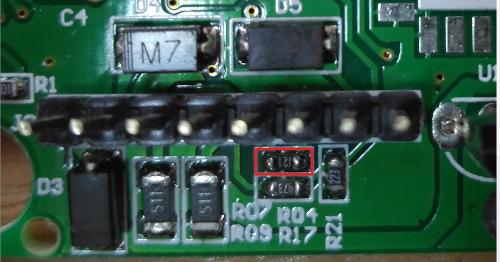

by cxem
Multiecuscan
CAN pin 6 and pin 14
Remove resistor 120 ohm

Can anybody help me - where is resistor that must be dissassembled?
Posted: 12 Apr 2017, 12:32
by cxem
Here are:
