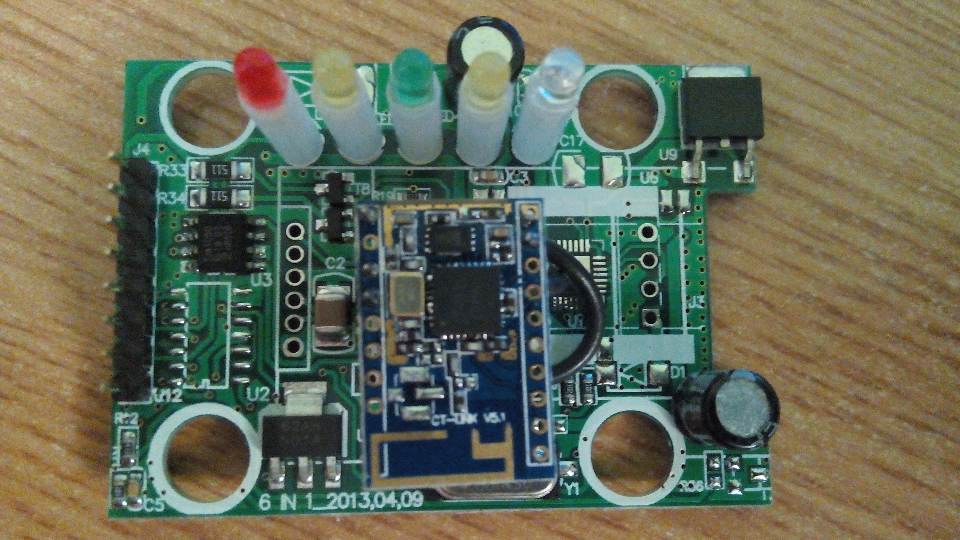

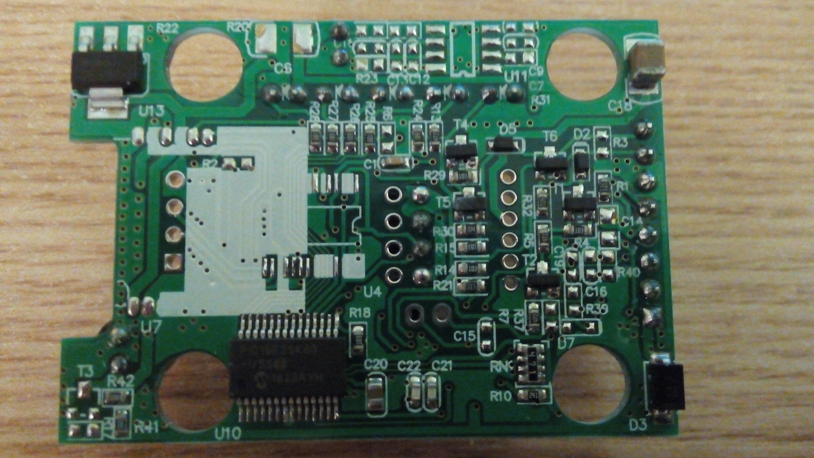

I have this ELM327 v1.5 Wifi and I can't connect to CAN interfaces (Body). Only engine.
The car is Fiat Stilo.
It's the same problem with a resistor? Which one please?
Thanks a lot!!!
Thanks a lot!!!
- IMG_20170112_004623.jpg (2.21 MiB) Viewed 10574 times
- IMG_20170112_003325.jpg (2.42 MiB) Viewed 10574 times
- IMG_20170112_003044.jpg (2.47 MiB) Viewed 10574 times
Hallo
It is the Resistor R1 with the Number 121
´Greeting Eddy
´Greeting Eddy

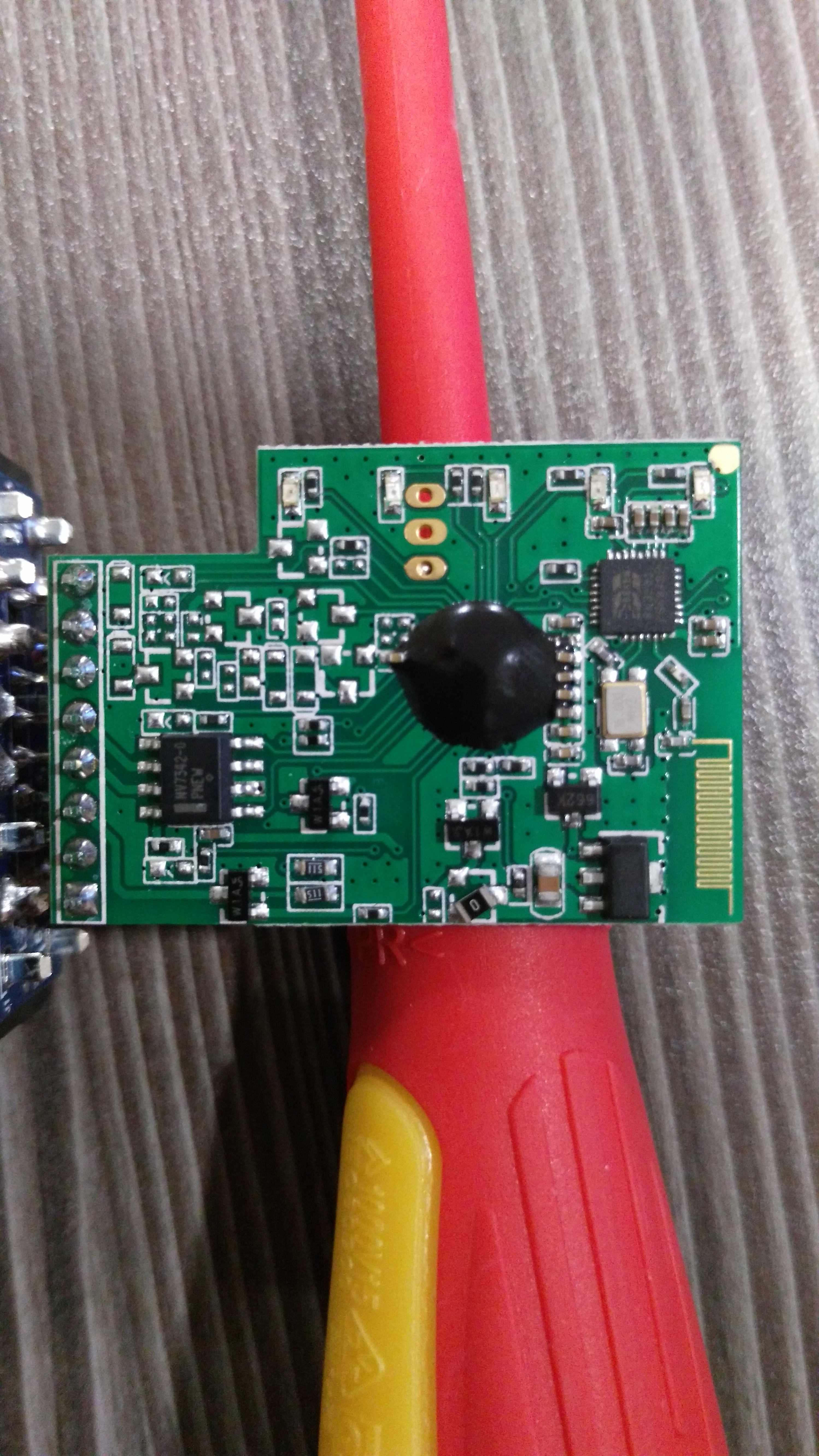

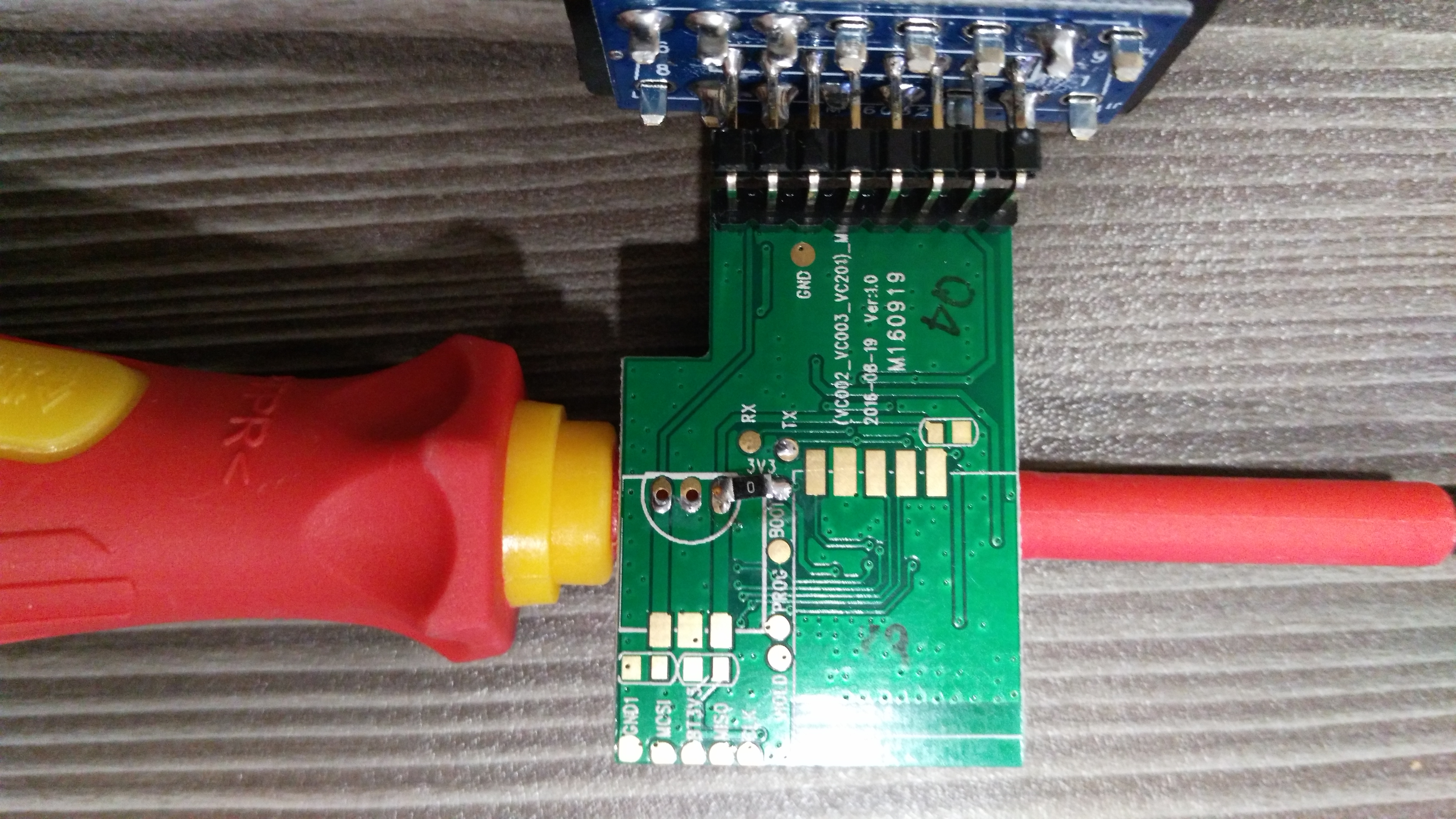

Hello guys, i have chinese Elm327 Bluetooth, but some 2016 version
i doubt it can be done to connect with CAN, even to see the board, but although i will post picture of the board if someone know something?
Best Regards
Best Regards
- IMG_20170114_203645.jpg (4.46 MiB) Viewed 10545 times
- IMG_20170114_203630.jpg (4.55 MiB) Viewed 10545 times
Hello Galt
Make an Interface Test with Multiecuscan
and post an Screen with an Image
On your Board can´t find an Bridge Resistor
the Motor ecu ist read not with CAN Bus
Also your connect must with no one modifikation

Hello Galt
I thought it already this interface is not compatible with MES and also AlfaOBD
There are only a few v1.5 ELM interfaces that work.
This has nothing to do with a bridge resistor.
Thanks a lot anyway Eddy. I thought that v1.5 will not be a problem, becouse my WiFi version is also 1.5 and do not have this problem, but anyway...which version of bluetooth is best?Alfaeddy wrote:Hello Galt
