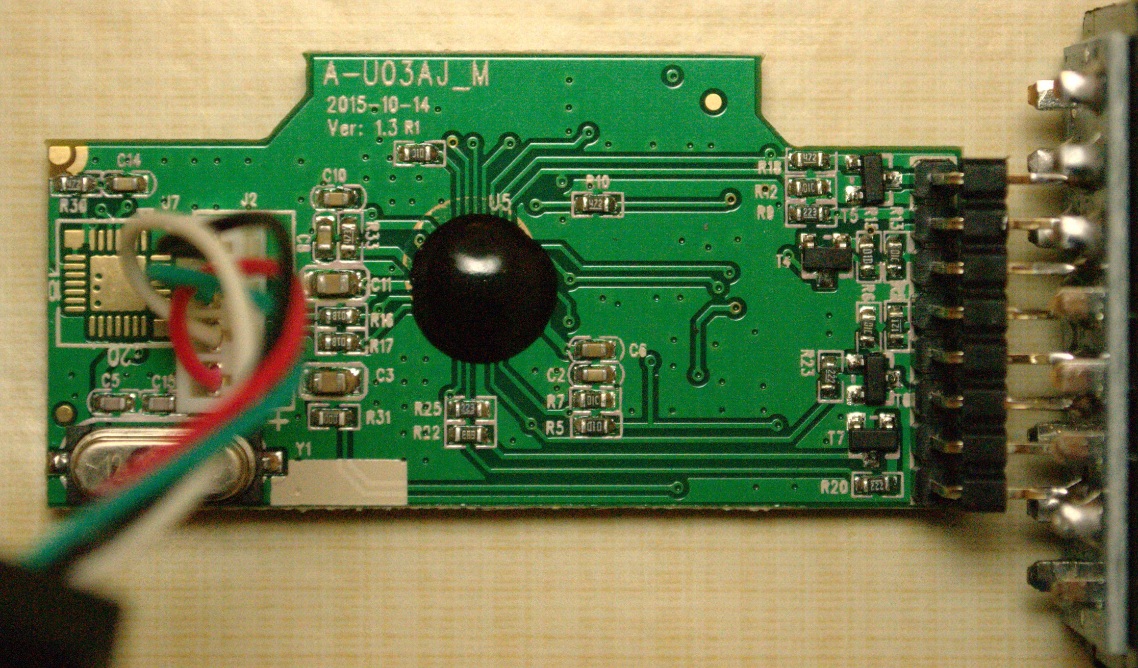

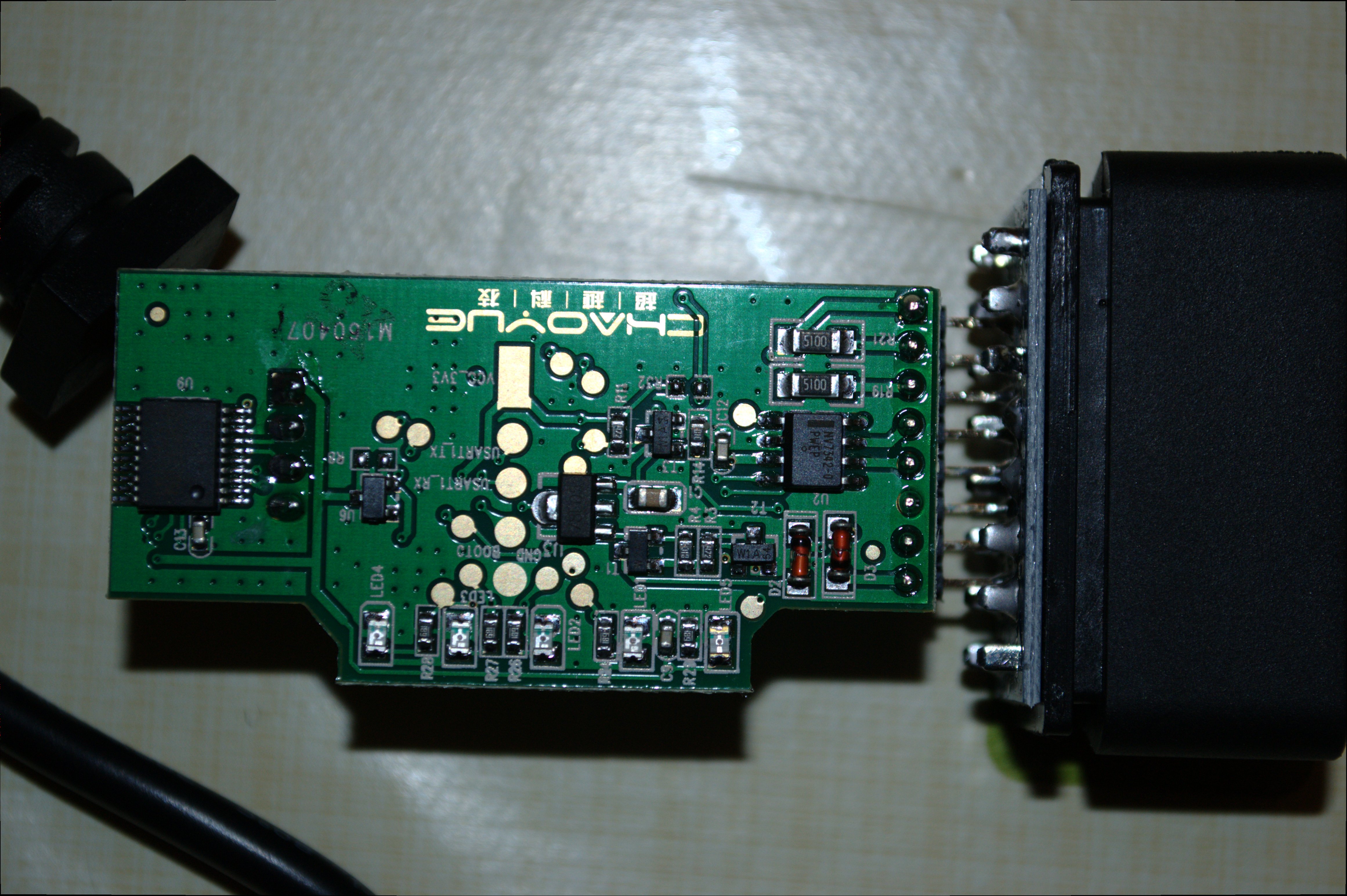

I took apart my diagnostic tool and it doesn't look at all like the other tools, this is how it looks, what resistors do i need to remove to make it work with my Alfa Romeo 147
Posted: 06 Oct 2016, 18:36
Hello Lonerunner
Do you remove the red marked Resistor
Then you can read the CAN Bus Protokoll
http://www.bilder-upload.eu/show.php?fi ... 779301.jpg

Thanks Alfaeddy, i did not remove R2 resistor, i will try to remove it and try it out to see if it works. I actually found that PacBoy have the same interface as i do on this thread on page 208, and the same error when try to pass test
http://www.jpeg.cz/images/2016/08/09/rXiy.jpg
So i didn't want to remove any resistors until i get response from someone.
Btw, this is CH340 chipset and i have it tested and working with that driver on Seat car.
