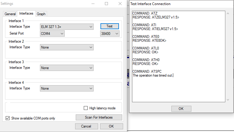

Having trawled the forum until my eyes bleed from jargon I am having a connection issue I hope the kind folk on here can help with. I cannot find the ELM 327 bluetooth interface v2.1 in the MES interface scan. It is found and paired sucessfully with windows 10 laptop as bluetooth device "OBDII". I have played about with the settings and can only get something to come up on the COM5 port when I try and 'test' and it runs through the first commands and indeed recognises the ELM device and version number however it stalls on the Command: ATSPC timeout. Any ideas? I did also manage to pair the device with an android phone and tried torquepro and it failed to connect to the ECU aparently, also failed to connect with device and torque pro to a Peugeot 307.

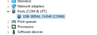

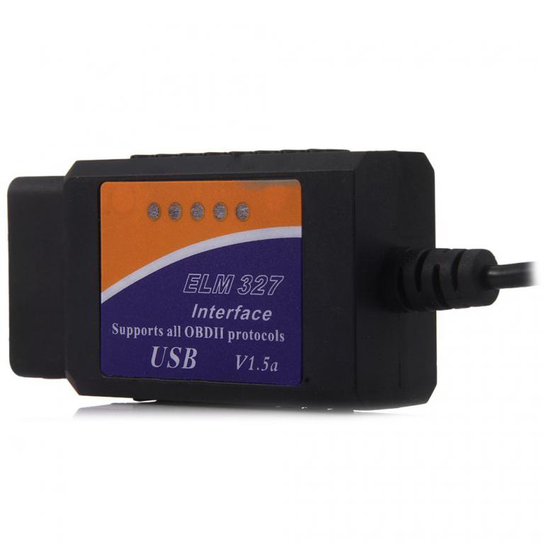

Please advice, i have one of those cheap ELM327 which is supposed to support all OBDII interfaces but i can't even connect to ecu on my Alfa Romeo 147, it connects on other cars like Seat Ibiza but not on Alfa.
Here are the details,
My ELM is exact name is ELM327 OBDII v1.5
- ELM327-OBDII.jpg (28.99 KiB) Viewed 24538 times
But i can't even connect to ECU, when i try to connect, the window stays empty for a while while and than drops out with error, the thing is that my odometer flashes for a second and nothing more.
When i try to test interface i get this.
- Capture1.PNG (23.57 KiB) Viewed 24538 times
And device is connected and working with ch340 driver
- Capture3.PNG (6.01 KiB) Viewed 24538 times
