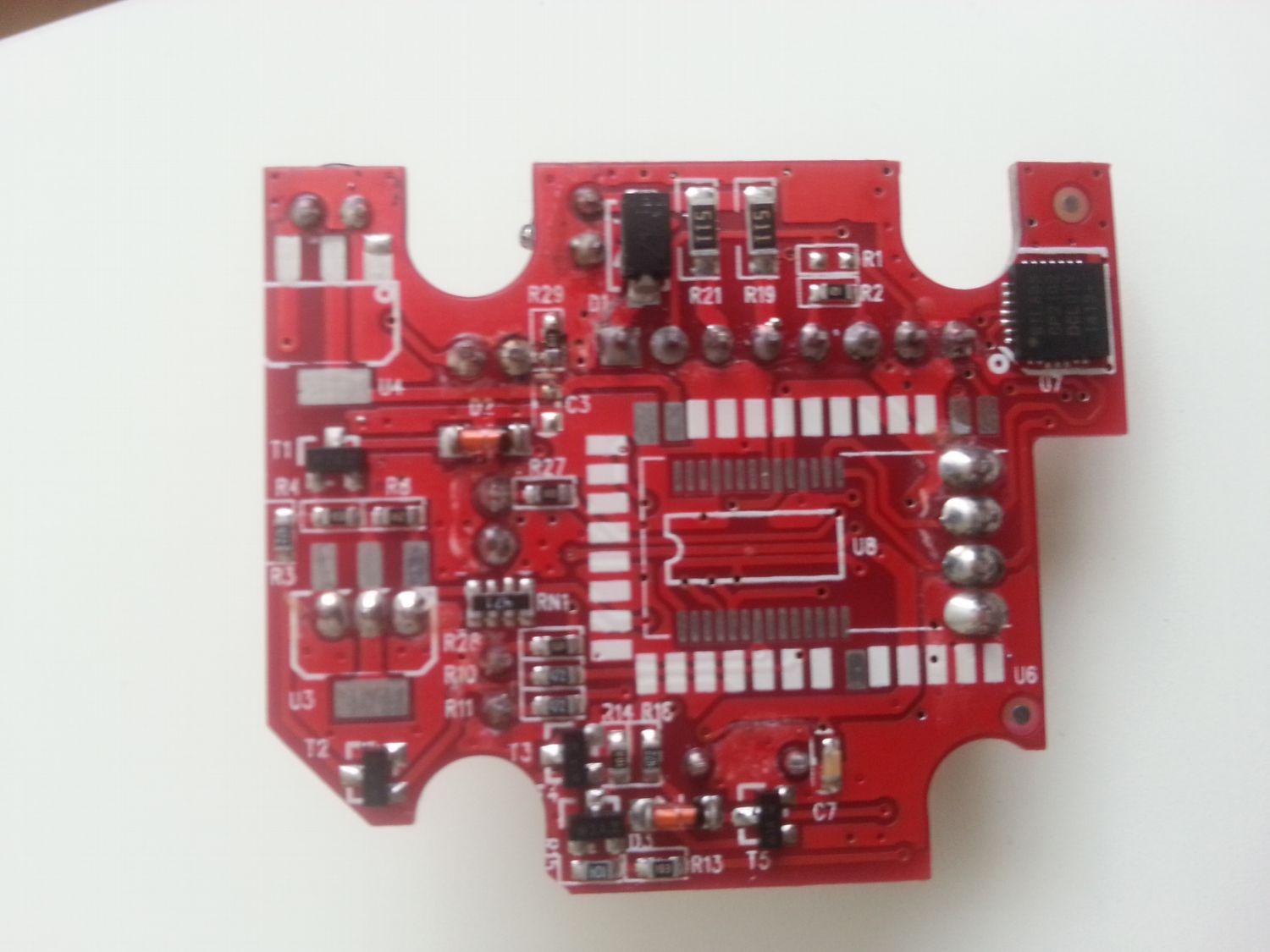

Hi Matt
Your photos are unfortunately very bad, too small and not very focus
But I suspect the R1 on the reverse side of the bridge resistance is the
must be removed
But first make time a screen of the interface test, as Anderson
and showcase your screen here in the forum

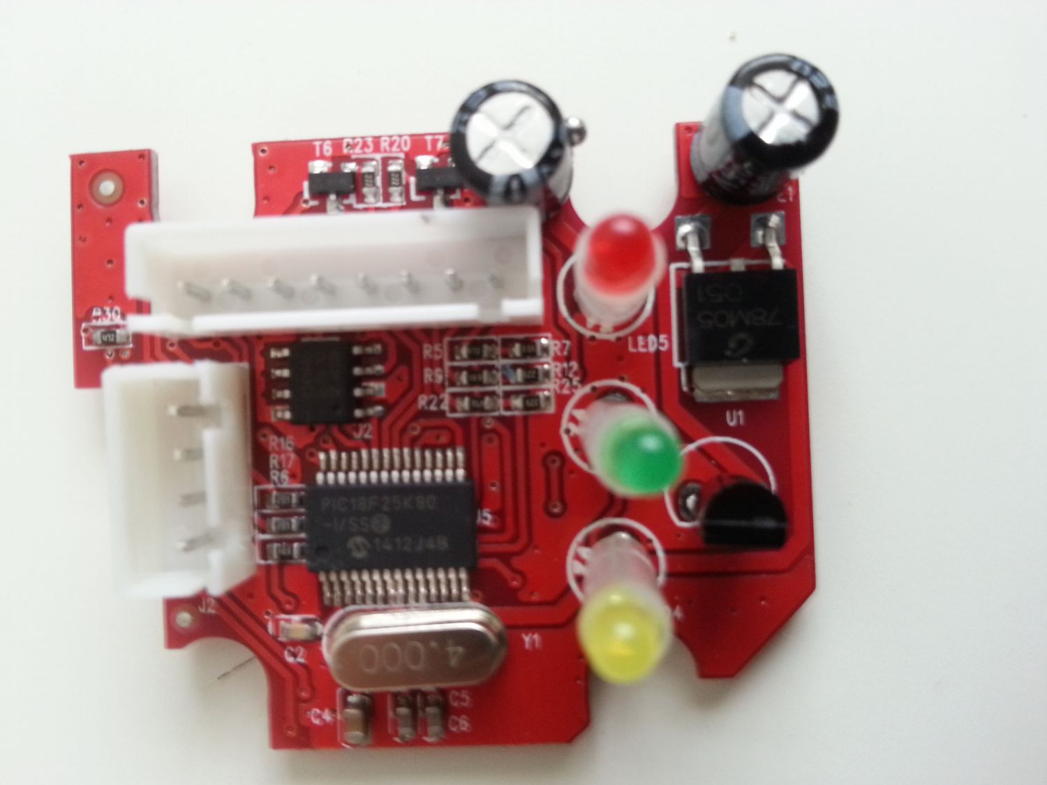

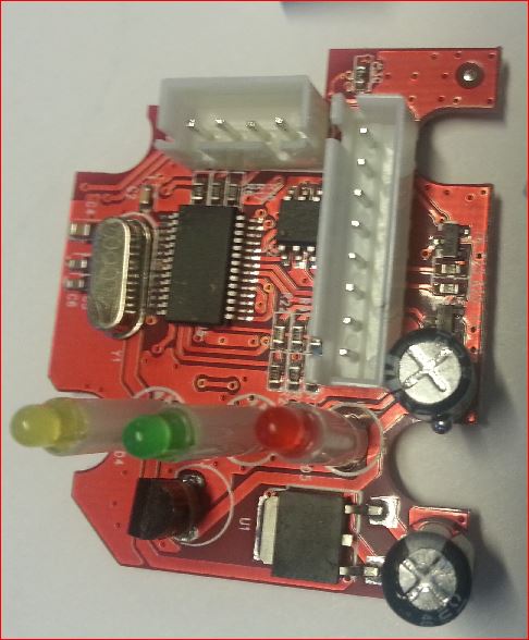

hi following my card. connectin motor no problem but doesnt connect to CAN.
What changes should I make on the card. help please. my car is fiat punto evo

You can check here what controlers need adaptor A3
http://www.multiecuscan.net/SupportedVehiclesList.aspx
Then your pics is not such a good. I cannot figure it out where is the rezistor that need to be removed.
This is for CAN Bus but as I said you will need adaptor A3 too for controlers on CAN B ( pins 1 and 9 )
Share better pics both sides of PCB first

detailed pictures
Hello Mitix
Unfortunately, your image is not very clear
But if I am right should be on the back of the bridge resistor R2.
And make time a screen from the MES Interface Test, and please put the one here
let's see if MES can work with this ELM.
Because now there are many interface that can no longer work with MES or AlfaOBD
