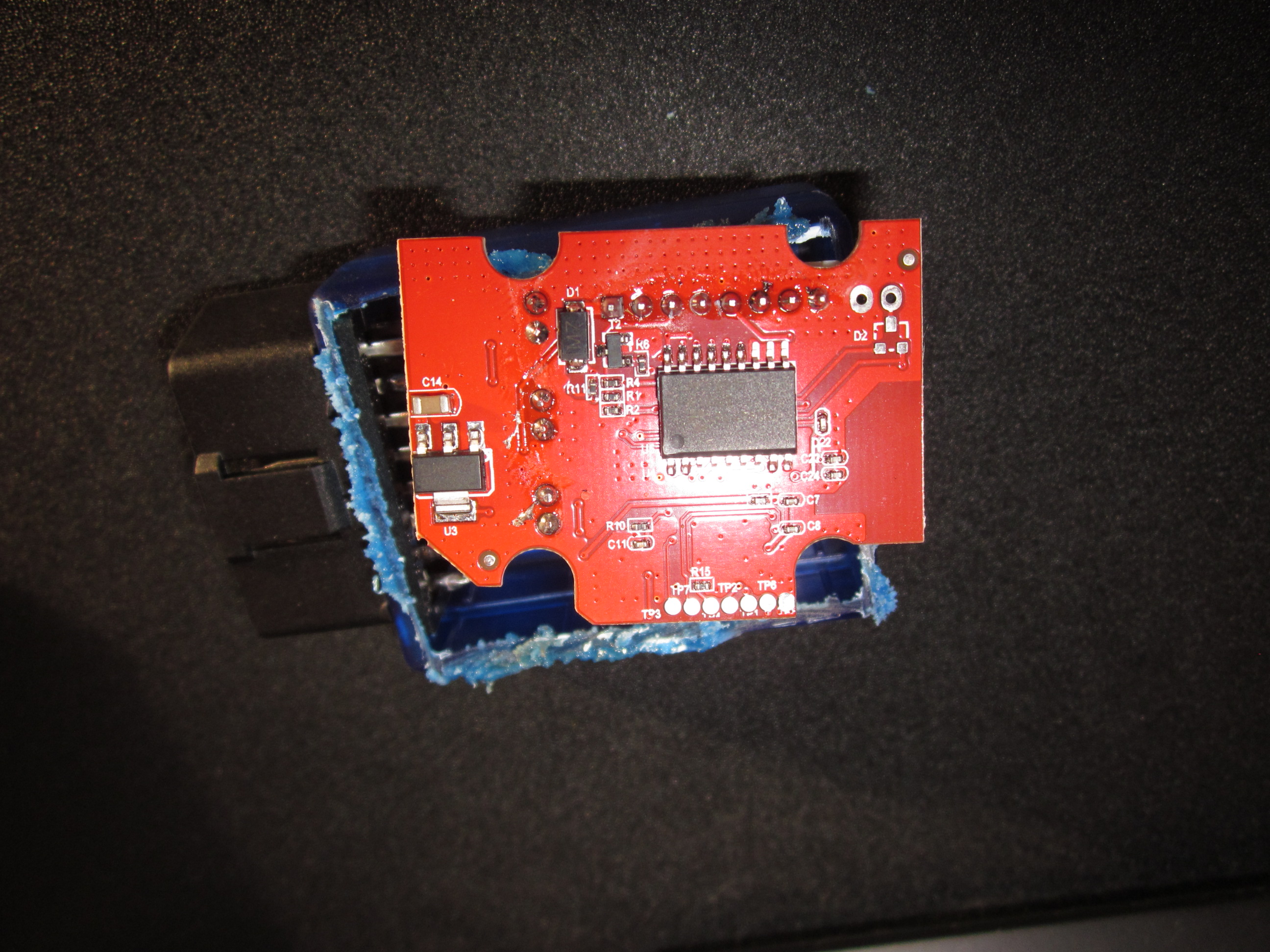

So this
is my new ELM 327 Bluetooth gadget. I was trying to connect it to an Alfa Romeo 147 2002 make. Didn't work. The module connects to the laptop via bluetooth, but I can't get Multiscan to work. I want to disable a airbag warning that went off.
I've looked up the thread and found that with this kind of wiring I won't be able to get Multiscan working on my car. So... can anyone recommend the safest cheapest way for me to get Multiscan working with my car? I'm thinking of buying a new bluetooth module, but don't know how to make sure not to make the same mistake again. I'll go cable if that's safer, since I don't want to spend a big amount of money, buying the most expensive, although safest, module out there.
PS
It's a bad photo of the wiring, because I'm pretty sure it was suggested before that one can not mod this one to get Multiscan working on Alfa 147.
Thank you for any and all help.

I bought ELM327 in a module that's in the picture in my first post. Red colored wiring.
I have no idea if it was 1.4 or 1.5, I bought it off the internet where I live from a guy who was selling it.
I downloaded the whole driver package, I didn't really get into the interface thing in the GUI (did read the user instructions though), I've just used scan for interface and it came up empty.
Since my main wish is to swicth off the air bag light, how do you reckon I do that?
With an ELM interface you can never read your airbag control unit.
It'll take you a KKL interface, switchable or with red adapter
That's what I problably need then! Any suggestion where to get one? KKL is cable, right? What are the other two? I really just want to find the simplest way to get my airbag light no to shine :)
Thank you for all your help!

Anon, I think you've bought a "Vgate Scan", and it will never work with MES, it's not an ELM interface :-(

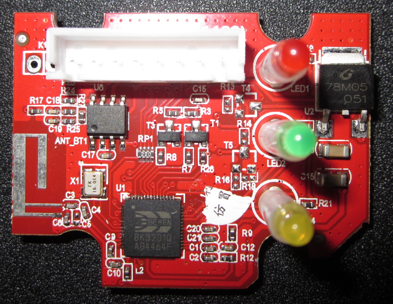

This is the thing...
Bought the cable you suggested alfaeddy :) Now I'm waiting for delivery in... 2 weeks.
Will report back when it gets here. Thank you for all the help!

hello
I've already written more times.
The white plug should be removed before making the image.
And an image or a link from the interface, so I know to what it is exactly
