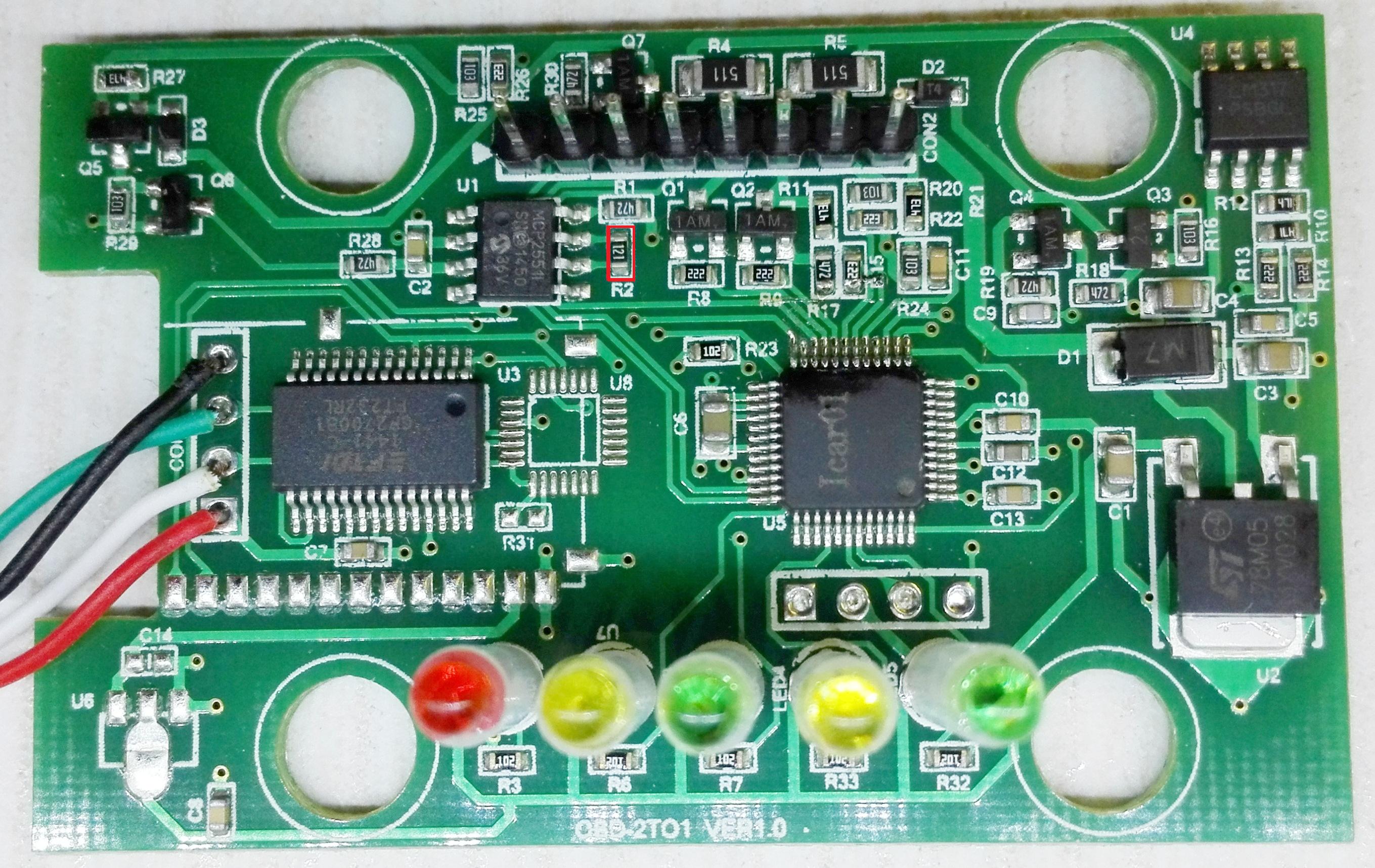

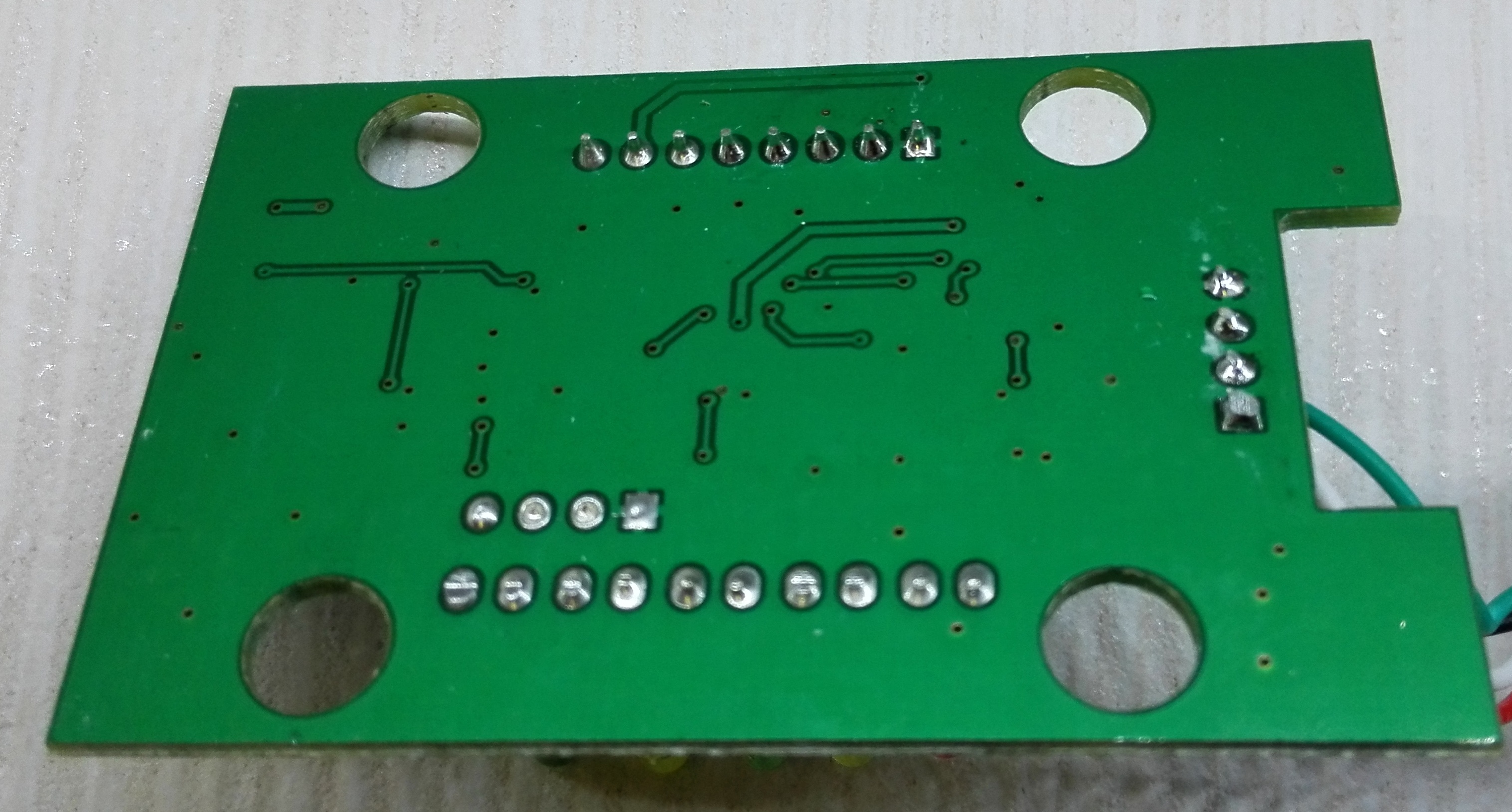

I have just recevied a new China clone ELM237 interface.
It is as usual - USB wire, black box, orange/blue label with text "ELM327 Interface - Supports all OBDII protocols"
I have purchased v1.5 but received v2.1
I believe it still can work with MES for my Grande Punto
Here some pitures of label and board inside (both sides)
is there anything I need to do to make it usable? To remove some Res, Or?
Thanks for support

Hello Bep
To which software version it really is you can see by looking
MES / Settings / Interfaces / pressing the test button
Then the true version is displayed.
Screenshot
Otherwise, remove the interface on R2 and try a Vernbindung
I've marked R2 Resistor in a red frame

Posted: 05 Jun 2015, 11:43
by BeP
Hallo Alfaeddy
I have tried to remove marked resistor, but seem that did not help.
This is the text printed out when I have pressed the Test button next to chosen interface (MES / Settings / Interfaces):

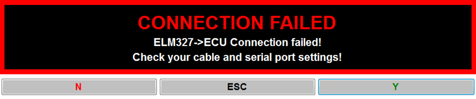

And then I tried to connect one of the module, which should be accessible by cable without yellow adapter.
this was the result:
New Picture.png (32.75 KiB) Viewed 9627 times
I have also tried to change the latency up to 188, but nothing helped
What is wrong now?
thanx again for support
