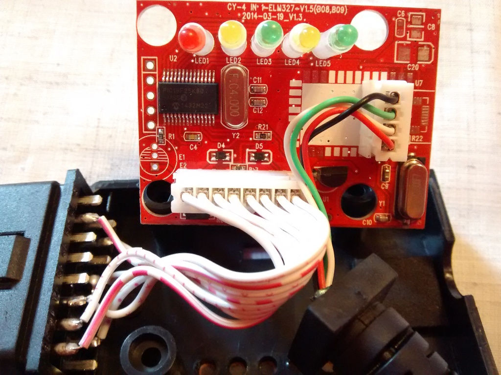

Hey, i read all the post on this topic, but no luk for me.
I have a big problem, I buy a elm327 v2.1, It connect only to engine ECU, not to other ECU.
I want to connect with the wath, to make a proxy aligment.
How I can solve?

Posted: 16 May 2015, 06:43
Hello Tavi
With Interface versions v2.1 is no connection
possible with Multiecuscan or AlfaOBD
You should buy another interface

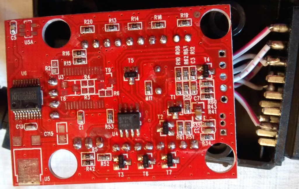

Posted: 17 May 2015, 00:25
by tavi
Posted: 17 May 2015, 07:17
Hello Tavi
Yes that is OK but that you need to then remove the bridge resistor
To read CAN bus protocols
On these two is already removed
http://www.ebay.de/itm/161642840557?_tr ... EBIDX%3AIT
or in BT Version
http://www.ebay.de/itm/151635712678?_tr ... EBIDX%3AIT
