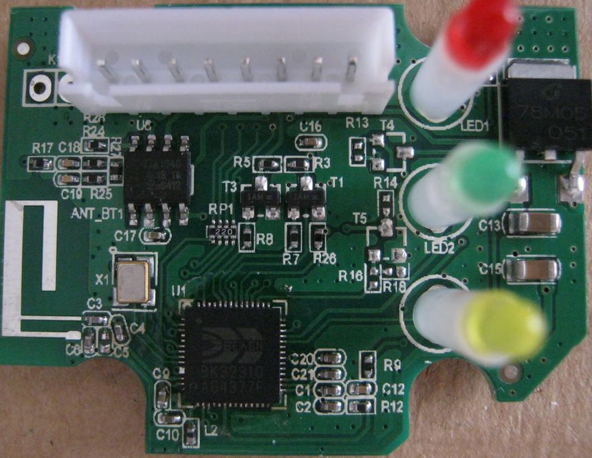

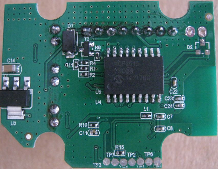

Just to enforce the murphy's law (!!!), I bought another adapter from a different vendor and with different description, but I got another scanner identical to the previous with chip BK3231Q + MCP2515 + TJA1040. From the previous change the PCB color. The older was green, this red. Also this work on my kia rio but now i cannot test on alfa 159 and multiecuscan. This weekend i will test on fiat punto jtd and on alfa 156 mjet 140cv. The board is identical to this, except for red color of pcb:
The bluetooth mac address identified is different from the older with green pcb, so is a different firmware cloned. The 2 previous, with green PCB, had both the same mac address, this with red pcb have different mac address from green.
Does anyone have an adapter like this, with the same red pcb color, and made some tests? I will test it with mes on fiat car as soon as I can!
Cxem you ever gotten a version of this card with red PCB? Change something in Firmware?
I hope sooner or later to find a damn adapter compatible with fiat ecu. Now it seems that comes only these bugged adapter with bk3231q chip.

Good an bad news! This adapter have a better cloned software and on a Fiat punto JTD is able to "connect". The problem is that if i connect torque before turn on engine on the gauge cluster all goes to zero and the diesel low level led start to blink. In addiction the engine not start! It i start the pairing after turn on engine, is still able to connect but data readed are totally wrong. For example It read as engine revs at idle of 180rpm, coolant temp of 215° Celsius, etc. Now this is probably an hw fault on the K-line, but also on this adapter the case is glued and to open It i must destroy all!!! So another adapter come back to the vendor :(
