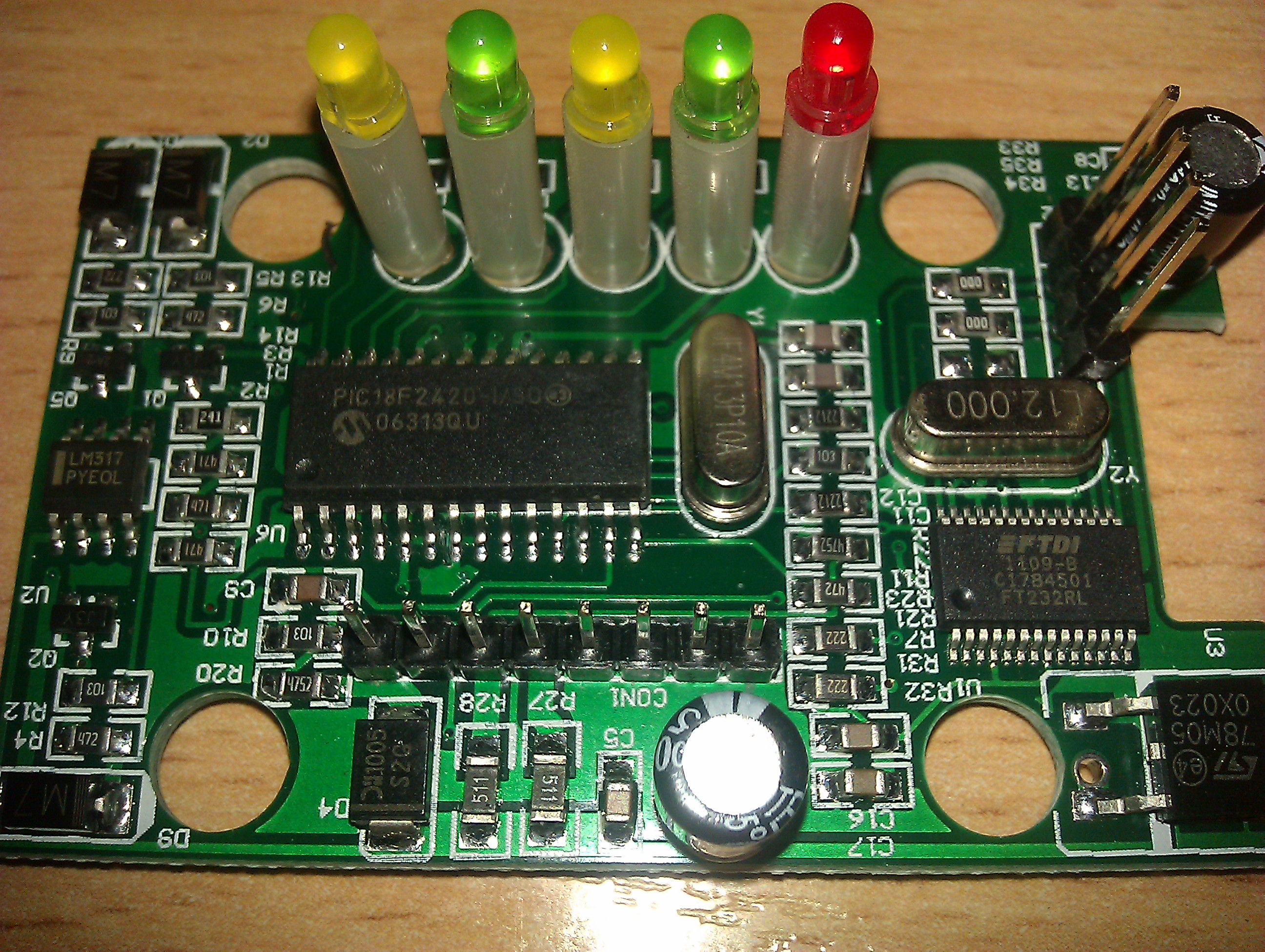

Could you ever set a picture of your board here?
Front and rear
I can send pictures but my interface has the same layout as in the post I replied to
(viewtopic.php?f=5&t=1493&sid=c9a1a9d51d ... t=10#p3808)
I have modified my interface so its 1-7-9-12 pins are shorted but before that it was also not working.
If your layout is the same, then it must also work!
I think it is a setting error!
Probably the FTDI driver is missing for the interface
If your ELM interface correctly identified in the Control Panel?
and set the correct com port?

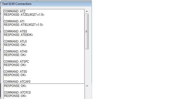

I also thought of this picture FES / setting / interface / test
which is an interface with the resistor R04

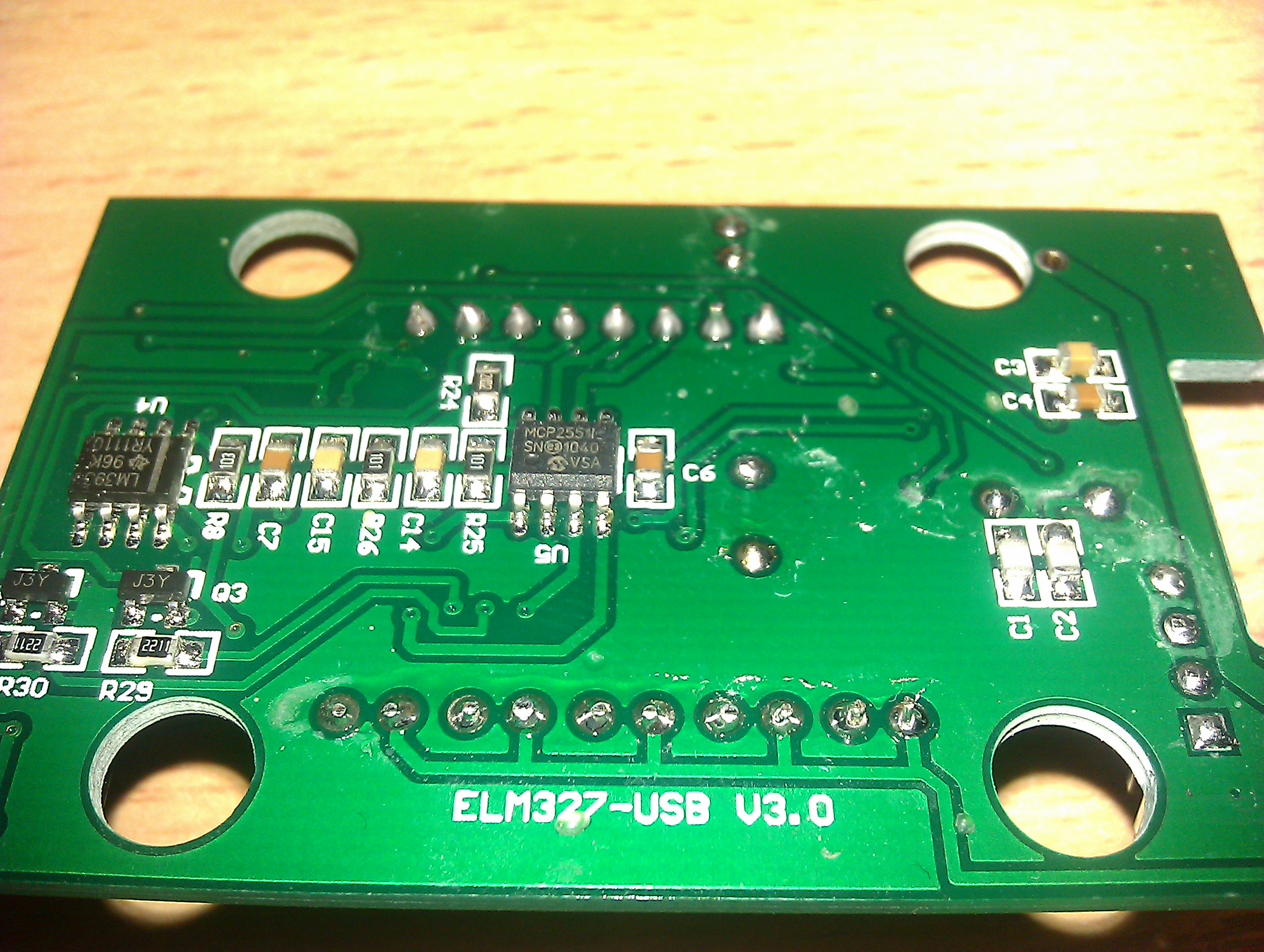

I can connect successfully with ECU and ABS, so, the driver is there and works fine, interface is identified and it is communicating over COM port. But I'm not able to access any of CAN modules. Scanning identifies only ECU and ABS. I have attached photos of my board.
I'm placing also again of interface test, that shows that there is communication with the interface:
Scanning ...
ELM 327 interface found at port COM2, speed 38400bps
This interface is compatible with ELM 327 1.3! Should connect properly with all CAN modules.
Latency Too High!!!Code: Select all
RESPONSE: ATZ
ELM327 v1.4a
ELM327 v1.4a
RESPONSE:
ERR94
- IMAG0189.jpg (1.08 MiB) Viewed 10270 times
- IMAG0186.jpg (1.31 MiB) Viewed 10270 times
@ pls
Very strange, in your board should be ok CAN connection
But after you have an error in TEST
Comand ATBI = ERR94
Unfortunately I can not tell you why this error occurs
Such an error I do not know.?
And I've had some interface
I suspect that your interface when resoldering broke ?
Really such a mistake I have not seen yet.

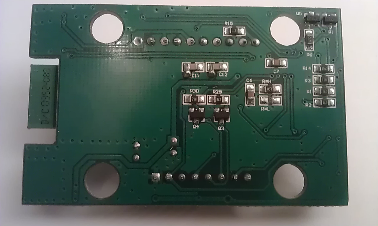

I recently purchased a cheap Ebay version of the ELM 327 interface. Like others who have reported earlier, I could see the ECU data for my 2007 Alfa Spider 2.2 JTS and it passed the test routine, but I could not access any CAN information. My circuit board is very similar to the picture posted by ruda30 near the bottom of page 13.
I removed the resistor labeled as R14 and now it works as I hoped.
By the way, this resister is on the "bottom" side, opposite from the LEDs. The label is printed in such a way that it might actually be RI 4 (R-"letter eye"-space-four) or R=Fourteen or even R-One-space-Four. In any case, removing it makes the CAN data available.

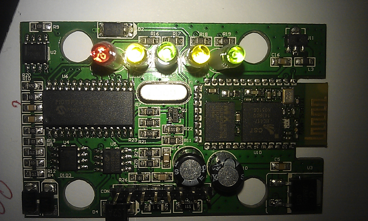

I am new here, and i never used this software. Before FES i use ,,TORQUE,, on android phone, but this is much better. But i have problem with the connection....
I can't connect my ELM327 Bluetooth adapter with the software on Fiat Bravo 2008 t-jet. I don't know am i doing something wrong or i need to remove some resistor (if so plese tell me which one). I am on Win 7 64bit. THANKS
