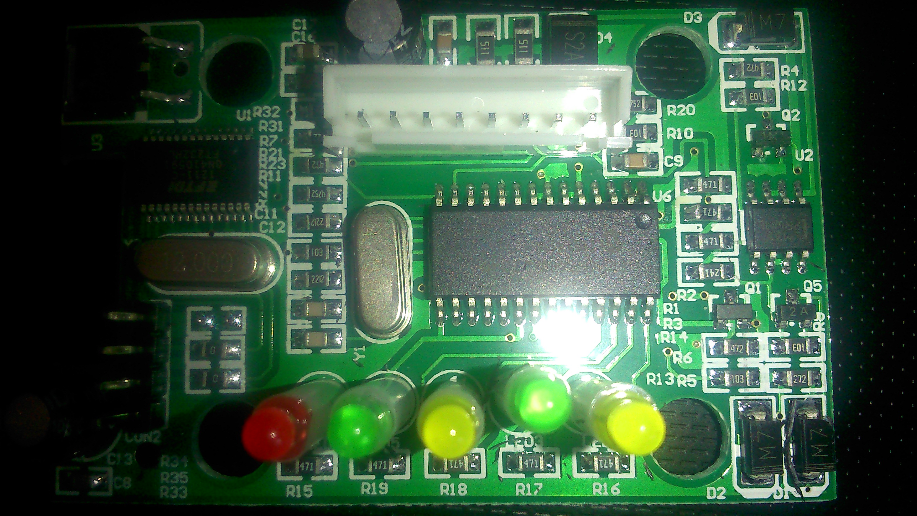

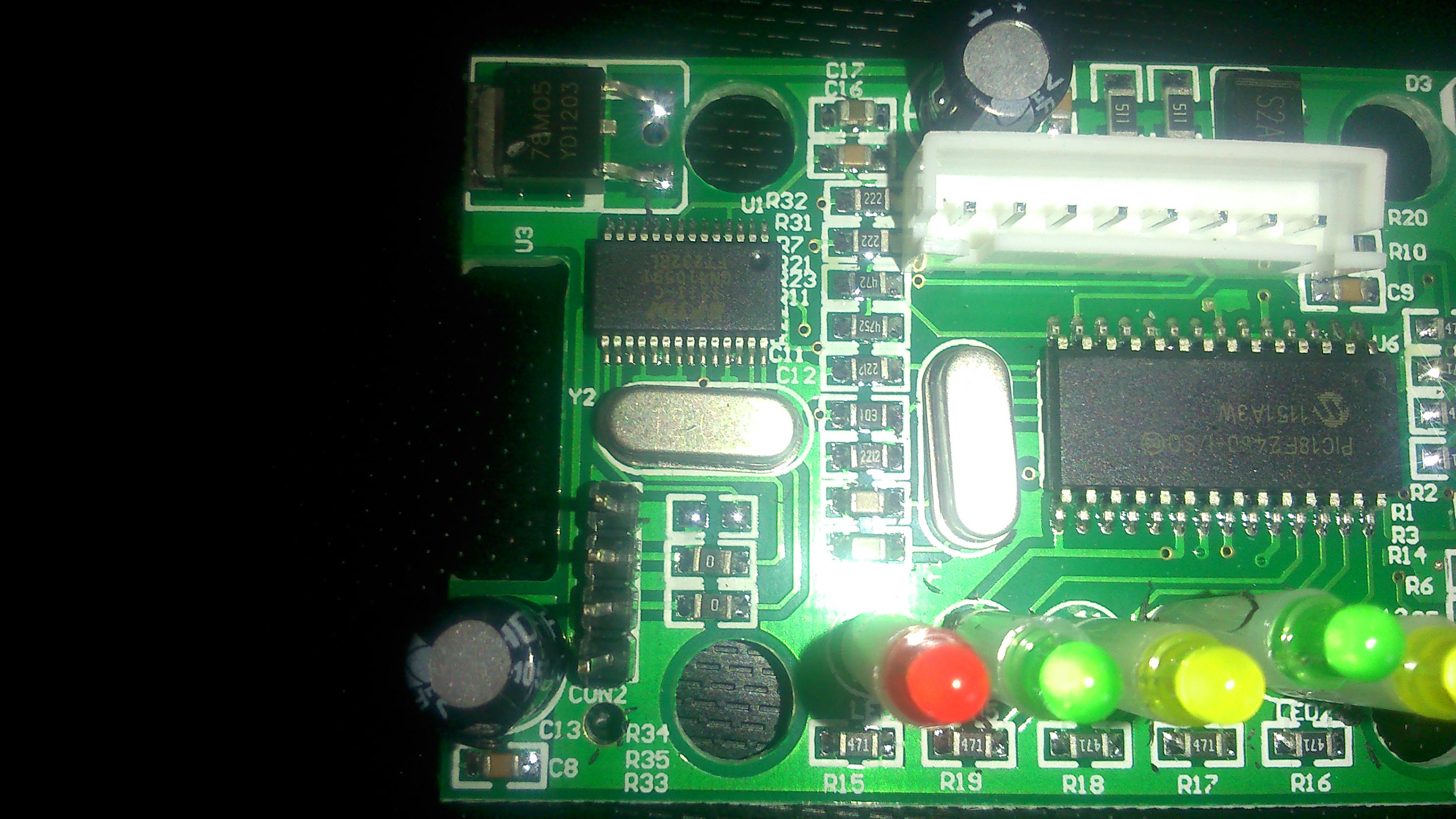

above are the pics of it please could anyone ring or tell me what I need to do or what to remove thanks lee

To be able to read at your Fiat 500, the airbag control unit
You will need the yellow adapter (A3) as the CAN bus must be transferred.

hello eddy yeah i am using the yellow adapter but its not allowing me to connect to the airbag or dash modules

The photos no CAN.

Think it out closely, you can connect to MotorECU and ABS without adapter manufacture
But with the yellow adapter you get created a connection !!!
So I guess the first one error in the adapter plug !!
question:
Can you handle the yellow adapter to connect other controllers ??
Do you have the registered version of Multiecuscan?

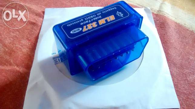

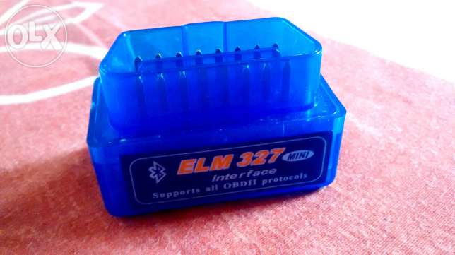

I would like to ask your help; I bought a "little blue" bluetooth ELM327 mini interface; I tried to connect to my FIAT STILO 1.6 (2002, 5 doors) and the next happened:
- connected the ELM to car - ok
- connect with laptop to ELM via BT (MES) - ok
- try to connect to ECU: !PROBLEM! Indicated a lot of fault code, dashboard got black and computer said: LOOSE CONNECTION... after this nothing happened, I could not close the doors with the remote and I have car securiry failure etc... everything goes wriong... :( After this only the ECU reset helped... (accu contact remove)... It happened again when I tried (and the ame with Torque with my phone). The ELM327 is this:
Do you have any idea: is the resistor removing can help?
