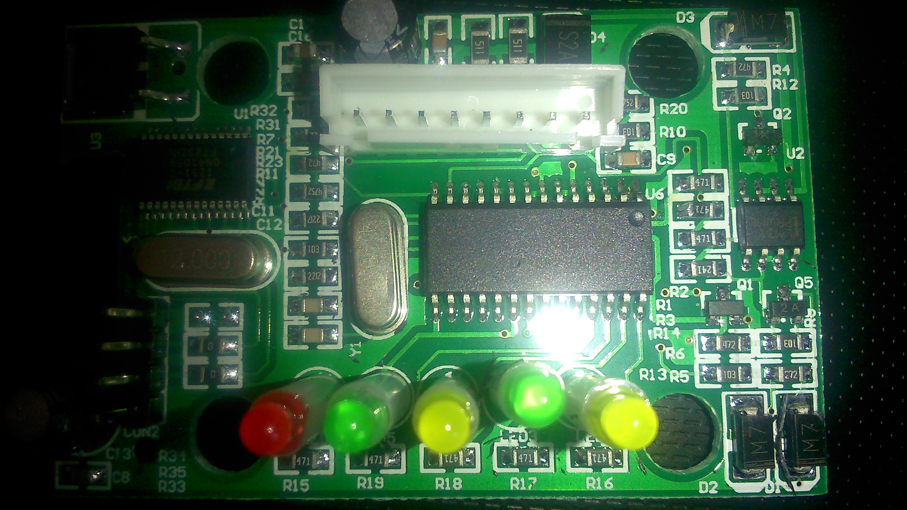

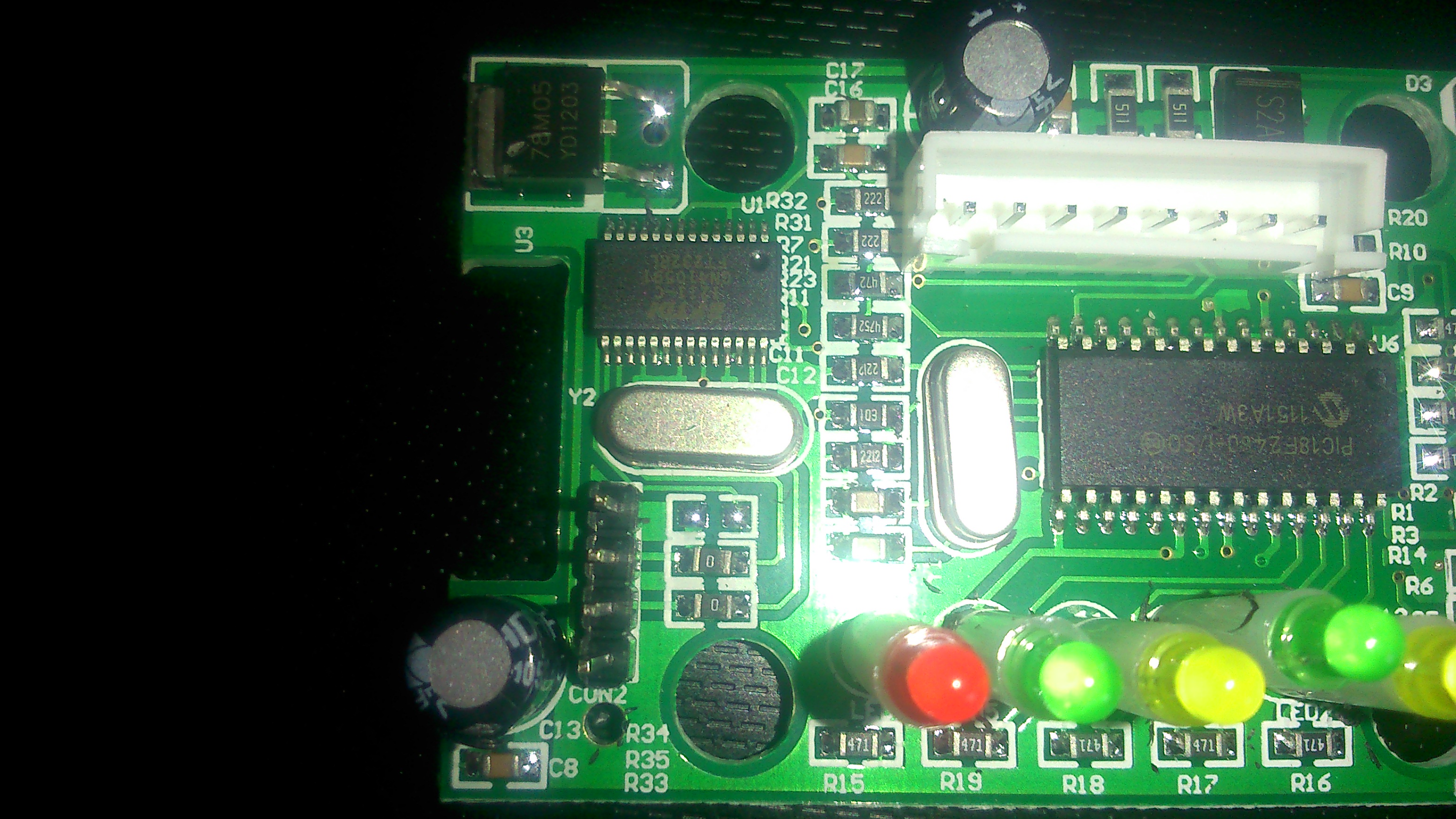

above are the pics of it please could anyone ring or tell me what I need to do or what to remove thanks lee

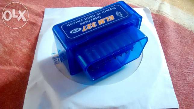

I bought an ELM Bluetooth interface and I can't seem to get it to work. I get the CONNECTION TIMEOUT message when I try to connect to engine ECU. If I test the interface with MES I get the following response:
RESPONSE:
ELM327 v2.1
ELM327 v2.1
RESPONSE: ?
RESPONSE: ?
RESPONSE: ?
During engine interogation, the yellow led on the interface blinks. I activated High latency mode. I selected the correct IO Port from Device Manager. I read here that I need to install the ftdi drivers. I don't understand why, I don't even know if I have a ftdi chip inside.
Please some help.

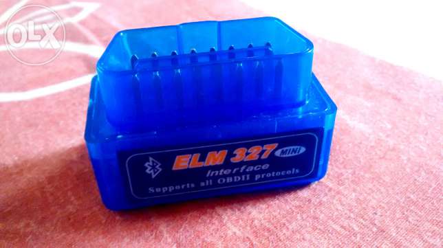

I would like to ask your help; I bought a "little blue" bluetooth ELM327 mini interface; I tried to connect to my FIAT STILO 1.6 (2002, 5 doors) and the next happened:
- connected the ELM to car - ok
- connect with laptop to ELM via BT (MES) - ok
- try to connect to ECU: !PROBLEM! Indicated a lot of fault code, dashboard got black and computer said: LOOSE CONNECTION... after this nothing happened, I could not close the doors with the remote and I have car securiry failure etc... everything goes wriong...
After this only the ECU reset helped... (accu contact remove)... It happened again when I tried (and the ame with Torque with my phone). The ELM327 is this:
Do you have any idea: is the resistor removing can help?
Thanks,
Norbert
