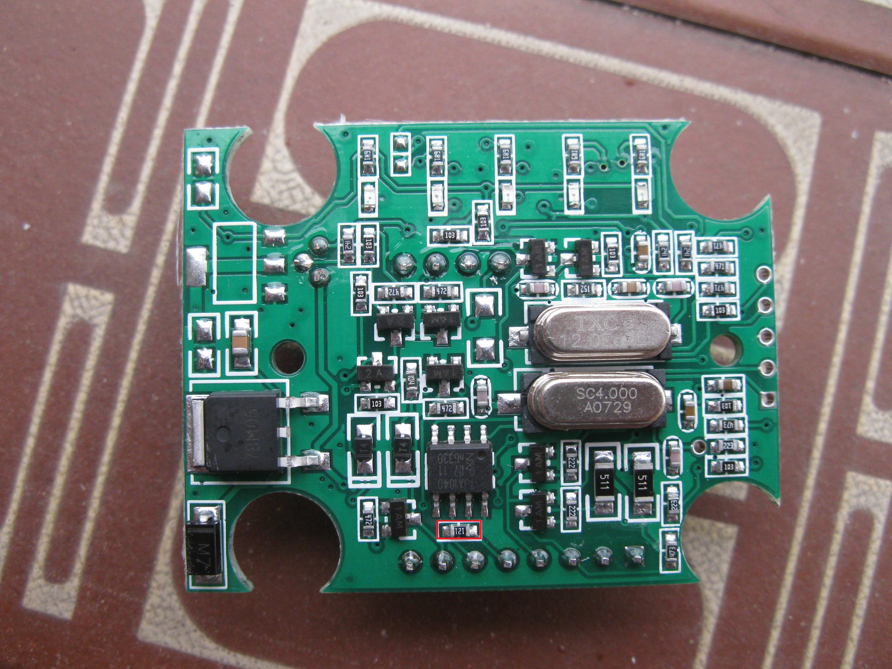

i have TJA 1040 chip
Posted: 06 Feb 2015, 11:48
Hello Tasmo
Remove the Resistor in the red Frame
and you can read the CAN Bus Protokoll
of your Car
IMG_0591 markiert.jpg (806.35 KiB) Viewed 7522 times
Posted: 06 Feb 2015, 12:59
by tasmo
Thanks Eddy,i removed resistor and now it work, only electric servo ecu cant connect(not found).it look like its problem with servo ecu because servo not working

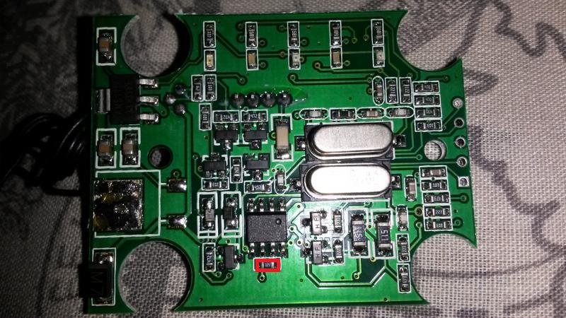

Have a similar elm cable as the one posted previously.. slight changes. have the same issue, cant connet to can modules on alfa 147 selespeed 2001 model. Do i remove the resistor as posted ain response above.
Much appreciated. thanks, cheers
Posted: 07 Feb 2015, 22:07
Hello MF07
Your Image ist very small
I can not read the numbers of Chip
I think you remove the Resistor in the red Frame
than you can read the CAN Bus Protokoll with your Alfa 147
