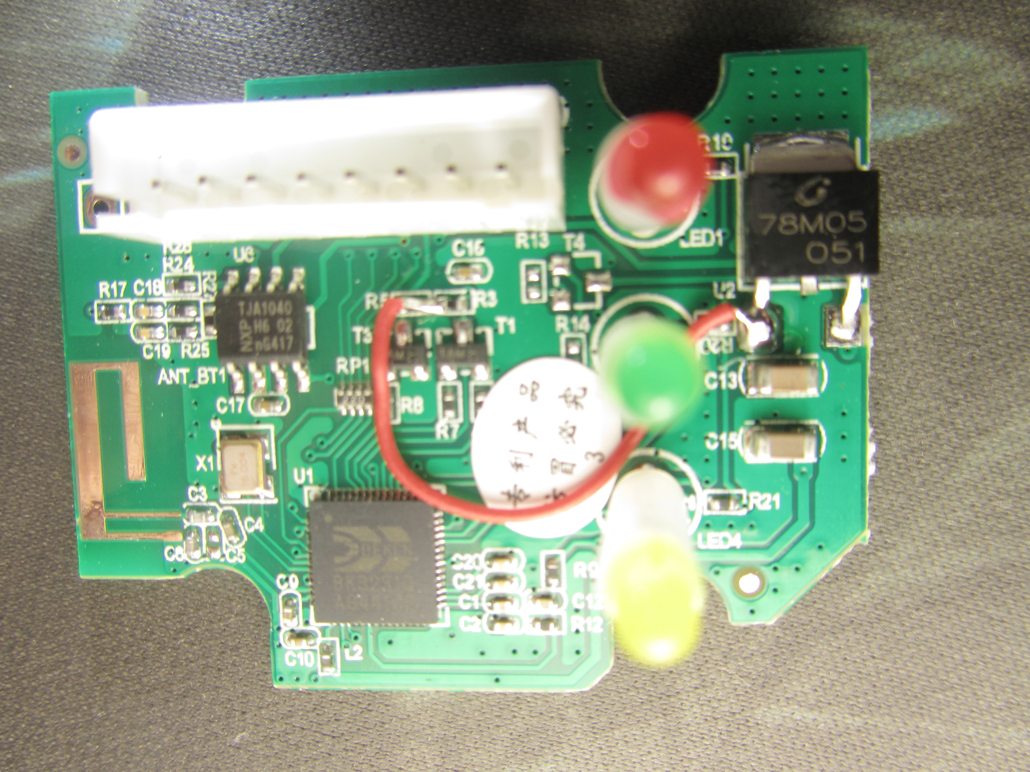

I'm new to this forum but i have the same problem as some here.
The elm327 is the same as blkid and it connects to the pc and phone just fine but not to the ECU, it says it's unable to detect the protocol.
The only thing different is a wire connecting both r5 and r3 to U2.
The car it's a 2003 Nissan Almera.
Can someone please guive any advice?

Posted: 05 Feb 2015, 23:09
Hello Tasmo
Your pictures are not good because you can not read components
Search the MCP2551 chip or TJA 1040 and make the environment
a better picture
The driver you get here
use the 2.10.00
Or this for silicone Labs USB ports as Walter already wrote
http://www.silabs.com/products/mcu/Page ... ivers.aspx
Posted: 05 Feb 2015, 23:14
Hello Gaspoia
This is about Italian cars and Multiecuscan
With this software you can not read on your Nissan
Therefore, no patina must be changed.
Use a software package for Nissan
