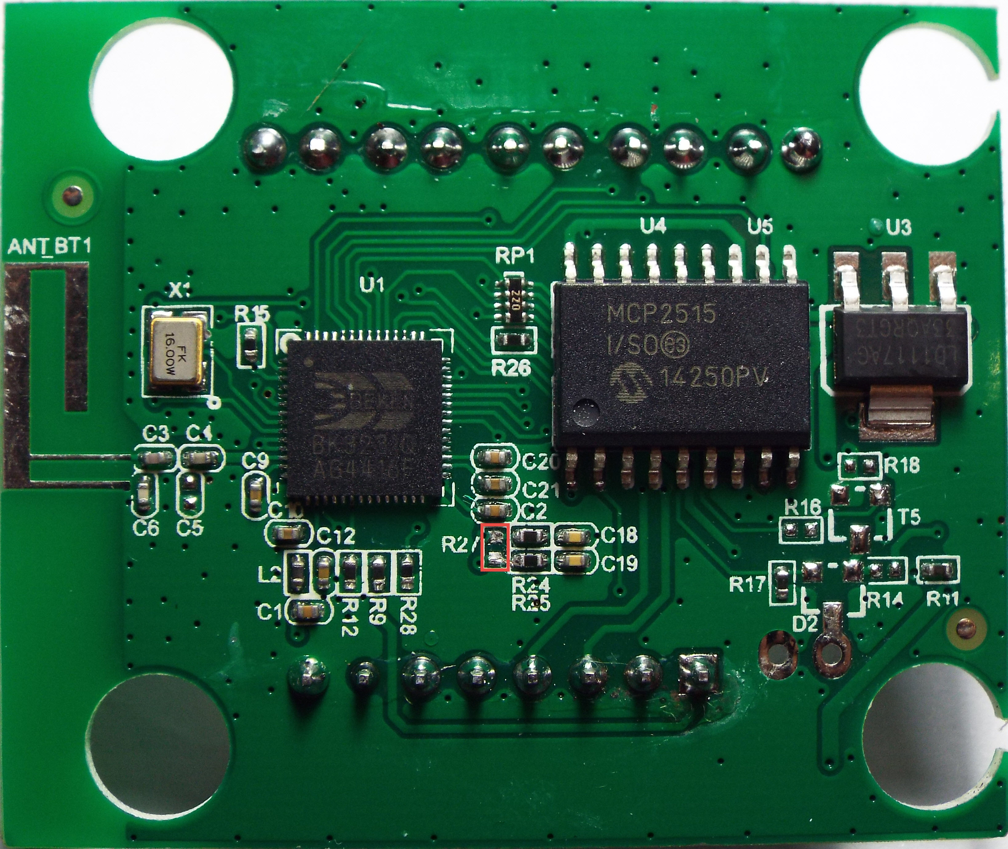

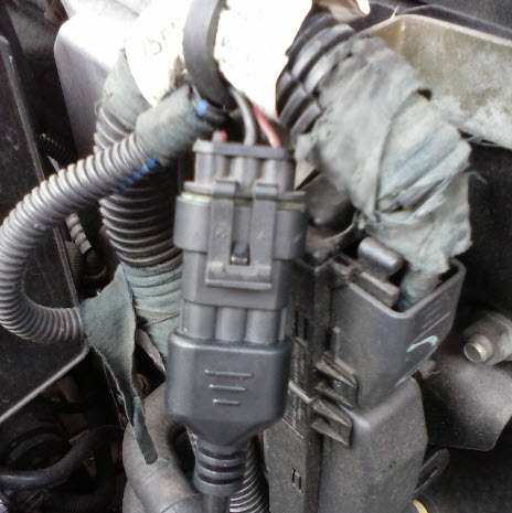

I am trying to connect to Palio 2004 Gasoline with IAW 4SF-PC injection module (Engine) using 3 pin connector and ELM 327 Bluetooth.
The system turned down to comunicate wit the Engine module even the connection test reported comunication Ok (with some error).
MY interface is this mentioned below:
As you can see, I removed the resistor r27 used to terminate the can bus line as recomended.
Below the comunication picture (see some AT commands with problems)
RESPONSE: ?
RESPONSE: ?
RESPONSE: ?
Some pictures about the 3 pin connector:
3 pin connector.jpg (48.41 KiB) Viewed 9525 times
Even doing this I am facing problems to connect to ECU.
Thanks for the good job for helping people.
